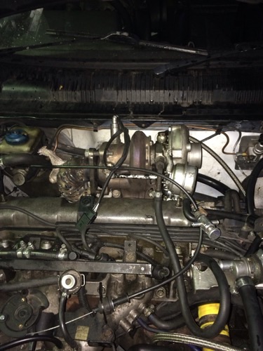

New turbo fitted, at last. Needs a little re routing of the water pipes and oil pipes.fitting the induction tomorrow..... Yes the bonnet does get a little tepid ????
Steve
Giving loads of boost. I made a manifold for a Nissan 200sx turbo, tried loads of places, but this works best. Gives a straight ish down pipe and clears everything. It's 40 mm from the the bonnet. 1.3 boost to 6500. The lag is about the same as the original standard set up. The torque is astounding, 30-80 is perfect. Just need inter cooler pipes with flares as they have popped off a couple of times. How's your turbo going ?

Im surprised it doesnt melt the windscreen nevermind the scuttle panel being so high up :lol:

My head gasket went just at the start of the slippy season and while it was stripped down I thought mmm a modern turbo lol. I was shocked by the price of turbo manifolds though so I adapted one, and as a plus point I got a heated windscreen . Ive been using a ford ranger heated seat and proper working wipers lol. Can't wait to be using the 205 everyday.
Slo
Id have a serious think about getting some sort of heat shield over that if only to stop it scorching the bonnet paintwork, its silly close to the brake pipes as well :excl:
Steve
All sorted Andy, the turbo jacket will be fitted tomorrow all the manifold and down pipe are wrapped. Collecting my silver flexi heat wrap from demon motorsport to cover any remaining pipes etc. The photo was taken just after the first test, you can see the turbo ecu waste gate controller is not fully connected, as I set it using a pressure pump and gauge on the waste gate actuator. won't be cooking my rack or gear linkages any more
