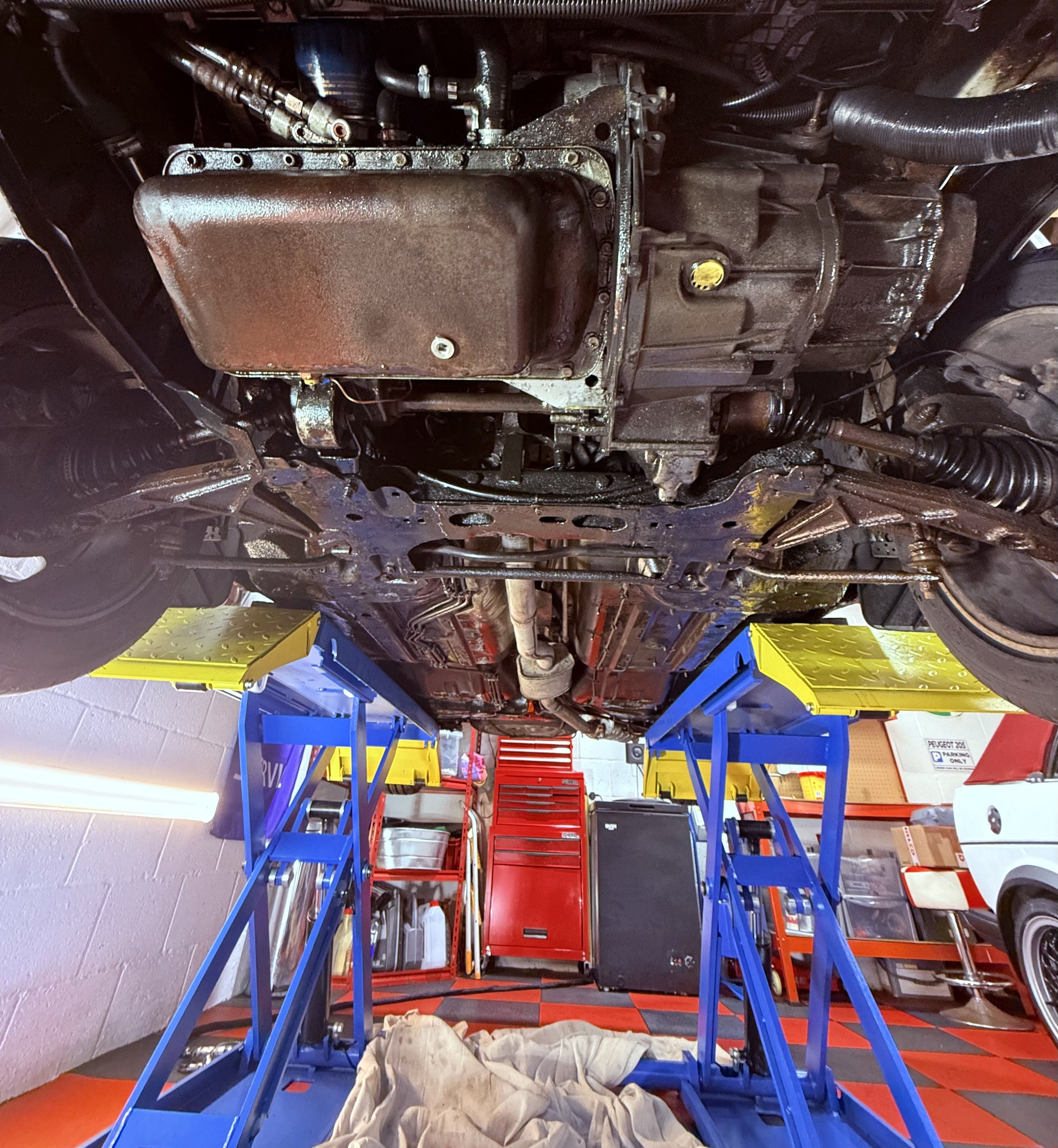

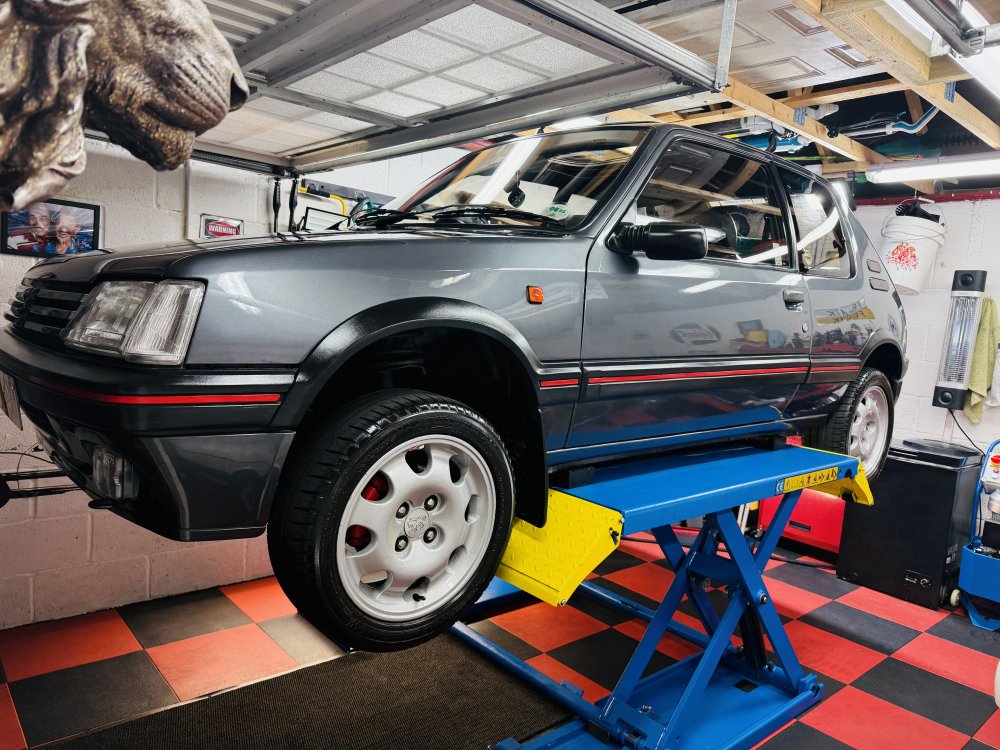

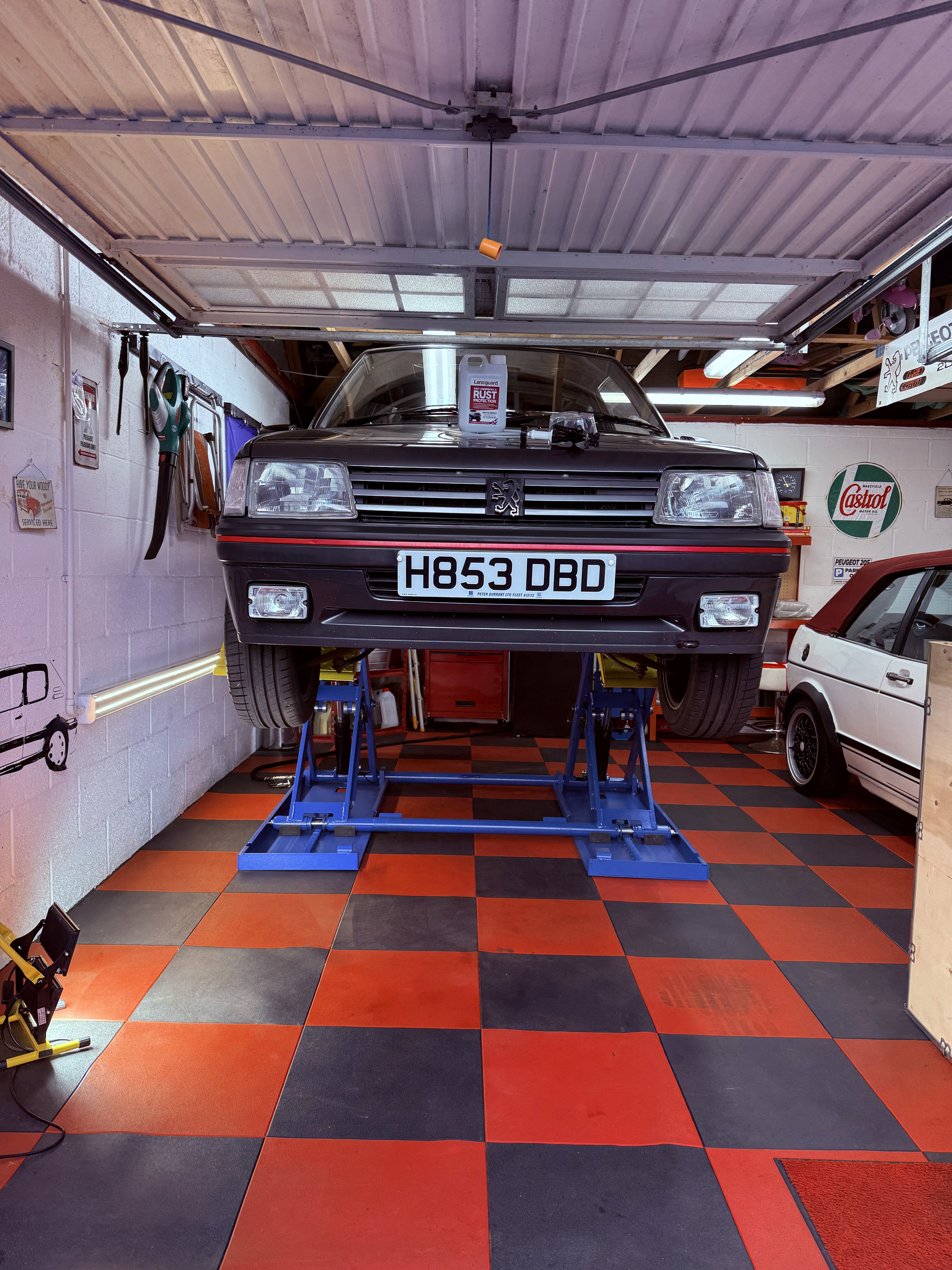

So the Pug has been on daily duties rain or shine since 1st Aug and has done great apart from a soggy rear footwell and some rainwater in the boot!
Fitted a new door seal, boot seal and rear quarter window seals from youngtimers so let’s see if that cures it!
also got it up on my new ramps, and treated all the underside with Lanoguard. Not looking bad underneath for a 192k mile car!
Leslie green
Looking great ,those ramps are excellent for working underneath and don't take up much room, they are on my wish list :D The golf looks nice too
Edited by Leslie green
ATK
Cheers leslie, yeah the ramps are really great, should have got them years ago!
