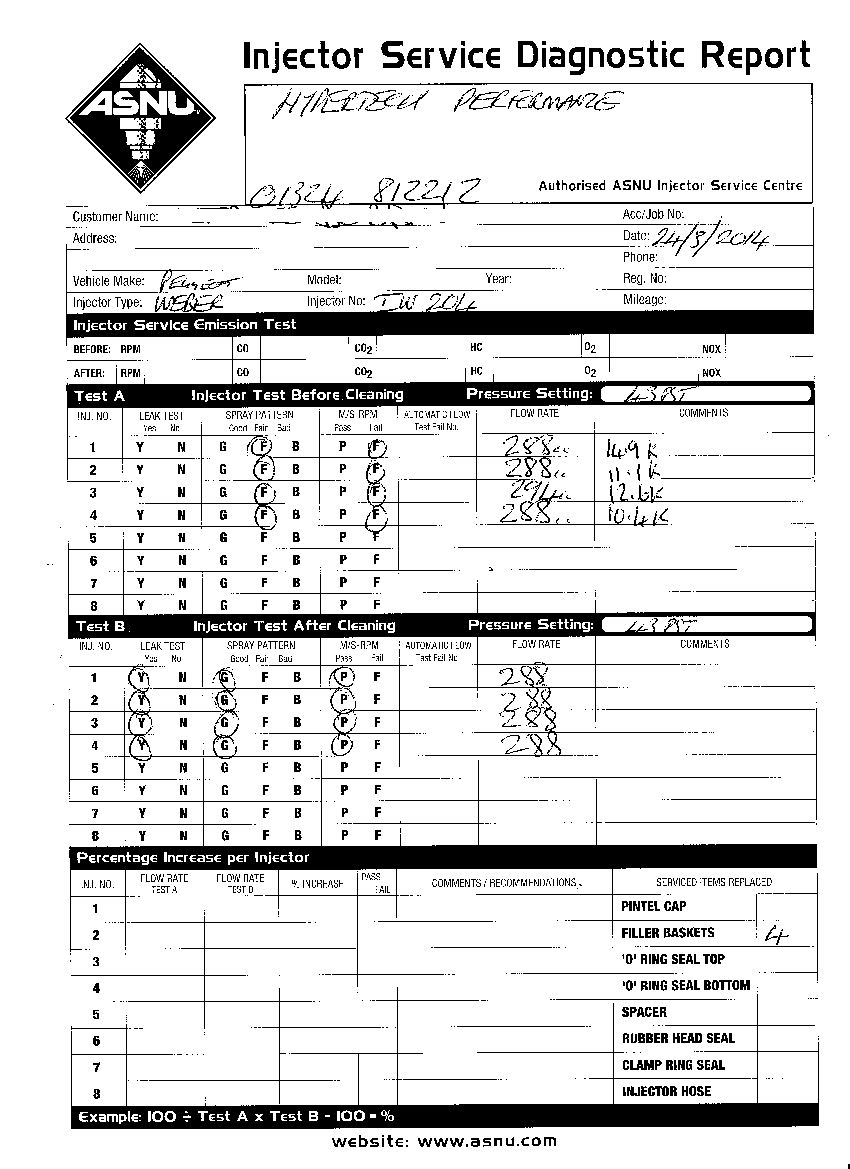

Got the injectors back this morning and have spoken to the guy. I was concerned about the impedance values as they are wildly different to the Autodata data of 14-18 Ohms. The guy said they are dynamic resistances that were measured as the machine was running.... and if i measure them now they will correspond to the Autodata readings.
Anyway, he said they weren't too bad before cleaning, although a fair bit of silicon was present, this comes from petrol. Told me to add an additive to my tank and to do it every 6 months or so.
Not much of a test report but here it is if anyone's interested.
