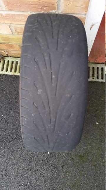

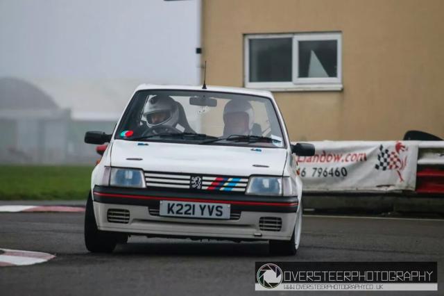

Went on a last minute track day at Llandow yesterday to give the new suspension a try. Luckily the weather dried up nicely so after a damp morning the sun came out in the afternoon. It was also quite quiet there with only 25 cars there so managed to get a lot of track time without queuing up, did over 100 track miles!
The new suspension was a great improvement, much less roll and under steer, and the lift off oversteer was very controllable and a lot of fun! Not much tread left on the tyres now!

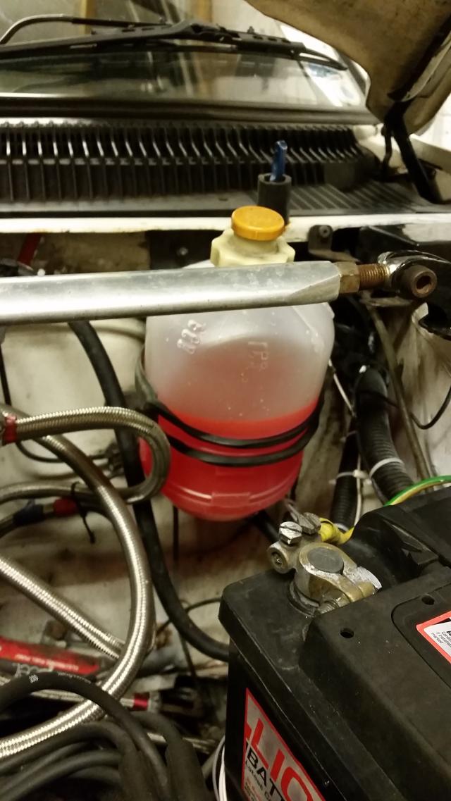

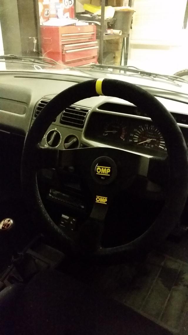

Over the Christmas break and the few weekends after, I have given the car a little bit of a freshen up. It's had a mini service, a new nissens radiator, thermostat, header tank and fresh new coolant. Also fitted a new omp wrc wheel which feels lovely!

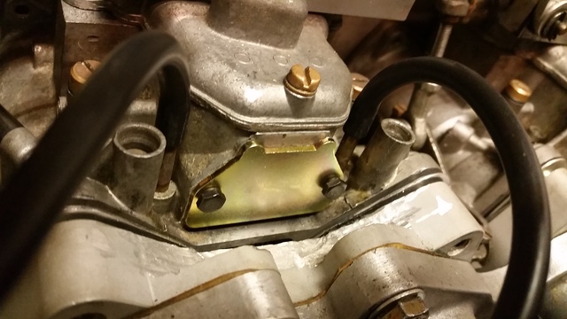

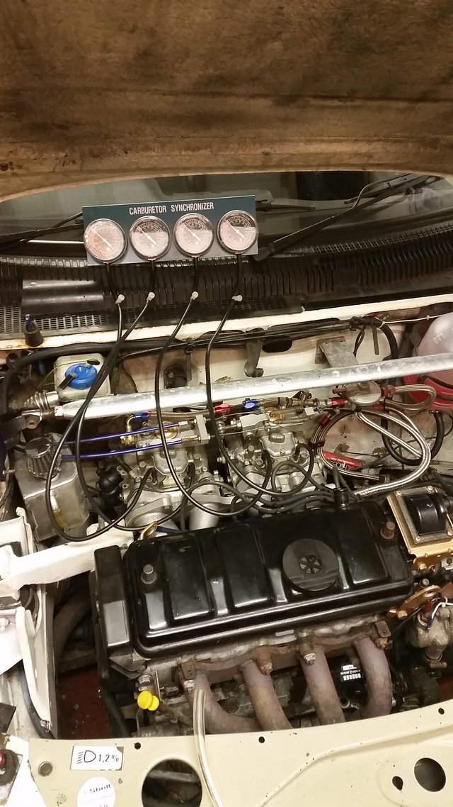

Had a bit of a breakthrough in the garage this week! Decided to give the carbs a service with all new gaskets and a thorough clean to see if it would sort out the balancing issue. I have always had trouble balancing them perfectly and thought that my rough running at idle was down to this.
After putting everything back together and checking the balance with 4 vacuum gauges there was something still not right. I then spotted a small fuel leak from the cold starting device, and on further inspection with a piece of pipe in my ear, that it was also sucking in air. It seems as though the cold start device will not return fully, causing a big vacuum leak and also causing it to run really rich. I took the device off as I never use it, ensured that the valves were fully closed and it now runs much better!
Looking on the net it seems like this is a well-known problem so blanking plates were quickly purchased. These were fitted last night ready for a balancing session this afternoon! I’m hoping that this fix will also bring the emissions down too!

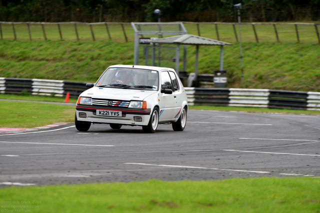

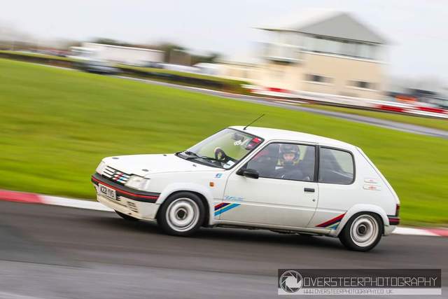

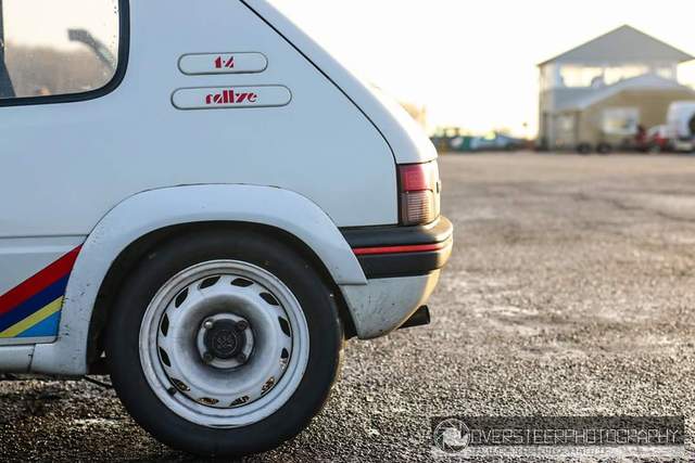

Another great sunny day at Llandow last week. The car is so much more fun to drive now with the new suspension and rear beam.
Also fitted a rev limiter which is built into the rotor arm. Good job really as it has shown me just how bad the rev counter is, over 1500rpm out!

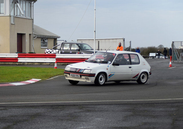

Another great day at Llandow on the weekend, car didn't miss a beat again!
DCC's 205 also looked to be going very well and sounded great!

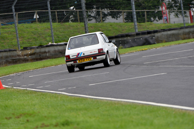

Another trackday at Castle combe last week. Only the second time I've been there and the car performed brilliant again. It still surprises me what this car can keep up with, goes very well for a 1.4!
I was hitting the limiter in 5th just before Avon rise so I will have to try and calculate what speed that is.

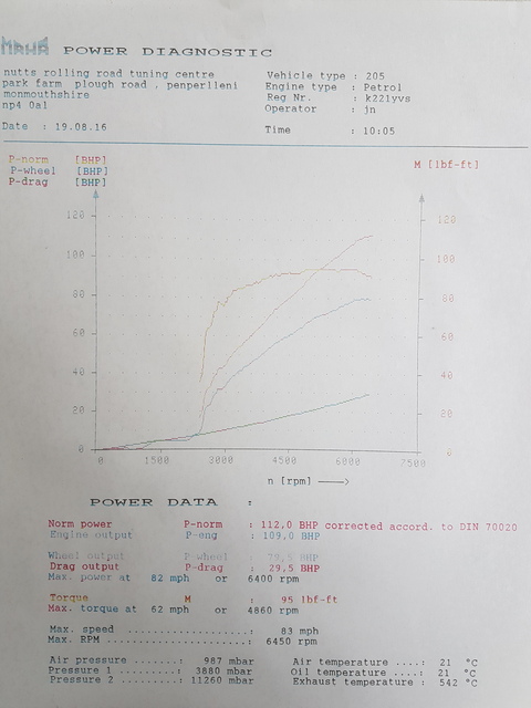

I took the car to a local rolling road the other day, the main aim of the visit was to check the balance of the carbs, get it to idle a bit better and do a power run to check the fuelling over the full rev range.
The car only needed a few minor adjustments to the balance and 1 carb needed a bit more fuel at idle. The power run also went well and it made a very nice curve, running a little rich throughout. Headline figure was 112bhp which is good for a standard tu24 head and cam.
The only thing it could benefit from now is to raise the rev limit as it cut in just after it made peak power. It has a standard limiter built into the rotor arm at the minute which is supposed to limit it to 7100rpm, not the 6500rpm it cuts in at! I'm planning on removing this and fitting a Omex electronic limiter or similar to sort this out.
The car idles much better now and is much smoother/easier to drive on part throttle/pulling away. Good morning all round!
