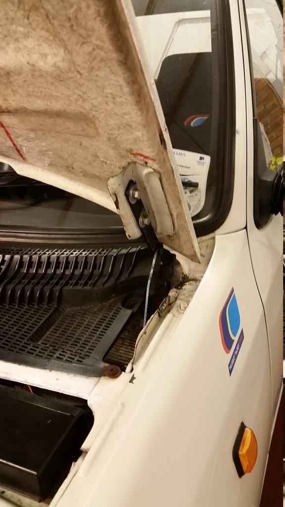

I have put some hinges on my fibreglass bonnet as taking it off all the time was getting a bit of a pain, thanks to nick205 for some of his bonnet! I ended up bonding on a lot less than I thought I would as it didn't quite match up. Should be ok as they are not holding a lot of weight.

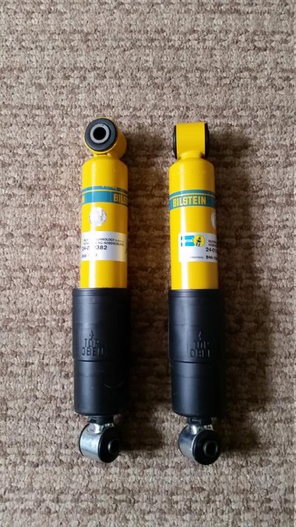

I have also just bought some new rear bilstein group n dampers and a gti rear beam to go with them will be on its way soon too :)!

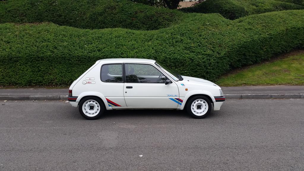

Took it out for another spin earlier and I'm over the moon with it! Money well spent!
Might be a tad low at the back but I can live with that.

Looks perfect to me from that picture. Glad you are pleased with it despite Paisley bloody Freight doing their best (worst?!) to lose it!
Oversteer wise, going from base model rear bars to GTI, plus whatever dampers to the Bilsteins will have stiffened the rear suspension considerably, so this will have caused the change in dynamics. Also the rear geometry of gti stuff is again slightly different to the base model.
