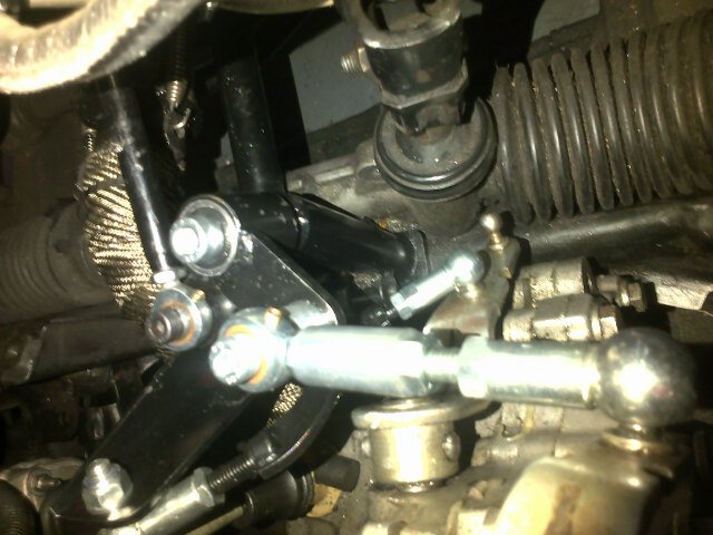

Fitting The Satchshift Today :)
try mounting the ball pivot on the rear instead of the front of the side to side lever on the main rod.
this one :)

Tried spacing it up 5mm and 10mm and that made no difference. So shortened the straight rod as much as I could which allows it to go into 2nd, 4th and reverse but the bell crank does touch the upright bit of the long bottom rod when you shift into first.

Hi, yes I did get it to work 90% of the time, but it took an age of trying to adjust every dimension and it still jumps out of 4th gear, reverse is very hard to engage, the linkages clash and there is an excess amount of slack in the side to side movement of the gear stick as the "S" shaped linkage is effectively too short. It is a real shame as it is a lovely piece of kit and it would only need a tiny amount of work to get it working perfectly. Unfortunately I haven't got the skills to fabricate the bits that would solve the problems.
The hole you need to cut in the bulkhead is tiny and it would be hard for anyone to argue that the hole wasn't original. I'd definitely not recommend trying to fit it with the engine and box/exhaust etc in place.
In summary if you are prepared to re engineer the linkages to fit your car I'd give it a go.

Modified s shaped linkage and spacer plus rose joint received on Saturday, fitted yesterday and adjusted adjusted adjusted today. Now works perfectly :)

Sorry for the delay and quality of the picture taken with my phone. It really works perfectly now :) :)
