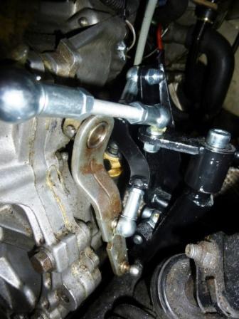

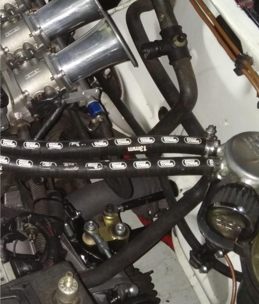

Still not managed to drive it yet, but reverse gear selection is definitely going to be a challenge and the first and second change doesn't feel too positive, but it goes into third fine! Some not very good photos to follow
205Rallee
Another photo

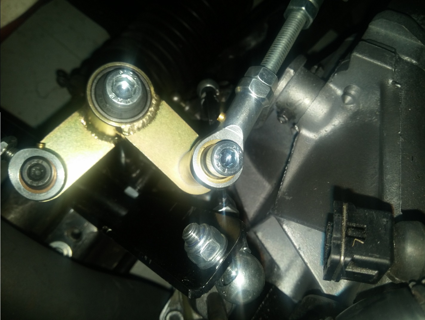

205Rallee

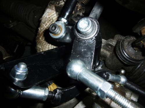

and another
A1AXX
and another
You are having the same problems I have had. the bell crank can be spaced up by about 8-10mm , that's my advice not from Satchel. Mine is now working incredibly well and I am happy with it.
