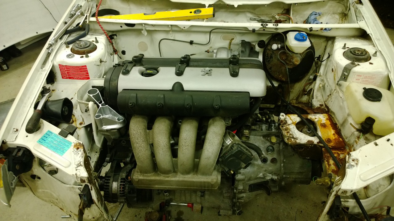

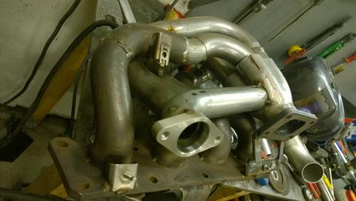

1: semi-ready exhaust manifold ready for TIG welding

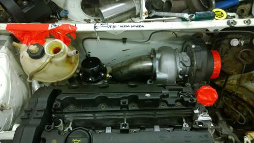

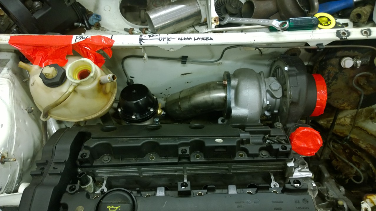

2: Overall view how charger and WG will fit
3: Overall view how engine sits (Yes, i have a spare front end from one scrapped 1.6 GTi, very handy for this purpose)

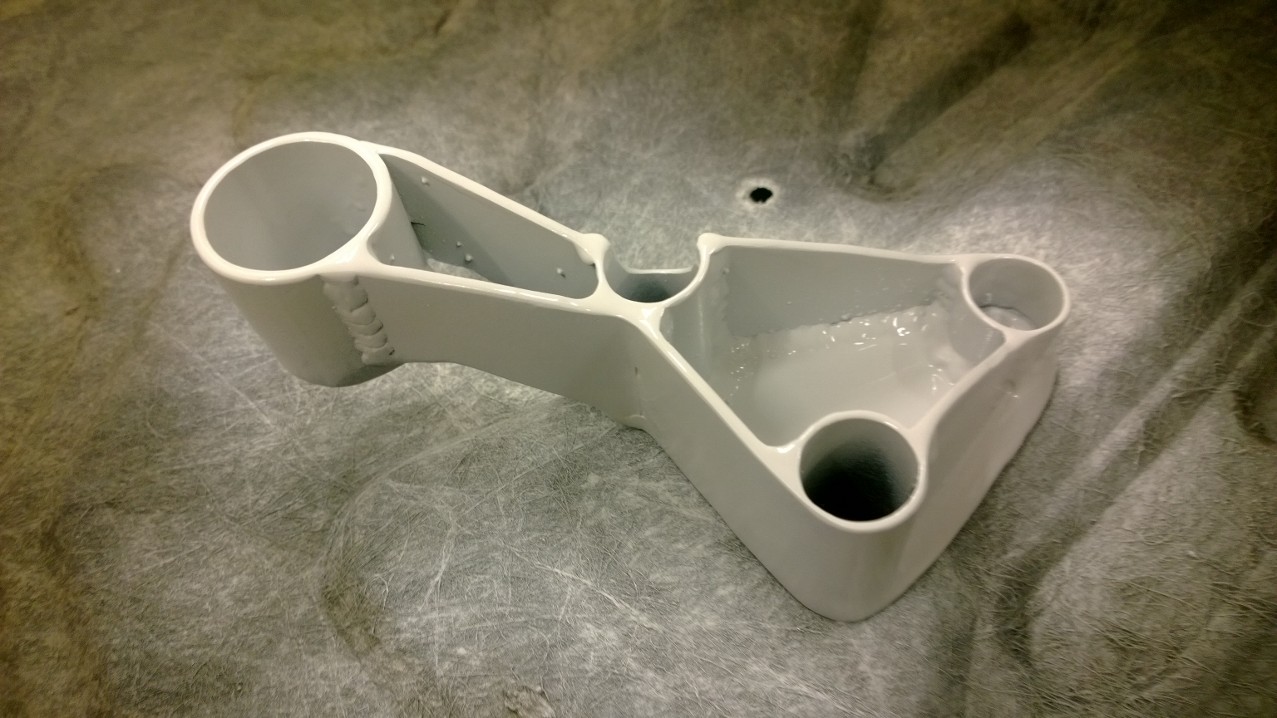

4: DIY upper mounting for EW-to-205
