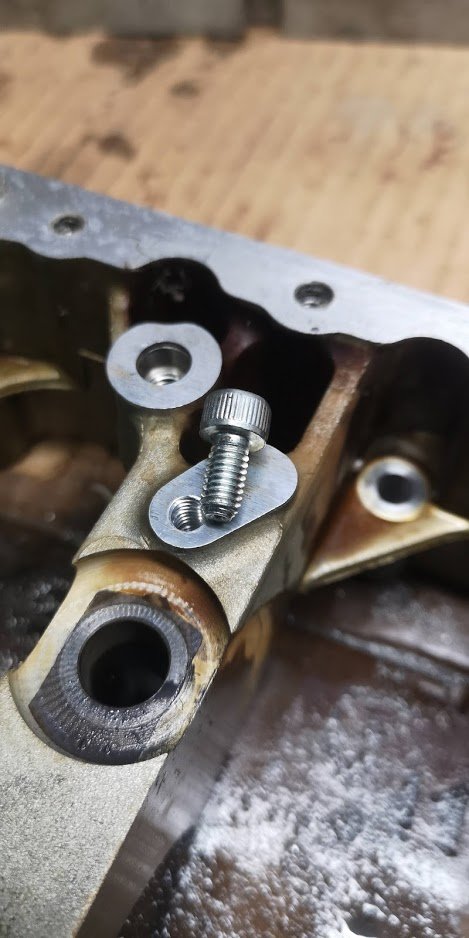

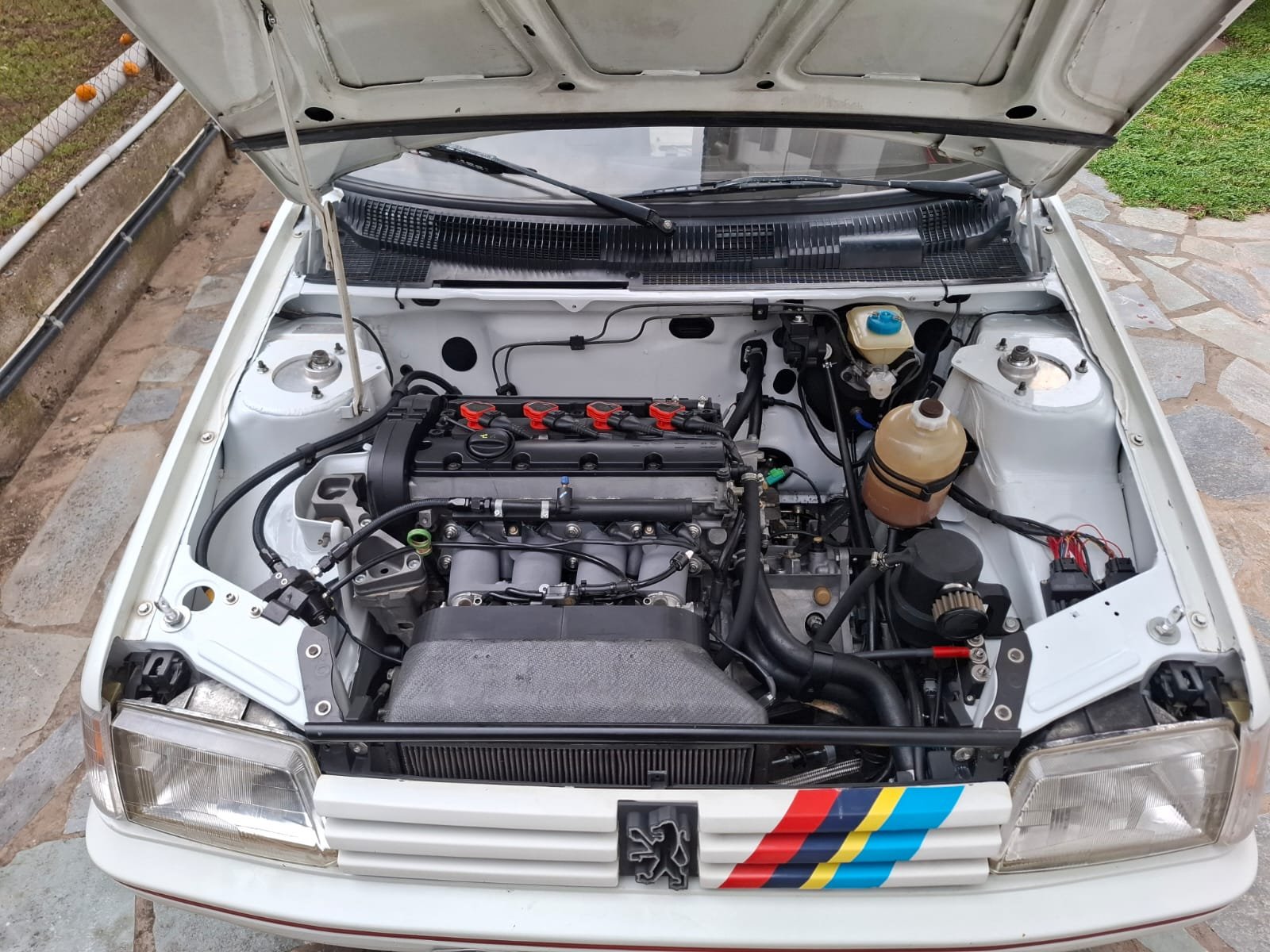

Now, I got the EW12 engine dissasembled, and the EW10J4S head on the machining workshop to be cleaned, skimmed, and new valve seals taken.
The balance shafts has been deleted, and I will balance the cranckshaft to prevent vibrations as dcc told here:
The oil gallery to the balance shafts have been already tappered and blocked
