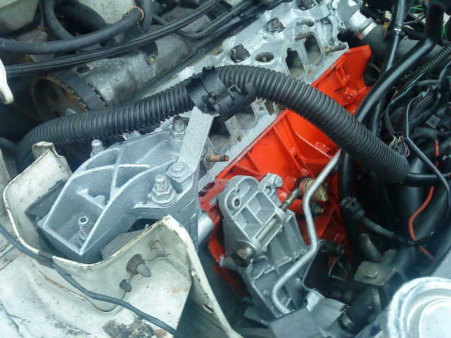

Engine id tag / number is either missing or has been painted over when the block was done.
It should be on the top edge of the block in your picture below;
Above the top allen bolt through the engine mount bracket.
If all else fails, whip a sparkplug out & rest a straw on top of the piston to measure the stroke when you turn the crank (by hand).
