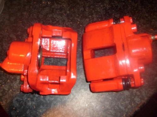

Well the welding hasn't come on any further since the photos, but I've got a beam being made up by Anthony so that will be fitted early new year. I've also picked up some 1.9 Girling calipers from James (thanks!), stripped them down and found two of the slider gaitors were split so have decided to rebuild them, probably with a BiggRed kit. So popped the pistons out, out with the seals and had them shot blasted - this is the result:
Am going to give them a lick of Hammerite, just black nothing fancy then pop the new seals in.

Calipers are well on their way to being finished, I've ordered a seal kit to rebuild them once the paint is finished - I'll post photos soon. Got the new bolts from Pug to get them fitted.

Calipers painted and rebuilt using a Big Redd kit, didn't seem to bad of quaility putting them together but I'll see how they hold up. They look very orange in the photos but are a nice glossy red up close.
