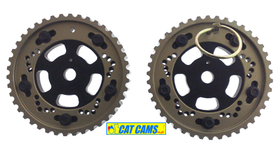

And also a set of these:
Thinking about getting a set of Catcams too as I'm going to have to get the Emerald re-mapped anyway.. Will have see how things go next month financially. B)
