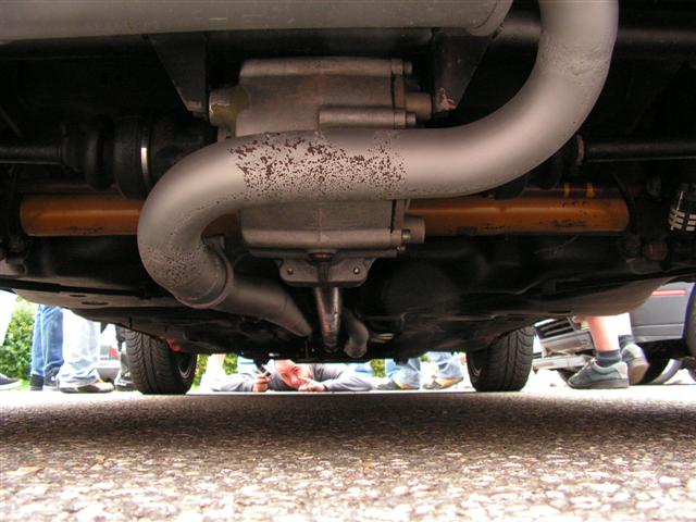

My brother had a Dimma 309 with Mi4x4 gear on it. Also there is a system called Dangle that put a diff through the standard rear trailing arms. With the Mix4, I think the same transfer box was used in the 405 T16 (correct me if I am wrong Nik!) and that was good for 220bhp +
There was a 309 Cossie x4 too and I have seen a 306 Dimma with 4x4 Cossie runing gear. Apparently all that was needed was to shorten the propshaft by an inch or so! The wide arches covered the rest! There is a 4x4 205 in the PSOOC Cornwall grou with a V6 in it too, all under a standard body. Not quite sure how he has done it, but it has been about for a few years

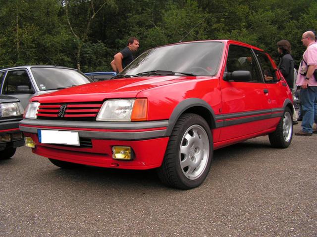

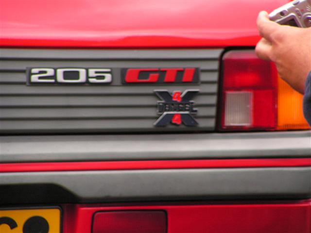

i like that 205 Mi16x4 Dangel..... the fact that it still looks standard helps!! B):)
could be an interesting drive
