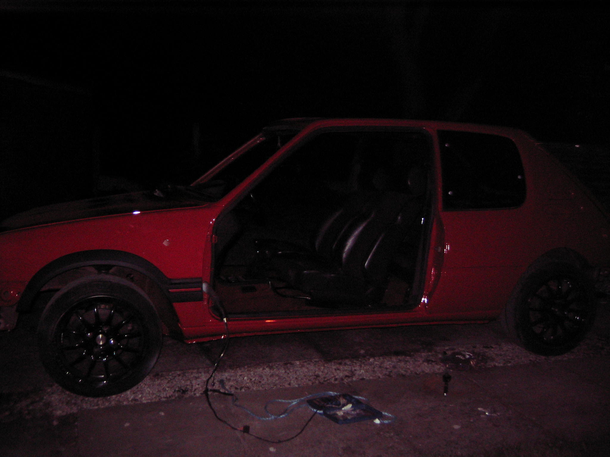

I have the car back...
...It's lush, as a ponce might say
Really really happy, there's obviously some blemishes because I didn't pay top doller and prepped it myself, but 99% mint. It's got a glasslike finish and looks awesome so I'm really really happy. Only got one photo taken about 20 mins ago with a s*ite camera in the dark, but you can get the general jist of the gloss effect. I'll take some more tomorrow!
Edited by gti-si
