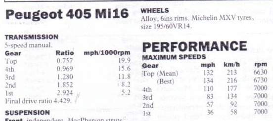

Noooooooo 405 Mi16 when it had 14inchers 195/60/14 was 19.9mph per 1000rpm in 5th, therefore 7000rpm in 5th would equal 139.9 mph.
But anyway I'm now determined to find the true ratios of the Xsara VTs because 120 in 4th aint Mi box.

That's just confused me even more because 0.95 x the 4.4 CWP is same as Mi 4th and should not equal 120 :wacko:
LOok ere:post-27-1177361243_thumb.jpg
Maybe 115 @ 7250rpm though I guess. Then add on 5mph overreadin on the speedo, so yes I guess 120mph on the speedo might be possible.
