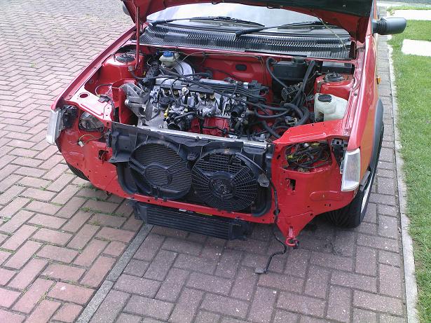

update! so much for the quick turnaround, anyway here are few more pics.
Got the cossy intercooler fitted at the bottom so havnt had to lower the rad etc. Looks quite nice but is quite close to the floor. Got a oil catch tank coming in the post.
Thinkin of adding another fan just in case.
Need to get some samco pipes etc so if anyone has any spare let me know after 63mm / 2.5 dia
The lower strut brace fits fine, cheers dan for the hand at the weekend!
Starting to take shape. :(

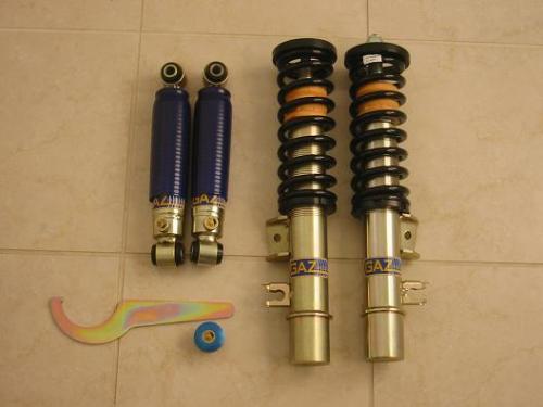

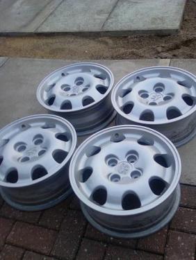

few more pics :( shocks where fitted ages ago and so where the wheels with new f1's but thought id start a whole thread about my car and its progress. :)

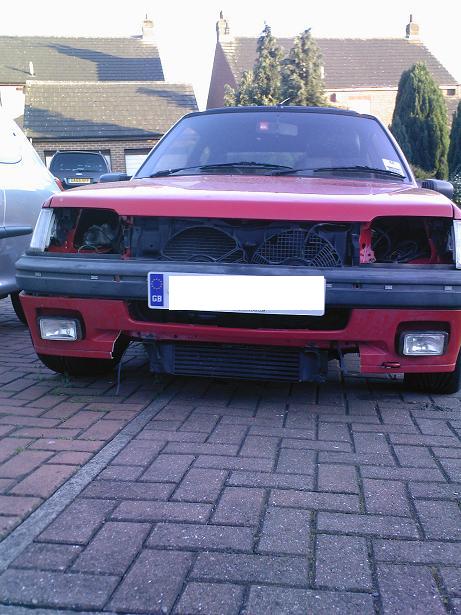

tonights fun and games - cutting the front bumper to allow air to reach the intercooler.
The picture looks a little ruff but ive used ms paint to show how im going to finish it tomorrow. I pratted about cutting less of the bumper and making it look nice to find it still was in the way and blocking air to the ic.
If anyone can think of different lines to cut tomorrow let me know :D

frodo_monkey
Some good work there fella, have a well-deserved beer :blink:
Those lines look fine to me, but as you well know from having seen mine, I'm no perfectionist when it comes to looks...:D
Just don't go over any speed bumps - you saw the problem I had getting mine onto a trailer!

i like where that intercooler is maxo. how low is yours? whats the ground clearance like?
max0
Looking good max0, here's Fuqa's mounted intercooler I was telling you about http://forum.205gtidrivers.com/index.php?s...=59446&st=0
Didnt know if you had found it or not, may help you with your pipework ;)
The clearance is quite low tbh, I can move the intercool slightly (maybe half a cm up) but if needs be I can alter the height on the front shocks as its slammed at the moment. The picture was taken on a hill as well which i dont think helps. Snow / Rabbits / Road kill / Speed humps may be a issue :S
Cheers for the link sam will have to order some hoses tonight and start planning on connecting it all up :D

Looking good - personally I would have dropped the rad and mounted the IC above - but it'll work just the same. With regards to the gearbox - have you considered a hybrid option? On mine I run the standard 1.9 but with a TD final drive. That way I keep the 1.9 spacing (long 1&2, close 3/4/5) but just drag them all out by 10%. Works a treat.
max0
I had planned on dropping the rad and mounting the IC above, however when it came to it I found it easyer and involved less cutting of the car! to mount the cooler below.

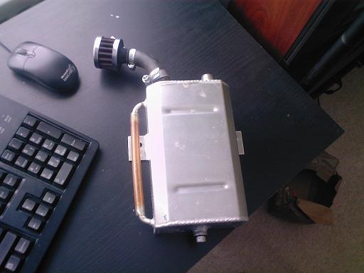

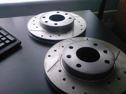

update - few parts arrived last week, oil catch tank and some new brake disks. now skint! ..
.. anyway with the added weight of the iron lump id like to go to gti6 brakes/309 drive shafts etc but funds dont allow at the moment so ive just gone for some cheap drilled / groved 1.6 disks which should work well along with the mintex pads.
Ill update the thread later in the week with more progress its not far off now. just really needs the wiring and hoses connecting up.
