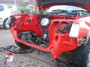

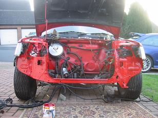

update got the engine out and removed the rust from the front, also primed ready for painting tomorrow morning.
Once painted im hoping to get the gear box off the old lump and onto the new one, and then mount the engine, wheel it out onto the drive, then tidy up before the olds get back... Its going to be tight to meet the deadline!! :lol:
Andy
good job there buddy :) just surface rust then? that downpipe is shot!

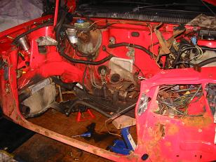

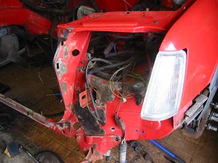

Misson failed!
Managed to get the front end cleaned up and the box off but to play it safe all was put back to how it was.
Here are a few more pics, just showing the rust and it semi cleaned and a shot after. The paint colour isnt the best match but long as it keeps the rust at bay for a while ill be happy.
The plan is now to get the box cleaned up and on the new engine this weekend and fit it some time next week... :( Happy Days

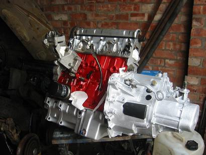

1.6 gear box attached and cleaned/pained. Now looks like this...
sonofsam
Engine looks very plush mate, shame it will be mostly
covered over by pipes, hose's and loom :D:(
When's the next ETA?
whizzer71
Whats that front top mount off ?
:ph34r:
peter
Looks like a mi16 top mount to me

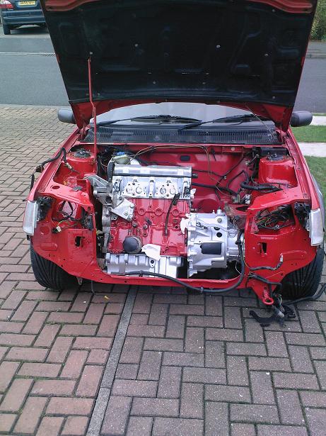

Engine in today....
