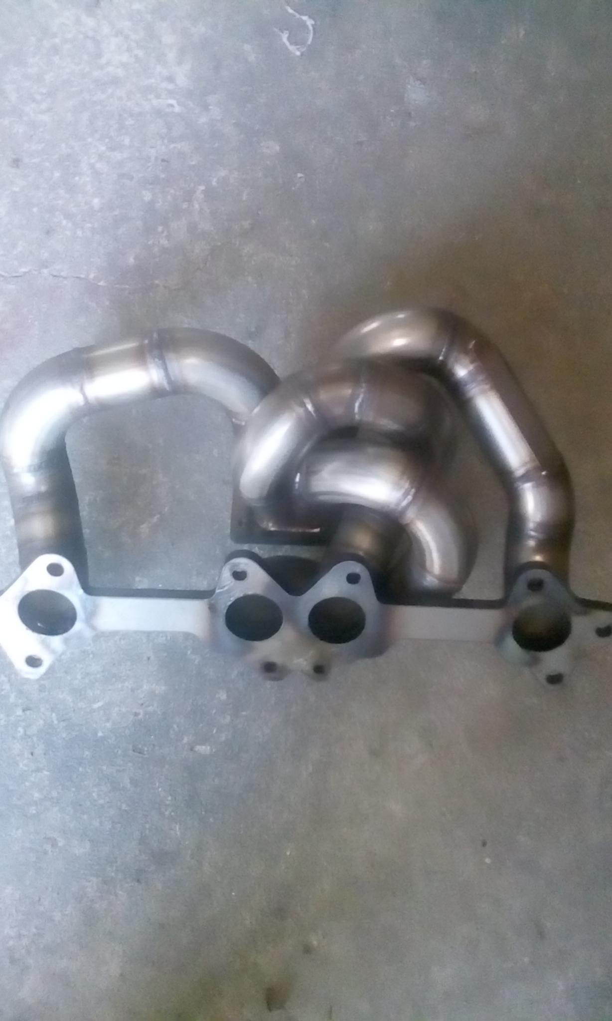

Picked this up for a case of beer...bargain of the century and couldnt help myself. I believe its the DP engineering manifold designed for the Xantia/406 bay. Will put it on down the track or save it for a 205 project.
I'd get them ceramic coated, even if just to keep them pretty.

Those DP manifolds are amazing quality!
