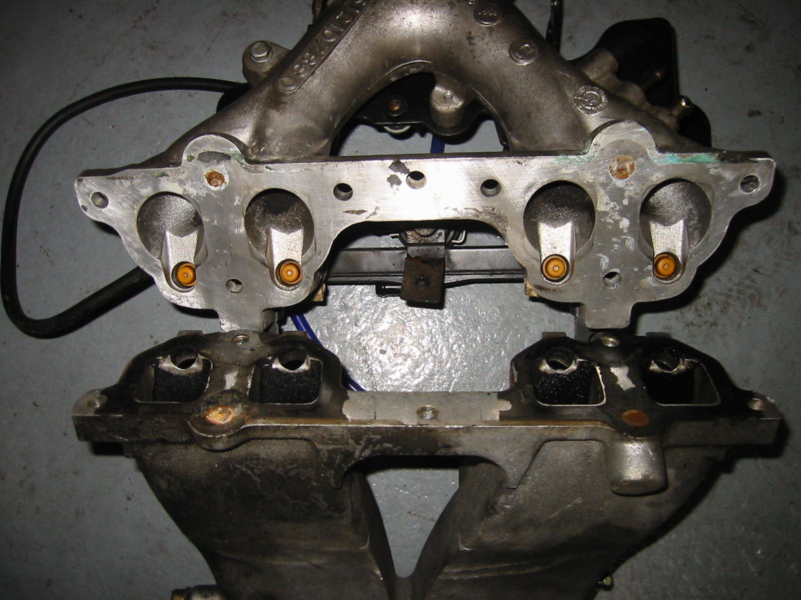

Henry Yorke 270 3 Cars Posted May 16, 2018 Differences between XU10 inlet manifold and XU9. Throttle body on Xu10 is only 50mm compared to 57mm from memory. You can see where the XU10 inlet marks the XU9 gasket so they are not a perfect fit. Share this post Link to post Share on other sites
20five_t 1 1 Cars Posted May 17, 2018 (edited) Henry, are you running the xu10 inlet on xu9 head? Edited May 17, 2018 by 20five_t Share this post Link to post Share on other sites
