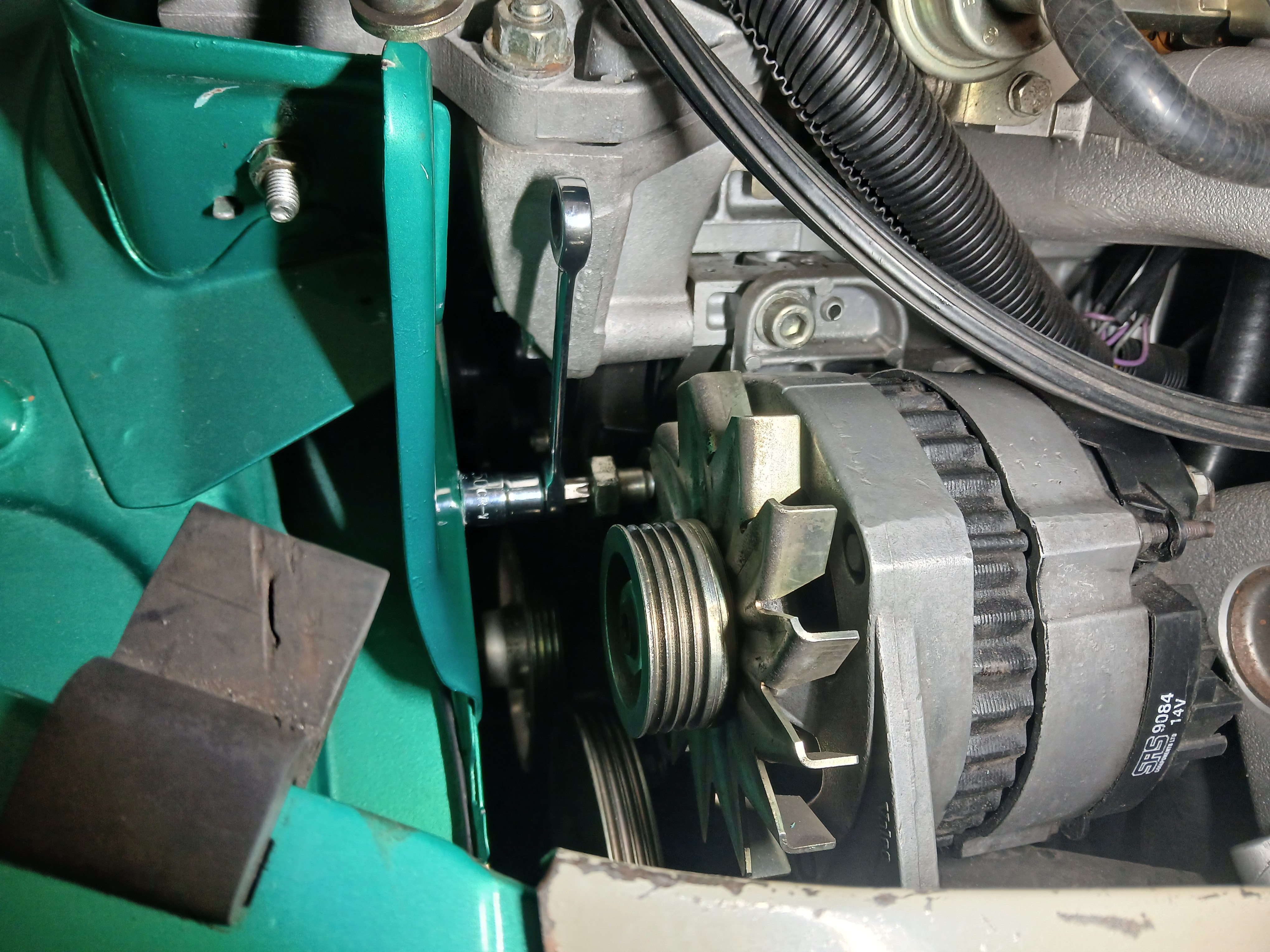

Started off as the alterator belt squealing , tried to tighten  it up no good then realised the lower tensioner bolt has sheared of in the pas pump.Didn't have a 21mm to hand so put a torx bit in the long alterator bolt and used a ratchet spanner to turn it now its hitting the inner wing and I can't go back as the ratchet spanner can only go one way , Im an idiot lol What a fantastic design this is :lol: a french boobytrap ...I think I'm gong to have to hacksaw off the torx bit you get it out now .
I actually found the sheared bolt in the rear torque mount ,how it managed to get in there and not fall in the road  I just don't know !

Well after much faffing and 5 broken junior hacksaw blades its out , gave up cutting through the bit its near impossible lol ,should have brought the grinder back with me but  discovered you can force the 8mm ratchet spanner back round between the engine mount and body with a bit of abuse to wind it back in to let the torx bit out. Pas Pump now off and the bolt is sheared level with the surface but I'm hoping it will come out again if I drill it .

No left hand bits and didn't fancy welding it so I tried to drill it but even centre punching it with a small bit it went off to one side , then an extractor/easy out  which was a waste of time ,probably expanded it and made it more stuck so I used a 5mm bit in the drill to wear the sides down and collapse it in , it took ages but got there with minimal thread damage , a coat of black and its ready to fit once it dries as it got chipped all over .
I think it would have been better to use a bigger bit to align the centre first as no flex, if I had got it drill in the centre id have tapped it and locked a bolt into the piece with a nut and it may have wound out.If there was room to grind a slot without damaging the casting  it would have been easier.

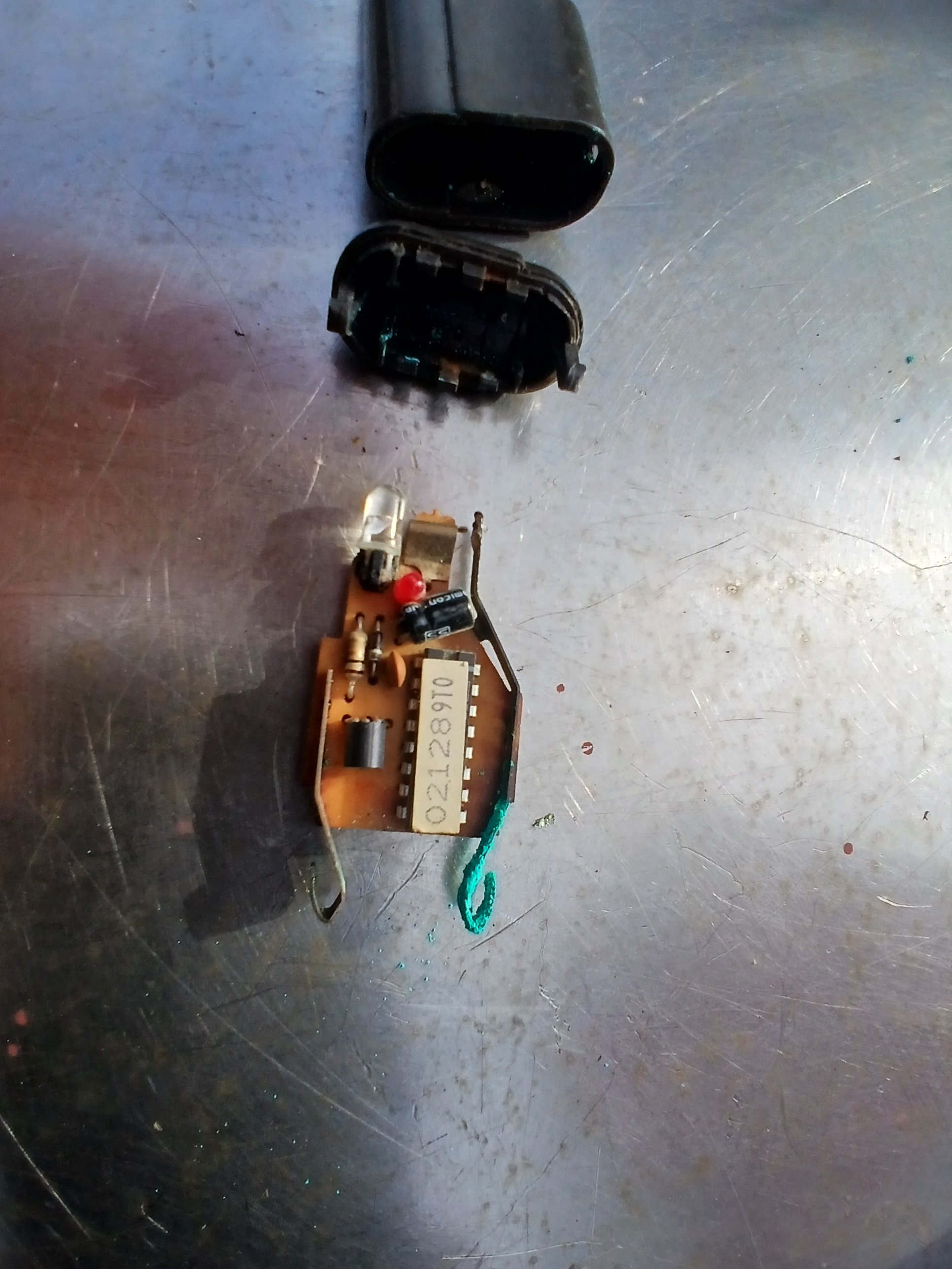

I bought one of the new central locking kits discussed on thd forum and it got me thinking about the original plip I bought a good while ago. I took it apart today and found bad corrosion on the contact which has cleaned up ok so I ordered some D357 batteries and see if it does anything at all.
I hoped one of the 3 receivers I had might have the same number but no , I suspect there are actually very few codes but who knows. I have read the thread on how to match up the plip to another receiver joining and drilling the tracks but I don't understand it yet !
I opened the receiver on the original to the car one but it has a pin rotted off and looks not too good inside.
