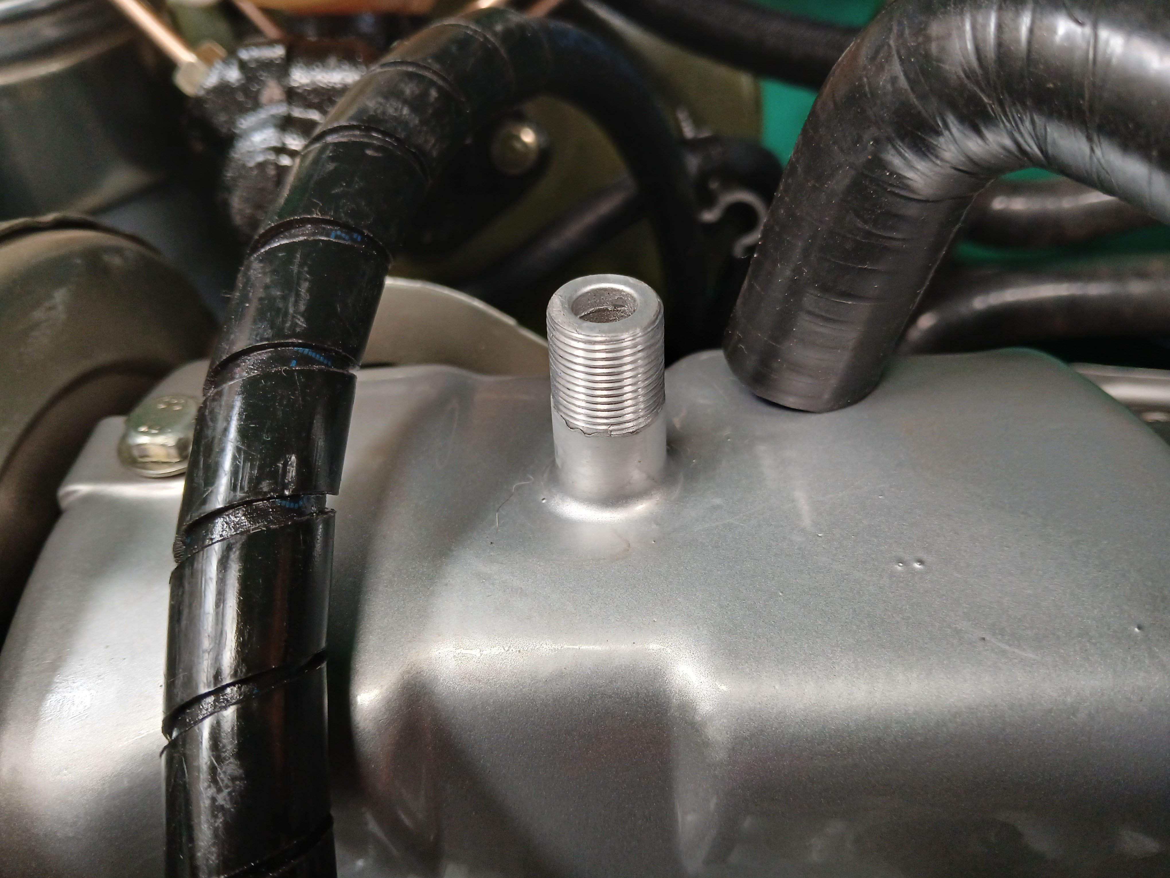

Thanks Paul mine is leaking oil too not sure where from yet but it after it sits a few days there is oil underneath the crank pulley area but as the floor is sloping down to that side it could be coming from anywhere and just dripping of there. There are going to be teething problems after everything has been off and its sat idle for 19 years that I know off possibly more. The unexplained first breakdown unless it was low fuel is bugging me though ,time will tell.
    I cleaned all the oil up and thought about how I could keep the breather pipe on better and well it was simple , tap the spout to m14 x 1 ,(I which is a fine thread  measured and its 13.7mm at the top and just over 14mm nearer at the bottom so has a little taper)   to give it something to hold onto , I didn't tap it right to the bottom as I didn't want oil creeping down the thread when hot . I also used a sanding belt by hand to sand the powder coat first and then Scotchbtite after to dull and smooth the sharp thread and cleaned it all before refitting .
        Torquing up the rocker bolts then didn't seen to want to click out as I've fibre washers on so started at 4nm and just left it at 6  as you could keep tightening till it rings the thread easily. The fibre washers are not really wide enough and I need something better but will do for now , I went a quick 7 miles and there was oil near each plug lead as before but I hope its just sweating out from the gasket which had a lot of oil on it we shall see.  My main goal is to get the engine bedded in this year , if it needs to come out after that in the winter  to fix issues so be it.

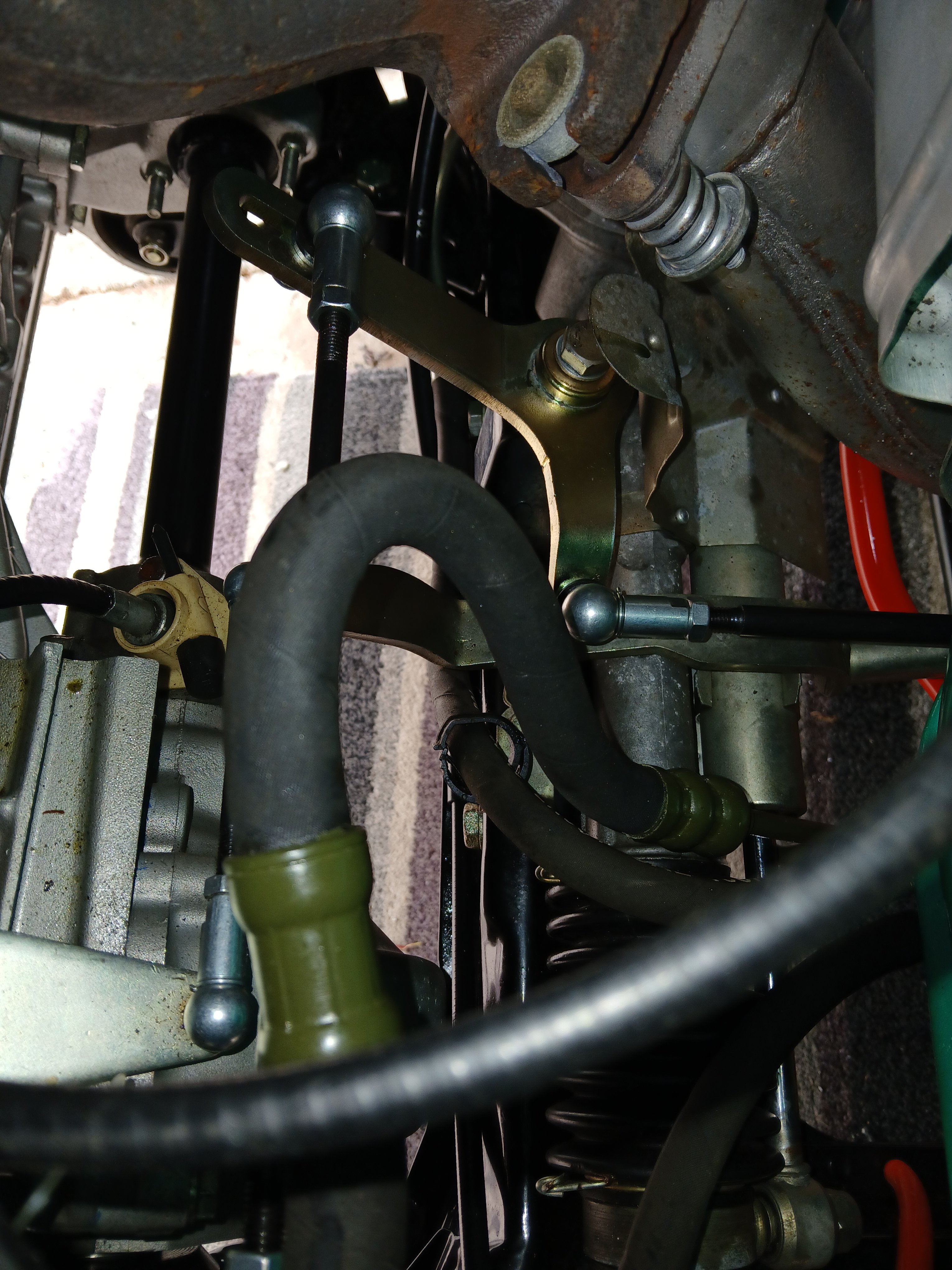

The gear change was too tight after fitting new plastic bushes so as the rods were worn I fitted a Bakerbm quick shift plus new rods which have little locking spring clips , all this was a right faff to fit on ramps but it's on now and gear change is much lighter but I've just left it at standard throw for now , there seems a long throw from 2nd to 3rd compared to more modern cars but its's no big deal . I also fitted the rear badges and 8 little grommets in the passenger floor which would have let water in , these are bullet shaped originally but I just fitted standard ones .The gti doesn't use these holes if Id known at the time  id have welded em up lol. Waste of time putting heat paint on the manifold its all gone already ! Tightened up the manifold springs to reduce a blow in the exhaust but think its more at the back and the clamp I've fitted isn't the right size ,I think it was a 55mm one , tightened it up a little too and its a bit better .

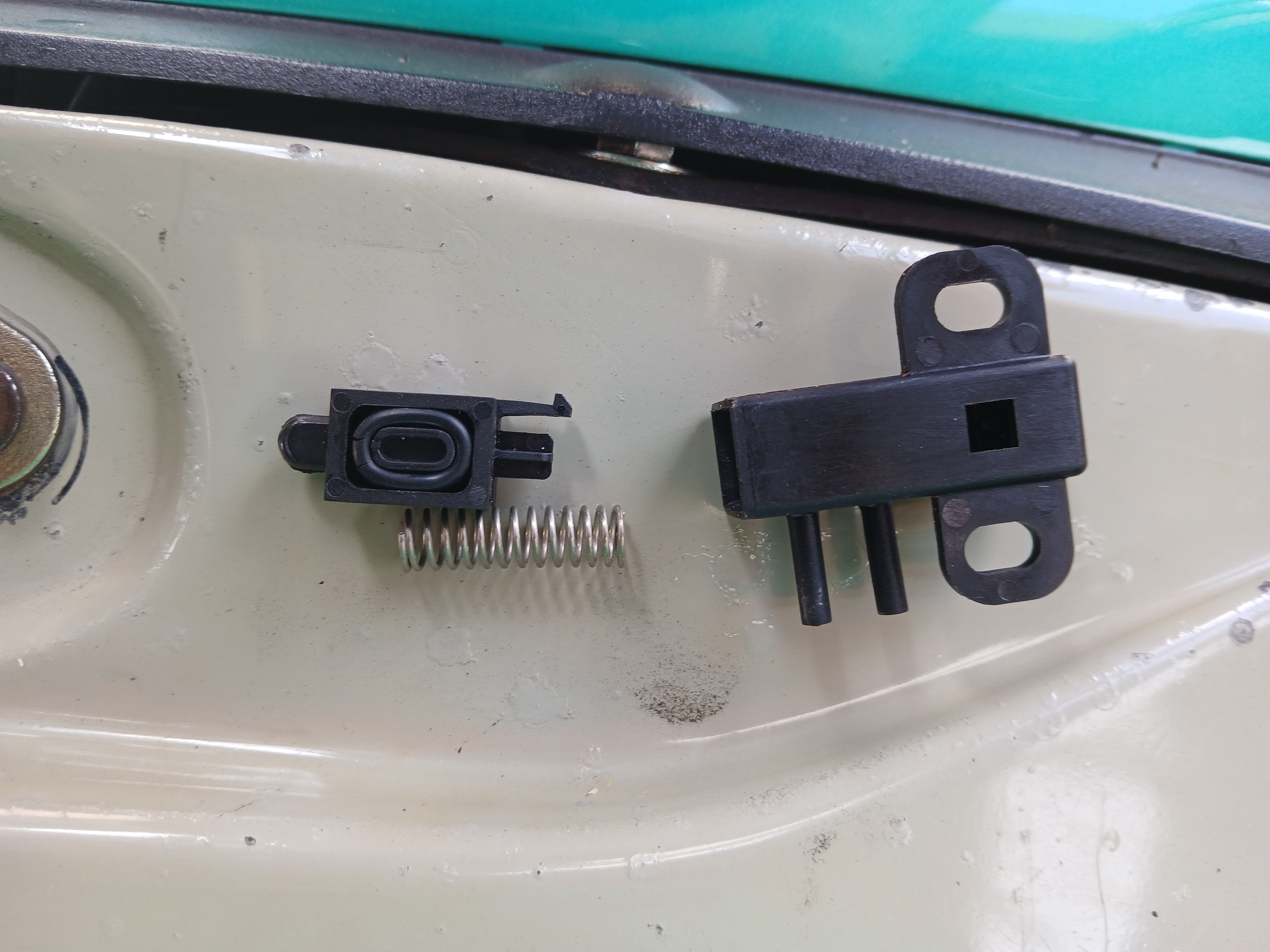

Did a bit of work today , started with the sunroof switch , these can be opened and all is inside is an o ring and a spring , my o ring was split hence the hiss and loss of vacuum as soon as the car is turned off . I put another slightly larger o ring in and jobs a goodun. it now opens and closes the seal 5 times after you turn it off . Result . This made no difference to the fast idle though but I did fill with super unleaded this morn , had E10 with an additive before and with the sunroof handle down it did seem to run better , its certainly not shunting much and is running fairly ok just the high idle .

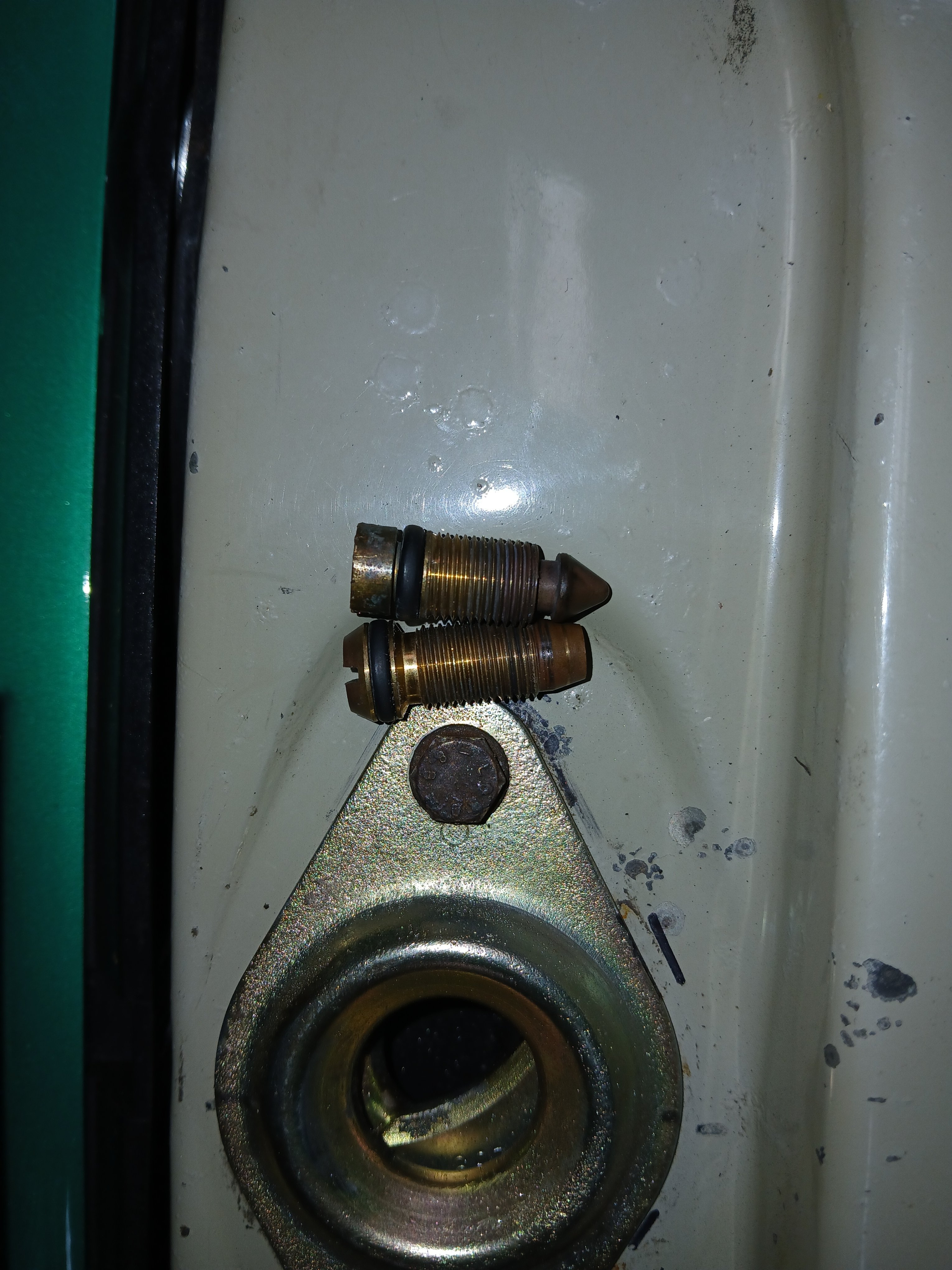

    Next  I took out the throttle air screw (not had it out before) and it doesn't look like the one in the other throttle valve I have which made me think it had the wrong screw fitted , The one in my car has a blunt end and doesn't come to a point like the other , I tried the other one it but its far worse with it , revs to 2k + and it feels a bit loose until its well down so thinking there are 2 types ? Anyway I cleaned the body out with brake cleaner as much as I could while leaving the 2 water pipes attached.

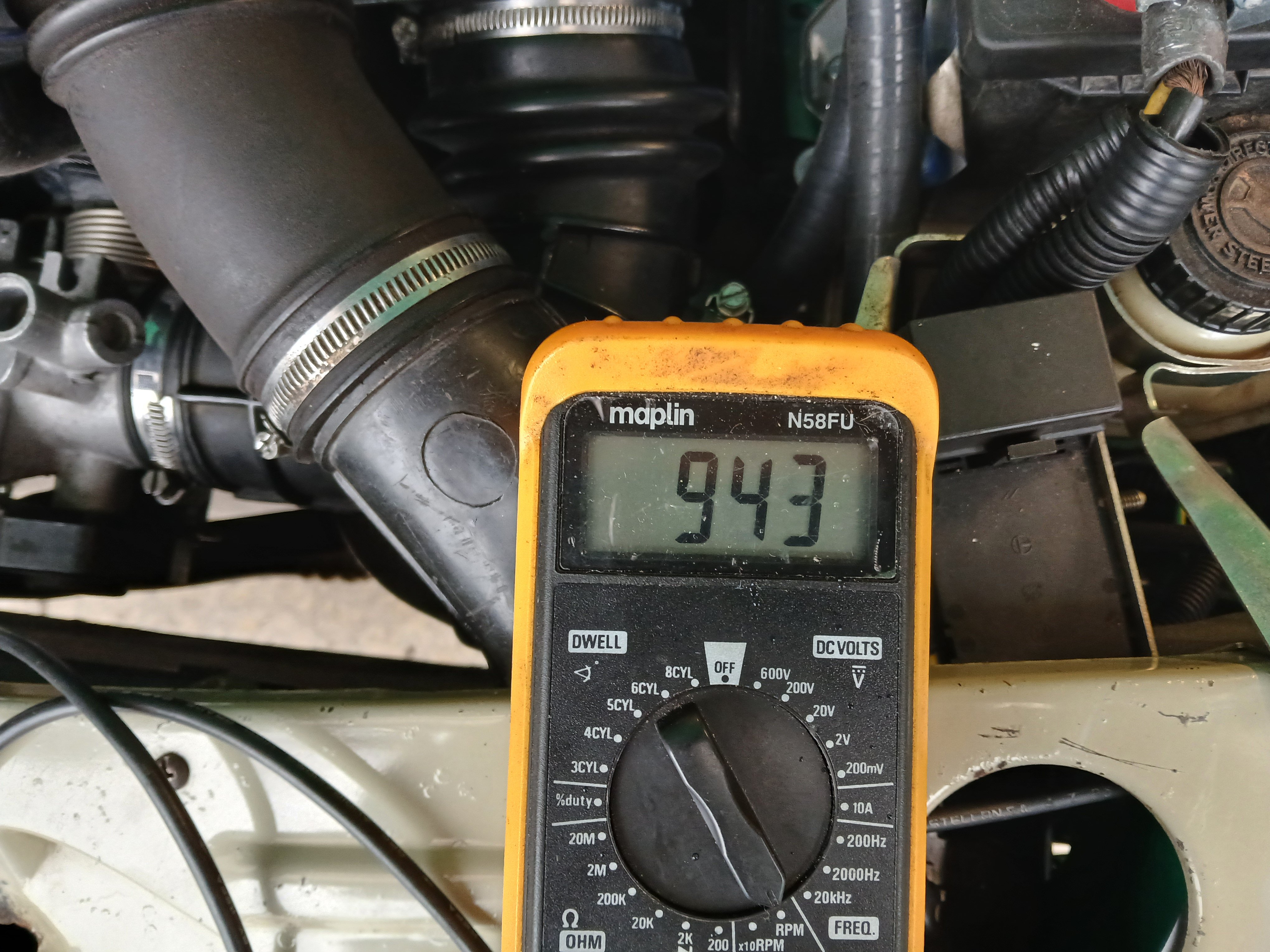

Had another crack at this after getting up from nightshift , Metered the TPS and the micro switch is working ok , it took a good few goes before I could get both the click as soon as it comes of idle and it coming fully back to the throttle stop,I didn't bother measuring any gap this time .A few times I didn't hear the click , other times I couldn't hear it tap the throttle stop when closed . I think it was holding out the throttle lever before as it has a tendency to move when tightening the bolts.After that it was down to 1200 rpm again which is where it was at before . I thought maybe 4 turns on the throttle lever screw was too much due to wear and backed it of half a turn and it came down to just over 1000 rpm.
     I then checked the CO at the exhaust and it was 3 % now so I had to wind out the 5 mm allen key In the AFM quite a few turns now to get it to read under 2 % , the further in it is tends to lift the idle speed . After much twiddling I got the idle down to 700 rpm with the throttle body bass screw fully in and was able to wind out a little to get 950 rpm and and adjust the AFM to get 1.5 % CO though it was messing about a bit so may need rechecked .
Ran out of time and it was way to wet to go out a run anyway . I think the new O ring in the throttle body to manifold was needed the old one seemed to hardly touch at all so maybe it was allowing a leak and the AFM was screwed in too far to compensate for it .

I had a look at the other throttle valve and as Tom suggested the adjusting screw is totally siezed anyway , was there a plug went over this to stop it moving once set as id imagine there was but never seen one ?
Edited by Leslie green
there would have been a small spring clip affair under a plastic anti taper cover originally
