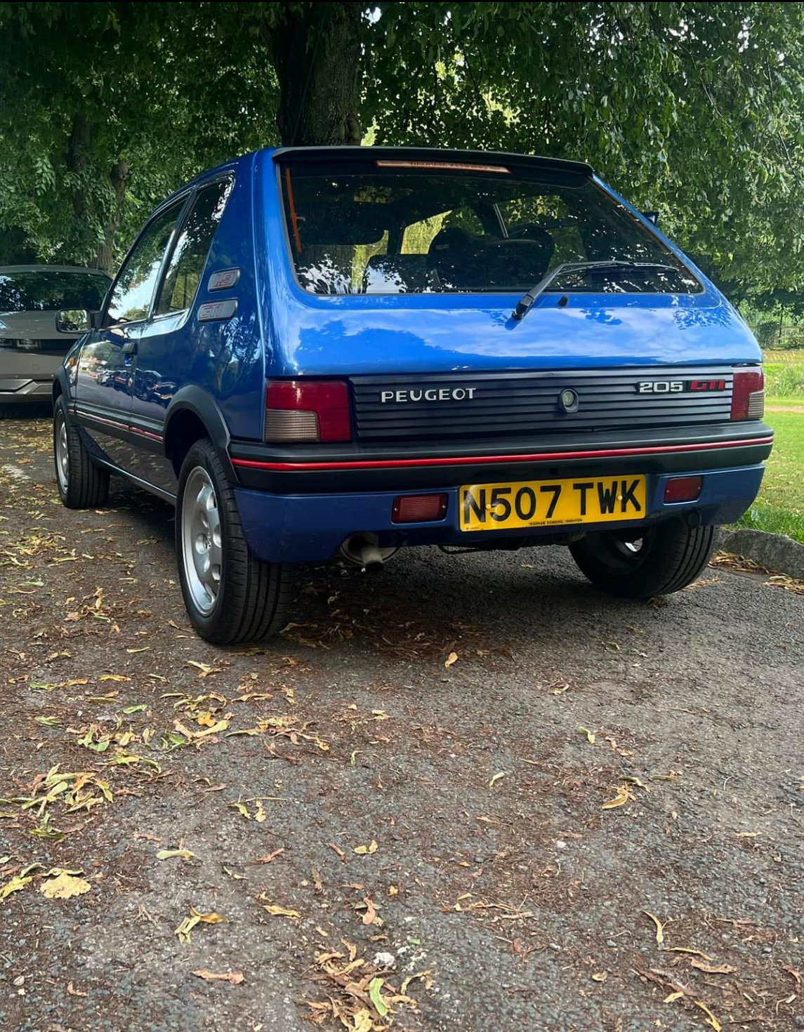

I have those strips on my  blue 1.1 gti rep, they aren't too bad but are a slightly different profile to the originals. Again if none are available they are a good alternative :)

Would help if I added them !
The profile is very slightly rounded but looks good for what’s now available !
