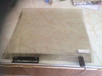

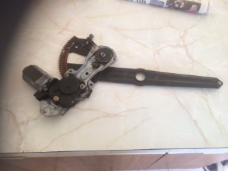

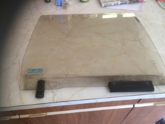

Staffyed 3 1 Cars Posted December 22, 2016 Hi, Today's teaser is - The windows on my CTi get stuck half way up or down - varies. I took apart the mechanism today and there is very little support apart from the window seal guides. The mechanism for lifting only attaches on the slot on the bottom of the window, but there is another holed bracket further along the window. See picture. Should there be another bracket to help push the window up square? Does anyone have a Peugeot drawing of the door assembly? 1 Share this post Link to post Share on other sites
welshpug 1,727 Posted December 22, 2016 (edited) I think there's a part missing, but might be the difference between the hatch and the soft top? Edited December 22, 2016 by welshpug Share this post Link to post Share on other sites
steve@cornwall 100 Posted December 22, 2016 (edited) Can't tell from the pics wether the plastic guide is still present on the front of the window or if that's discoloration ever it used to be. The rubber seal that sits in the front channel sometimes tucks up and catches on this.In either case it's that guide on the leading edge that keeps it square in the door. The bracket arrangement looks right as there is only one arm on the convertible as opposed to the hardtop's two. Edited December 22, 2016 by steve@cornwall 1 Share this post Link to post Share on other sites
Staffyed 3 1 Cars Posted December 28, 2016 Thanks Guys, Steve - looks as though the plastic guide is missing, I just have two rivets in the window which should be clamping the guide in. You don't have any pictures of what one should look like?? Share this post Link to post Share on other sites

Staffyed 3 1 Cars Posted January 10, 2017 Looks good Alex thanks, Found the guides in the track, the plastic has broken around the hole. So going to try ebay 106 ones and drill them. I'll post back when I've done. Share this post Link to post Share on other sites
