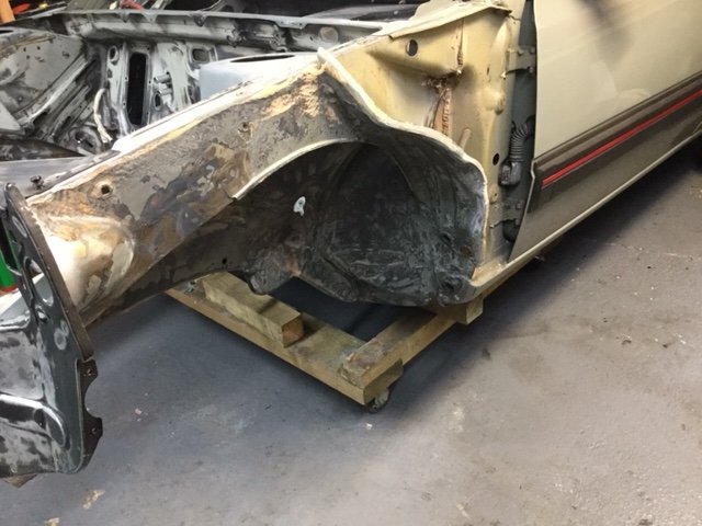

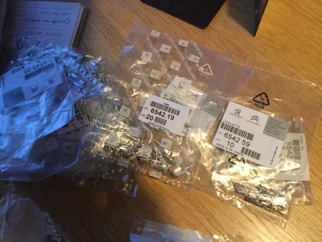

A little more progress. I have fitted and wired in my Epas steering column, so that job ticked off, started some sanding down and spent an absolute fortune on cables, plugs sleeving , relays  etc and some replacement pins from Peugeot so I can fully rewire all the awful wiring that goes from the fuse box to the engine bay for lights, indicators, wipers etc. Oh, also bought some new capitive nuts for the subframe mounting to replace the two broken ones
Andy whilst you are at this stage I would have a very good look at that seam across the bottom of the bulkhead. I've seen lots of cars now where it is in poor condition with the spot welds pulling apart. With the carpet etc out you can stitch weld it from the inside and then re seal.
Andy
Thanks for that advice Tom. I am going to have to do some work on the tunnel to gain clearance for my exhaust manifold, that will be a good time to take up your suggestion and look very carefully at that seam.

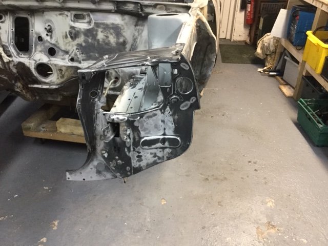

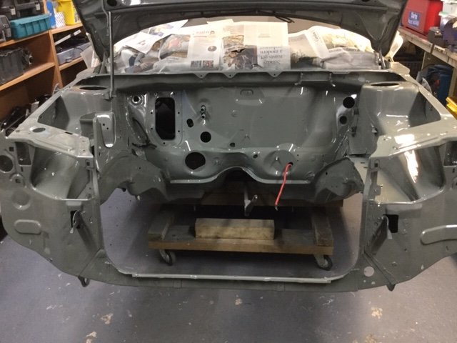

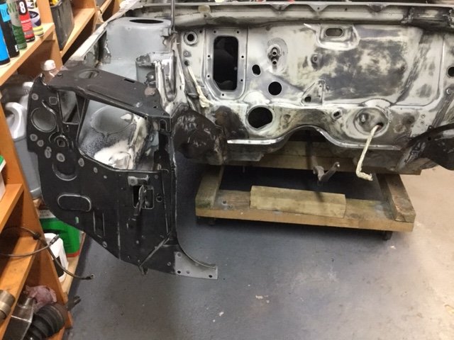

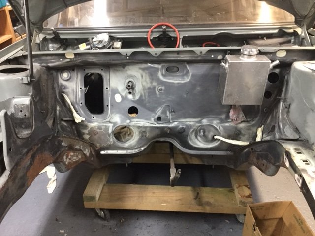

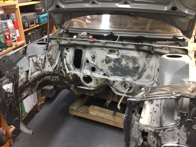

A bit more progress on the bay . All rubbed down and finished with 320 grit. Front panels replaced ( I bought a complete aftermarket front panel and then pulled it apart as the fit was not great ) but I have not put the bottom rail back on just yet.
On the engine front, the block is bored to 87.00mm and decked to 234.8mm. Wiseco pistons ( bespoke) on order and Fardon Rods( also bespoke ) on order too.
Andy

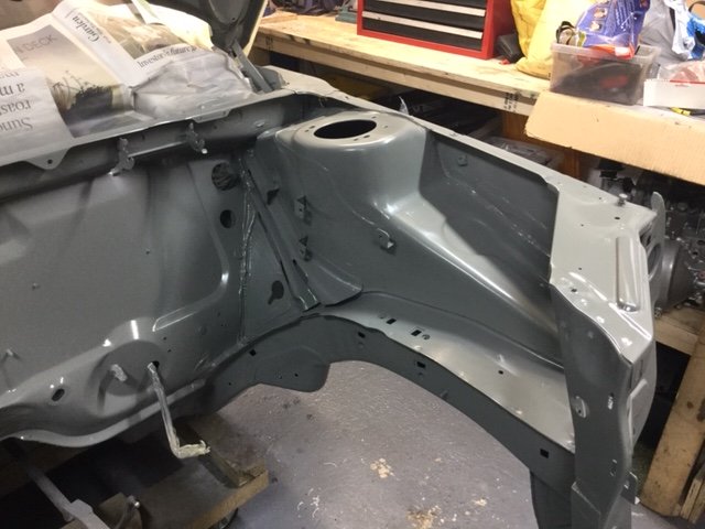

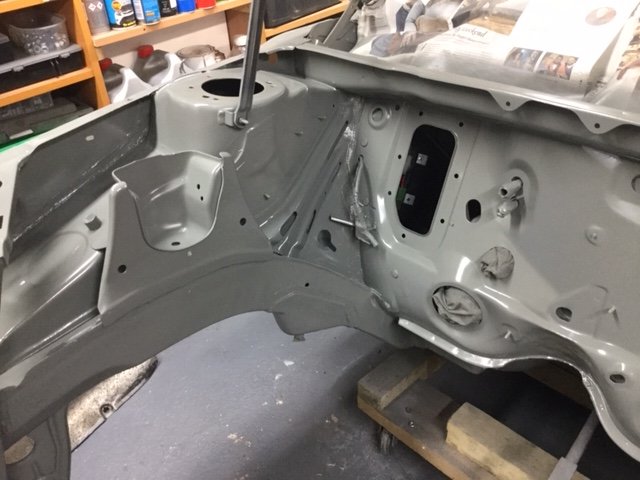

And many hours later ........ Just need the lacquer now and the @#£*+-@# bodywork is done .

Thank you. I do not like doing the bodywork and paint stuff. I have a compressor and spray  gun, but opted to,use rattle cans, mainly because the off the shelf ‘Industry Grey ‘ from Halfords is the correct paint code and the colour match is excellent . I still have to rub it all down again before I lacquer , but I will give it a few days to harden off a bit before attacking it with scotchbrite ( or 800 grit )
Andy if you want my advice, use proper 2 pack lacquer. Stuff from cans is just not durable enough. Especially in the engine bay. 1 fuel spill and your spray can lacquer will be off.
Andy

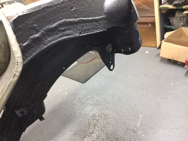

Hi Tom. I would love to use 2 pack but I do not have the right breathing / filtering mask to use that stuff safely ? As I understand it, 2 pack uses isocyanates . I used Rustbuster ‘ epoxymastic ‘ on the underside of the wheelarches . That is a 2 component product. I have to say that once it set, it is exceptionally hard . If you have some advice on the use o 2 pack, I am keen to learn.

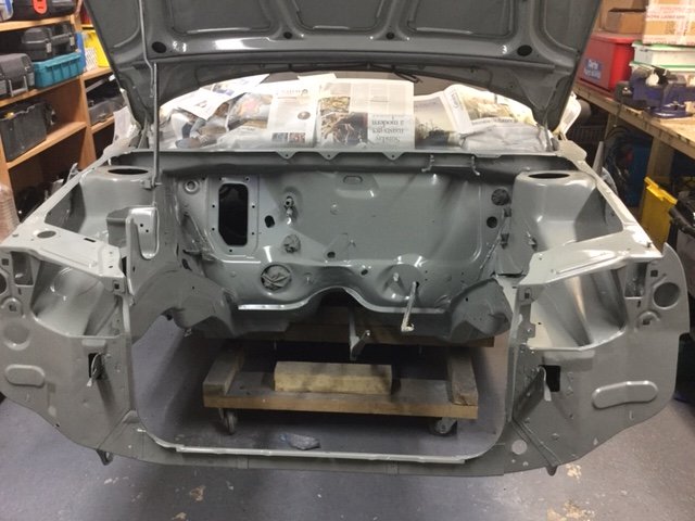

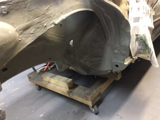

Spraying done as per guidance from Tom. Spray gets everywhere but pleased with the result.

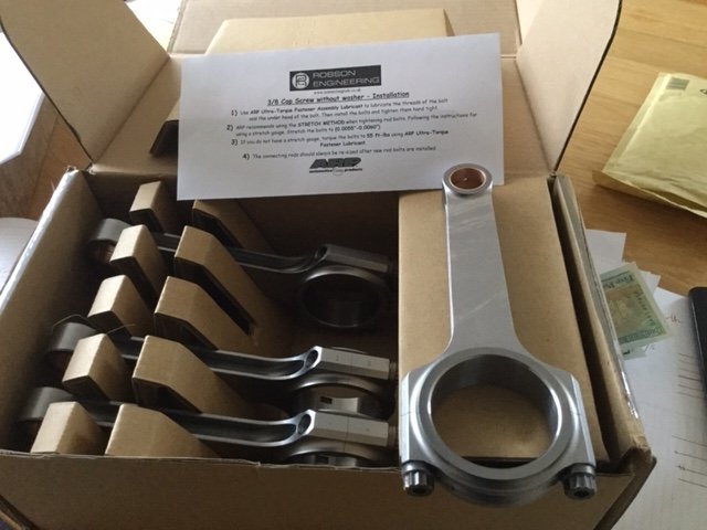

Wiring progressing slowly. I have rebuilt all the engine bay wiring back from the fuse box, so a bit time consuming. Some photos to follow. However, shiny bits arrived this morning in the shape of a set of Robson Rods. I just need my pistons from Wiseco to arrive and I will have all the bits!
Andy
I should have added this in my  last post. I have never dealt with Robson engineering before. I did check that they produce their own forgings to a clearly documented and traceable specification, but that is an aside. I contacted them about three weeks before Christmas with an enquiry. They got back to me within two days with a quote for the rods I wanted. Then Mr  Robson called me to discuss my engine requirements , power output, rpm , and lots of other details. Three  days later a detailed engineering drawing arrived in my inbox for me to check and agree prior to confirming the order. I then paid for them and they arrived this morning .
 Conclusion. Cracking service . I would not hesitate either to use them again or to recommend them unreservedly .
