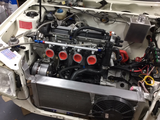

A little more plumbing. Fuel system is almost complete bar one last line from rail to regulator and a set of injectors. I will then drop a couple of gallons of fuel in the tank, earth the pump relay , stand back and enjoy the display of fuel leaks.
Andy
Fuel system completed. Pressure set to 40psi for a starter and all seems to be o.k. ( i.e. No fuel leaks) However, I do have to admit to a schoolboy error. When I first added fuel to the tank and earthed the pump relay , no pressure, no fuel but a running pump. Guess who got the feed and return fuel connections on the tank the wrong way round. Doh. All is well that ends well though. Next stop is to wire in the ecu and see if I can add a spark to the fuel in the right place at the right time.

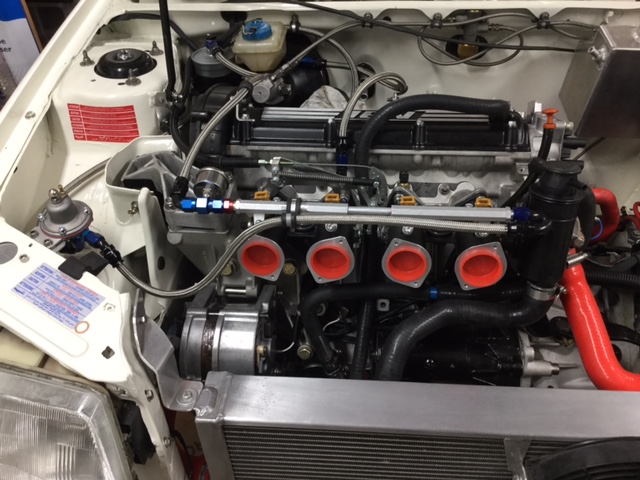

More progress, but with all theses things, not quite as quickly as hoped. I finished the fuel system and then the backplate for the airbox arrived. When I offered up that I realised that one of the fuel lines was in the way. One relocated fuel line later I think I have an operational system again with the pressure set at 45psi . Next job was to finish the loom which I have done bar the termination of two connectors, one for the cam sensor (short of a 3 pin JPT plug) and the map sensor, which I am unsure about. I do not have a 1 bar sensor although I have wired for one and am not sure if it is worth the expense of getting one ( Weber-marelli) at £84 The base map in the K6 maps both fuel and ignition on tps so something to ponder on whilst I do other jobs like locating and plumbing up the oil catch tank, finishing the water plumbing, cutting the back plate for the air box and a hundred other jobs still to complete .
its not absolutely necessary to use a map sensor if its running tps for load, it would only be for barometric correction which in the uk isnt really necessary.
satchell do an inline fpr holder for about £30, this takes the standard non adjustable fpr, I would highly recommend this.

Ah. See what you mean having re read your note. Nothing on the Satchell website so I will give them a call. I now think I have seen something not dissimilar on the Emerald site too. I should have thought of this before and saved myself some expense
the satchell one has 12mm tapped holes so you can use an adapter to -6 or an 8mm hose tail.

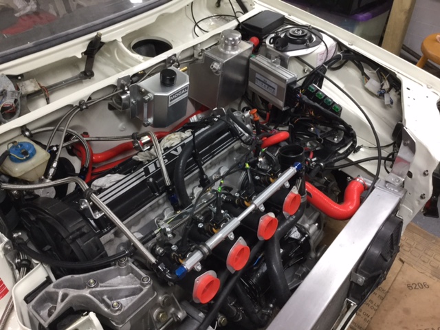

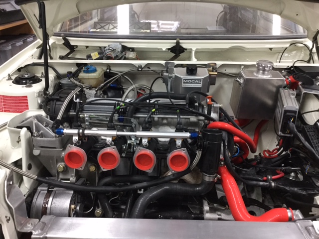

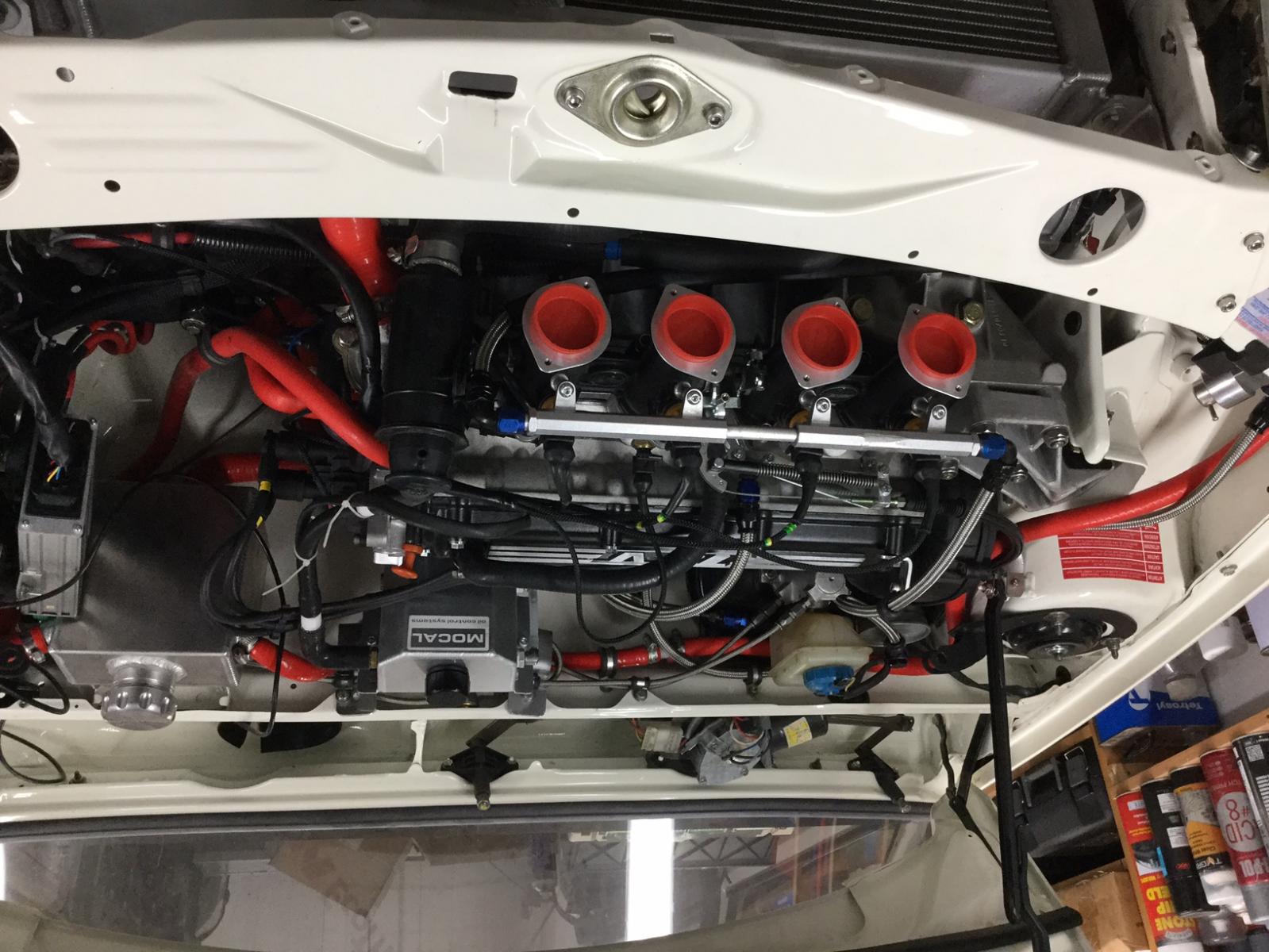

A small update. I have just about finished the water plumbing, ditto the crankcase ventilation and installed the loom, bar map and cam sensors. As soon as I have my fpr adaptor, I can finish the fuel lines, put in some oil and water and see if I can get some oil pressure . At this rate, it may even fire up within the next week or so. That would be progress.
Andy
Got to the cranking over stage yesterday evening. All seems well with oil pressure, green light on the ecu. although the set up and initialisation took a while. The switched power supply I had chosen to use to power the ecu was fine except when cranking, when it went off, which was a piece of pure genius on my part. With the error rectified, all seems well. Just hope I have some compression when I put the plugs in, then a fuel rail to finish and one water hose and it might even start
