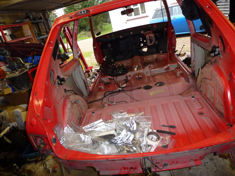

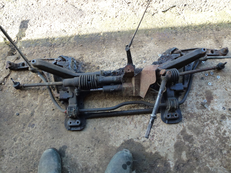

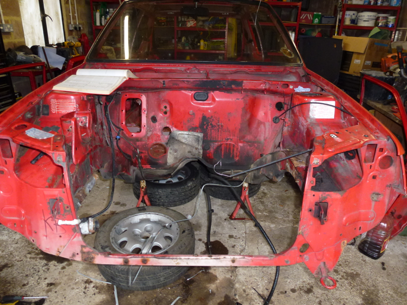

mrfirepro
latest update...
Engine out, front subframe out, all wiring out, rear beam out, nearly ready to start on bodywork

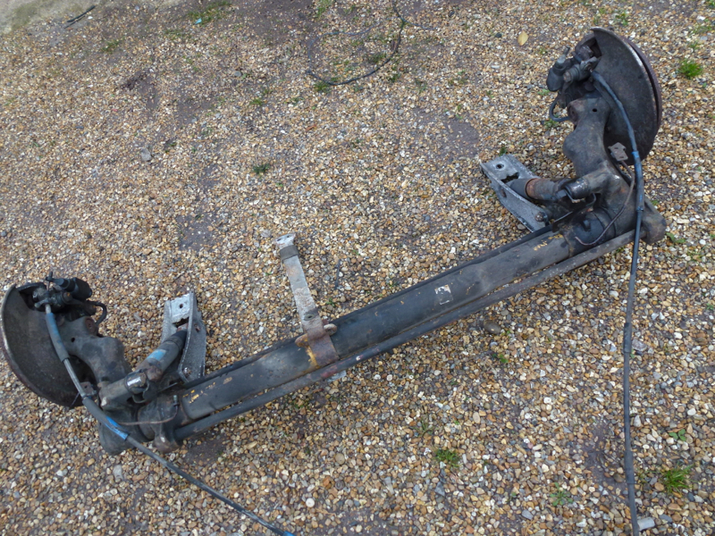

mrfirepro
Update...
Rear beam and front subframe removed
Fuel tank removed
Shell now totally stripped
Was going to acid dip and treat, but now going to look at Soda blasting
Whilst the shell is away going to...
Rebuild engine. gearbox, ream beam & front subframe
Send parts off to be powder coated or plated

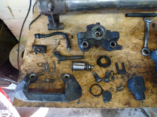

mrfirepro
Rear brakes stripped, found problem with the bolts, left side was different to the right side and the bolts were very different, same thread but different lengths and head size...wierd
You can see the short one here in the picture
