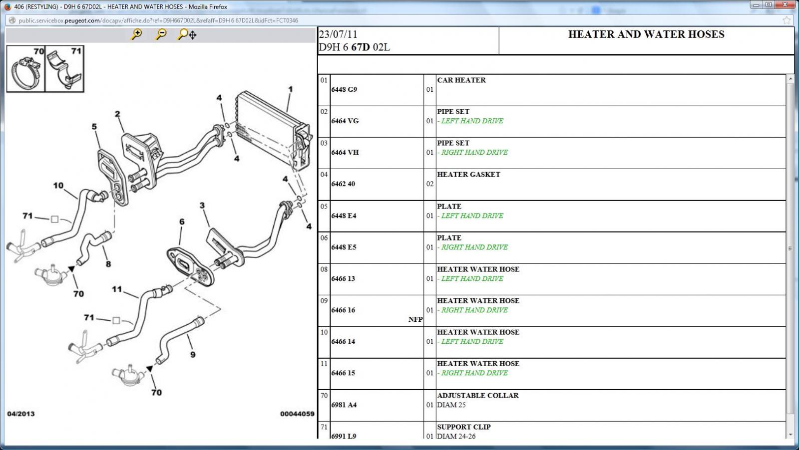

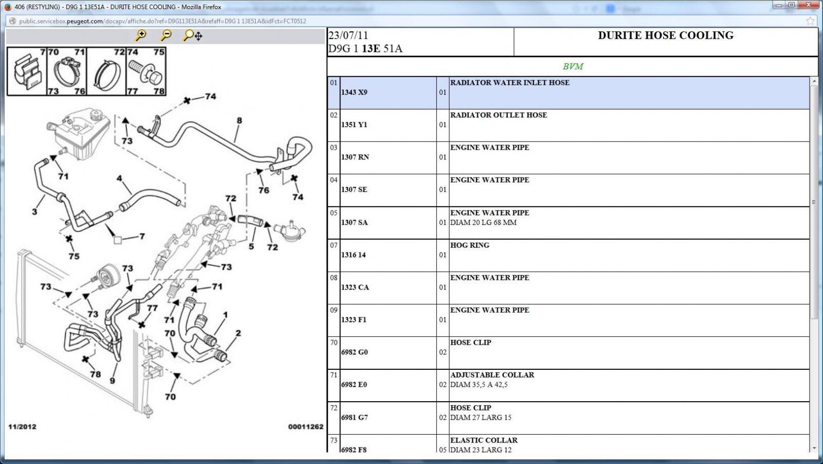

On service box images you can see there is no bleed pipe to the radiator it comes from the ball thing that the heater matrix connects to

While your pictures are nice and clear they don't exactly show whats connected to what apart from the radiator pipes. Can you show where the heater pipes are connected. Even service pox isn't super clear on the heater return.
