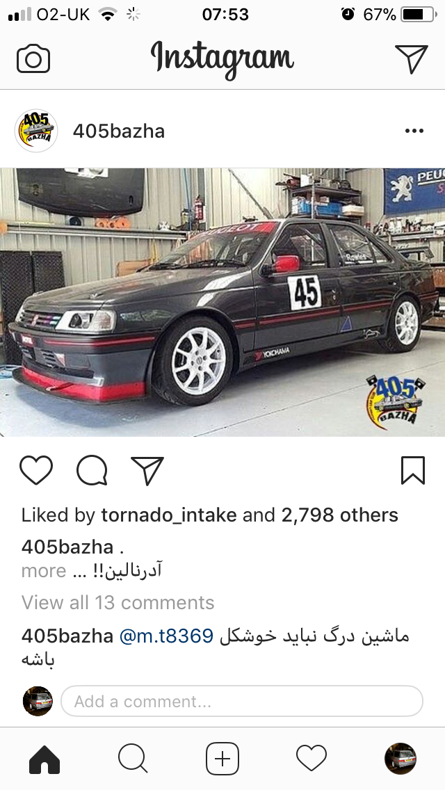

calvinhorse
Getting a lot of love on a Iranian 405 instagram page!!
IRISH_MI16
Getting love on both my pages too!
JeffR
Good to see. There's not enough love in the world these days.

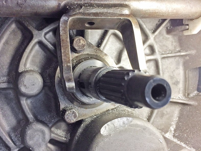

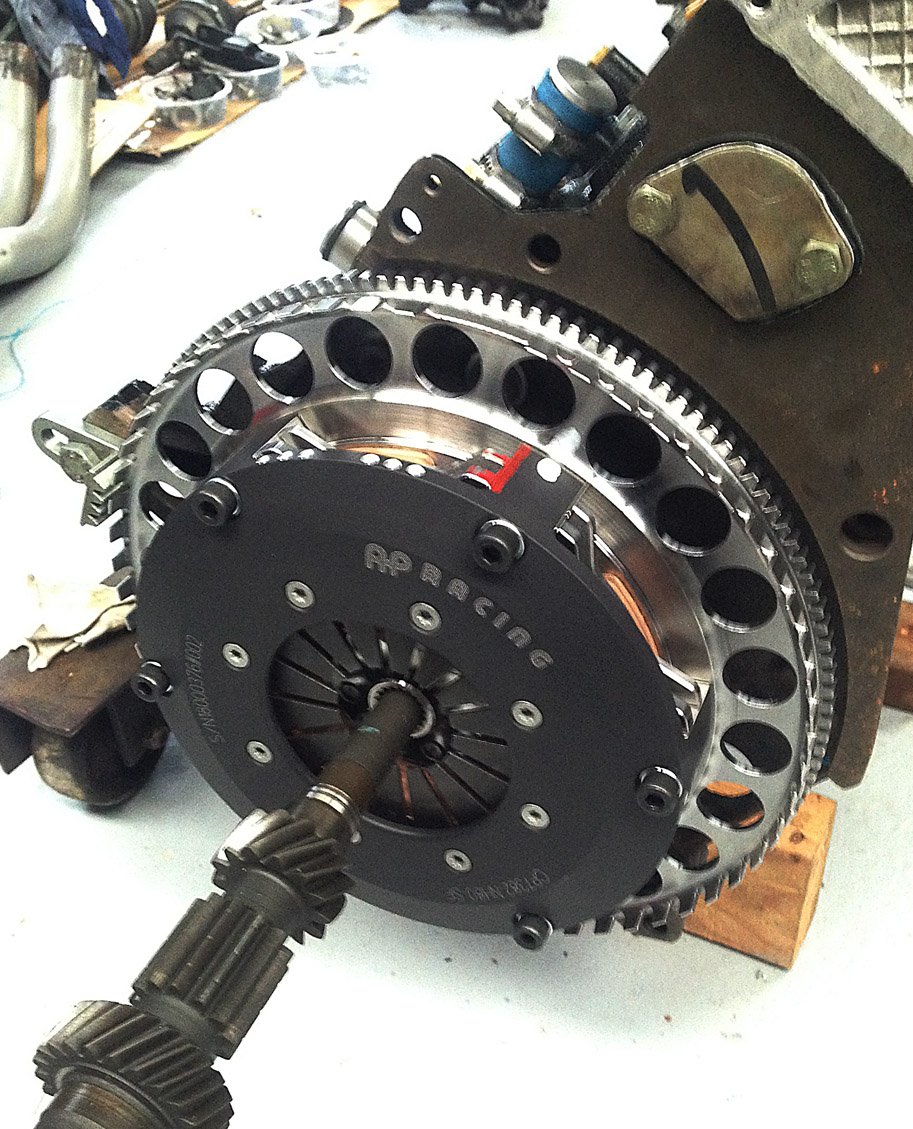

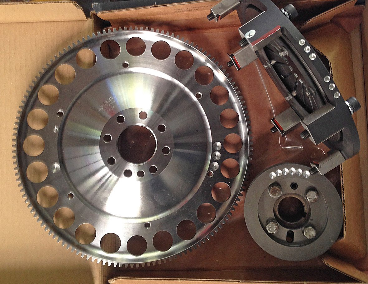

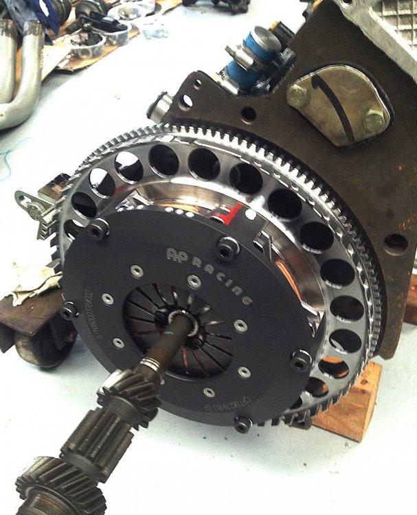

After waiting months for the clutch parts, the reassembly can finally begin.But first was to get the external rotating parts balanced which required quite a bit of correction.
I would have had no hope of lining up the twin driven plates without a spare input shaft. Still need to work out what pedal travel I'll end up with when the clutch is properly adjusted.
Hopefully reasonably straight forward from here.
