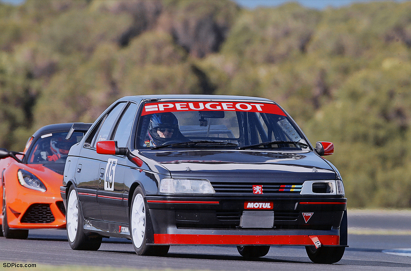

Took the car to Phillip Island last Sat for Rnd 7 of the MSCA SuperSprint series.
I was hoping that the new lca balljoints would have solved my vibration under brakes. Frustratingly no!
For the price of some tie rod ends that'll be the next 'fix'. I can't think of anything in the rack itself that could be the culprit.
Edited by JeffR
Looks and sounds great. I've entered a race meeting at Eastern Creek on Sunday. Not part of any series etc., just an opportune test day to try out new ignition parts and a new alternator.

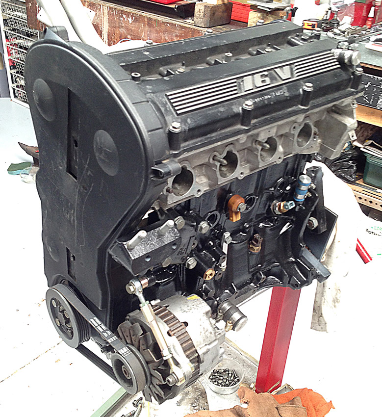

Meanwhile now the racing season is over it gave me the opportunity to remove the 10 year old 1.9 ready for it's 2.2 litre replacement. (J4RS block with squirters, 92mm diesel crank, Robson rods, Wiseco pistons, O-ringed block, XU9J4 head).

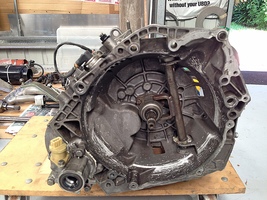

Upon separating the eng/gearbox, I found one of the outer clutch straps have fatigue broken and flayed around the bell housing before making its escape.
Fortunately, only superficial damage.
On order is an AP Racing twin plate 184mm clutch & Spooks 54mm release bearing combo with a custom flywheel to suit.

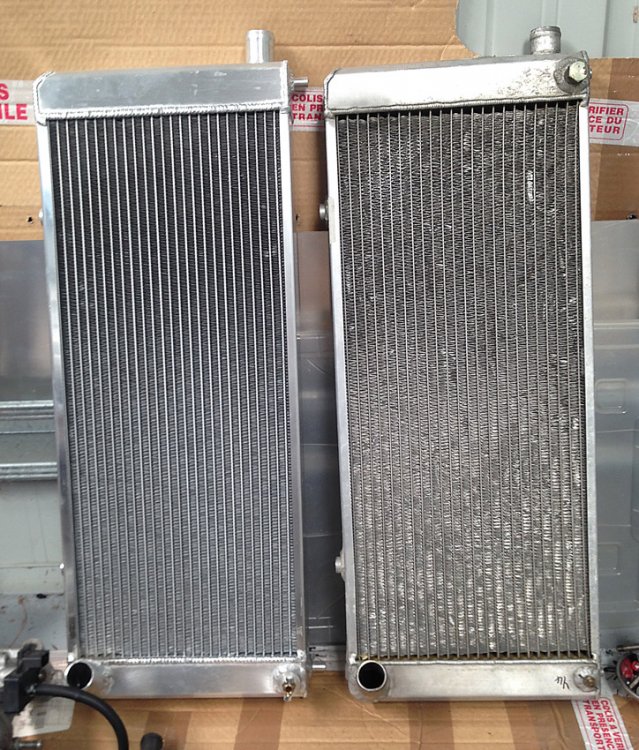

Also had a replacement alloy radiator made. Pleased I got over 10 years from the previous one but would no longer hold pressure.

speaksgeek
Did you get the radiator make locally? I need to get one made up soon.
JeffR
Yep local. Race Radiators, Bennet St Dandenong.
speaksgeek
Should I dare ask how much $$
JeffR
Not cheap but since I got over 10 years from their last one, decided to go with them again. You'll get change from $900.:o

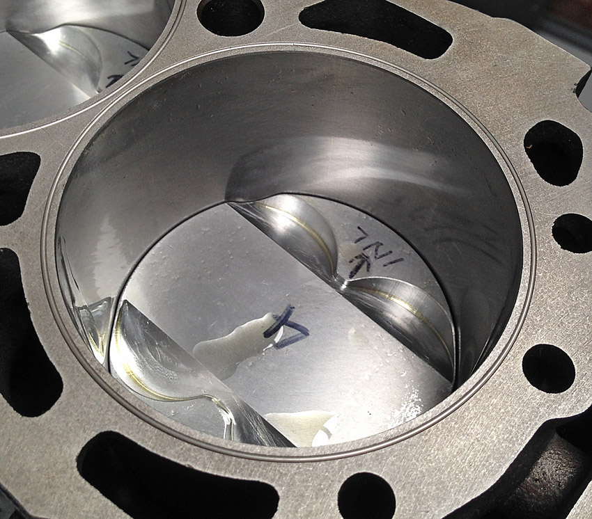

Those piston pockets look nice!
JeffR
With more CR than the 1.9, they're deep enough to run even bigger cams if necessary.
How much clearance did you end up with?
JeffR
In 0.227"
Ex 0.283"
with 1.6mm gasket

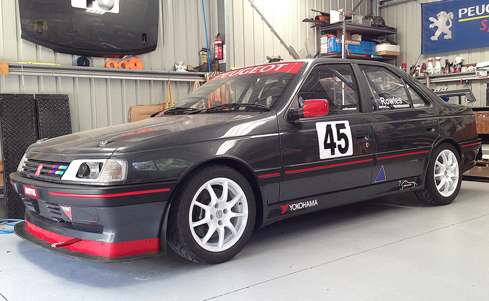

I used a product called Uniboard for the splitter/undertray., a combination of lightweight HDPE & Polypropylene in a 3 layer construction 12mm thick. When cut to shape it weighs 7 kgs plus 2kgs for the bracket. The end plates are 1.2mm aluminium.
The red strip is 1.0mm aluminium.
Rear wing is from Paul Radisich's '96 ex BTCC Mondeo.
