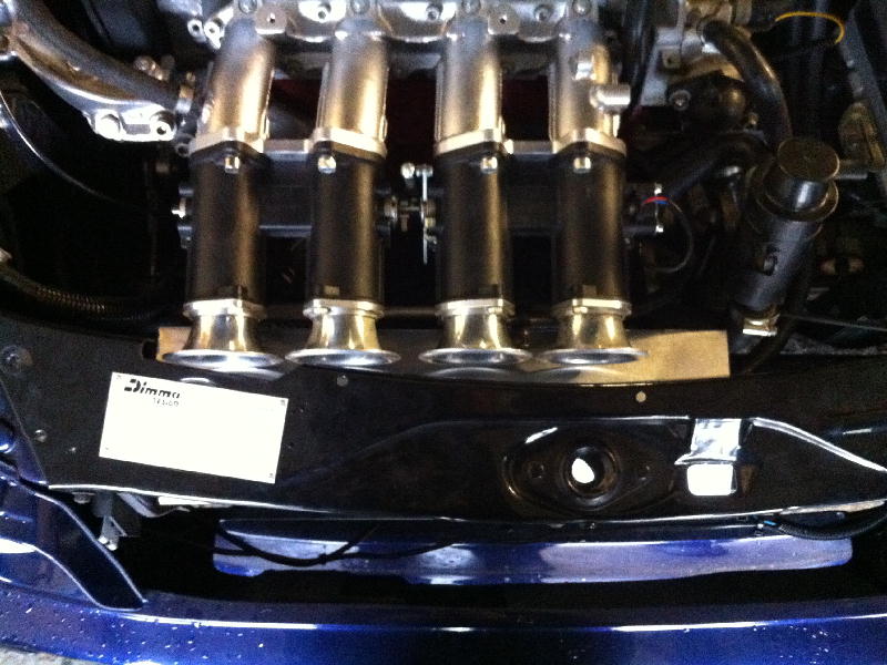

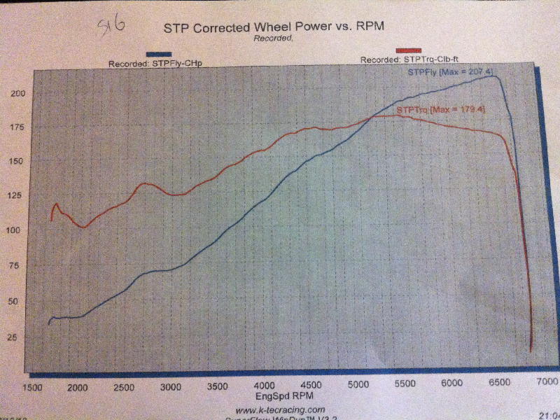

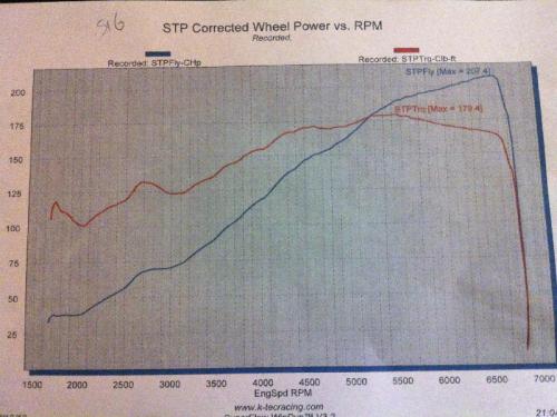

Finally got a pic of one of my Graph's, This is what I class as a easy budget build of a XU10J4 engine, Which is standard bar a recon head fitted 4 years ago.
1. Omex 600 ECU
2. 45mm Jenvey Bodies (Short trumpets due to no room)
3. Cat Cams 4900527
4. Long Inlet manifold (Thanks to Colin S)
5. GTi6 Injectors
6. My 4-2-1 Exhaust manifold and matching system
Nice power and torque figures, the torque surprised me most peak of
207 bhp @ 6800
179 ft lb @ 5600
As we know figures are just that, But having done quite a few car's here the figures are good, Example 3 std GTi's on bodies (Jenvey set ups) make 175bhp.
We could of got to around 210bhp I would think playing around with the timing but for the sake of a couple of BHP with time & £££ we left it as is and the limit is very safe due to the std engine format.
207 bhp @ 6800
179 ft lb @ 5600
89.5 ft lbs of torque per litre!!!!!! that's bloody impressive.

I'm doing a similar set up on a 306 over the coming weeks so it will be interesting to see the difference as the 306 has had head work, good or bad who knows yet.
It will have slightly longer trumpets over the 205 thou
