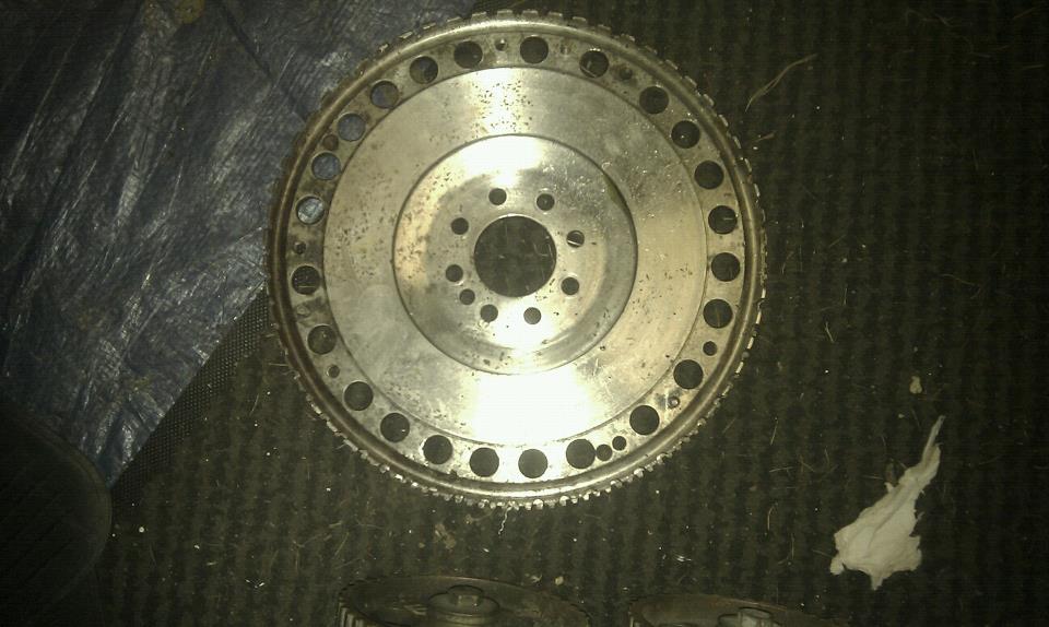

Will this do it?
I have both the 8v flywheel and the BE1 box from a 1.6 Gti
But i also got myself a S16 box from baz as i didnt really want to use 8v box
yup, looks like a TTV 215mm XU item.

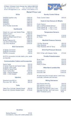

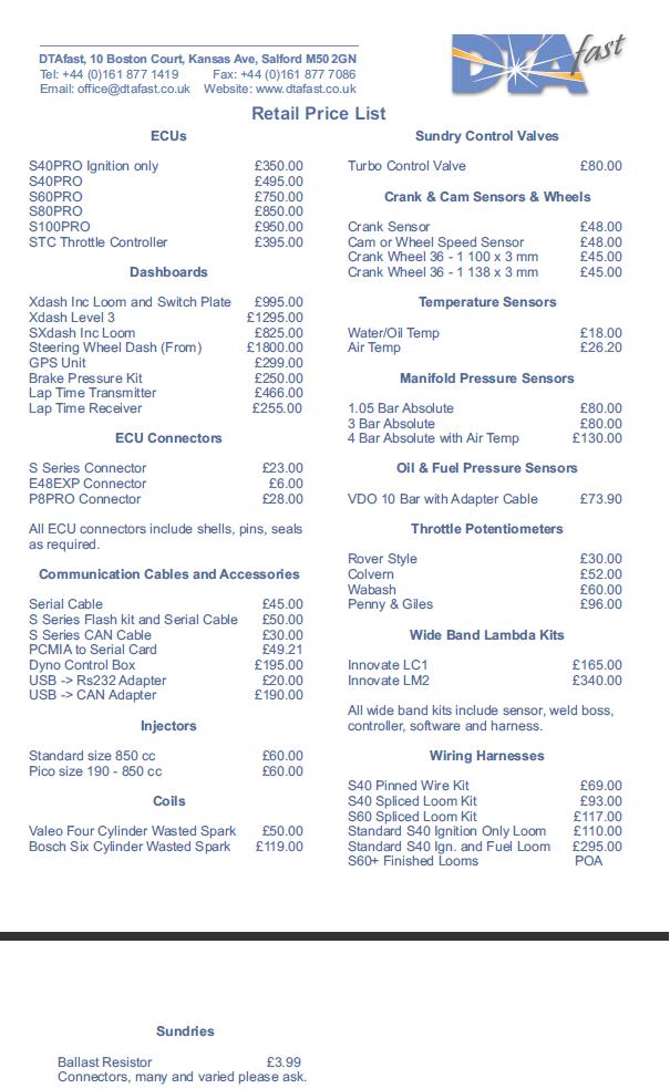

Here is the list of products from DTA
Lambda boss is the threaded part of the exhaust that the lambda sensor screws into.
Typically you'll need to drill a hole in the downpipe and weld the boss (like a thread nut) in place.
Most automotive places can probably get one, or there's various people selling them on eBay.
