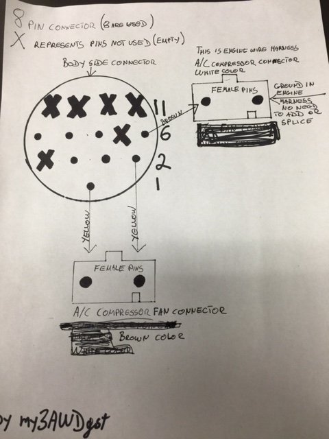

I apologize for bringing this back from the dead but I'm in need of information on smaller plug on GTI 6 engine harness.
Particularly I'm after A/C compressor input and engine-A/C fan inputs.
405's are using Birton sender and with out it engine cooling fans run at full speed at all times.
Thanks in advance.

Is this still a need? If so I can assist as I have a 205 with this loom and A/C. I can buzz out the pin, no Bitron unit though, thermostat on radiator is doing this for me,

I’ve got it done,thank you.
my3AWDgst
Not too pretty but easy to understand,
