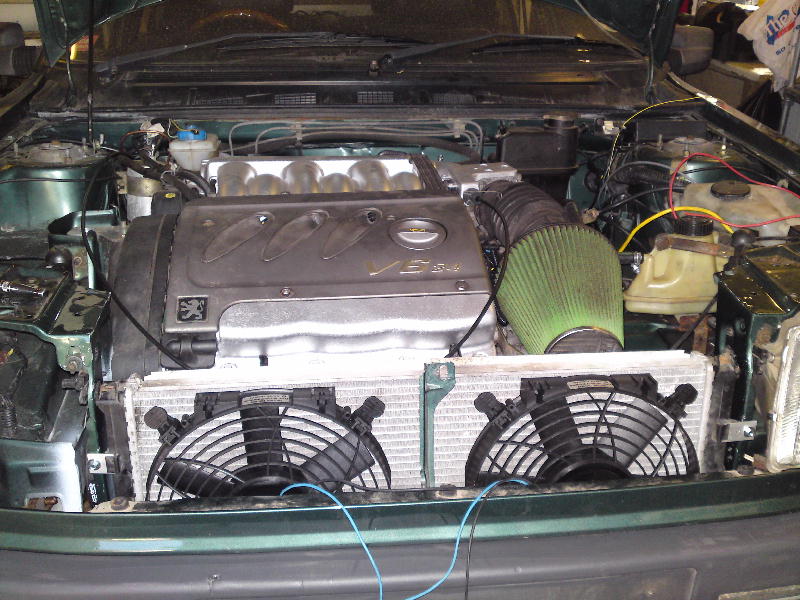

Well she finally run's, abit with no exhaust is rather loud.
Just a few more things to do and she'll be off to her new home
DrSarty
You ran a V6 with no exhaust manifold at 1.27am! :)
They're quieter and sooo much smoother than a 4 pot :)
LOL, Just when I got back in from work, She was running late afternoon when I remembered to bring my Laptop in

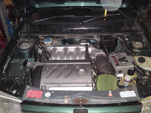

Saw this at Pugfest at the weekend. Looks like a really tidy conversion and fits the 309 engine bay so much better than 205 V6 conversions that I've seen - those extra inches make all the difference apparently.
Ground clearance is surprisingly poor given how high the rest of the car is sat though (standard springs), and I'd imagine that the sump and front downpipe will have a fair few scrapes from speedhumps and the like after a few months! Doesn't look to be a great deal that you can do about it though, atleast that I could obviously see.

Just collected her from having the exhaust made up, Nice system and sounds spot on even thou the maps wrong, Just like the OE one so no silly tailpipe sticking out the back.
All finished and ready for mapping which should be in a week or so's time, Be good to see how much power we get
