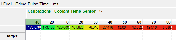

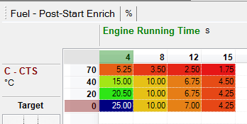

petert 616 Posted January 26, 2013 Here's some settings from my car if they're any use to you. I've never tested under 5 deg C however. Share this post Link to post Share on other sites
