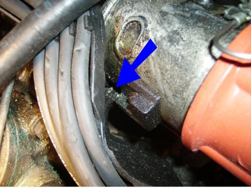

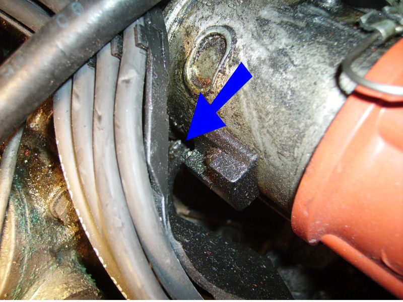

CaptainP 2 Posted November 30, 2008 I think that my intermittant starting problems maybe down to the cable which connects the distributor to the ignition amp. It seems to have gone very brittle and has seen better days. I've had a look through the forum and the pics I've found of this cable look different to mine (I have a Bosch distributor if that makes a difference?). How does this cable disconnect from the distributor? I can see a screw on a black block that go's into the distributor - does that all come off with the cable? Also, can you still buy these new or am I looking for a 2nd hand one? Cheers Steve Share this post Link to post Share on other sites
welshpug 1,737 Posted November 30, 2008 (edited) yep, just undo the screw and unplug the wire, about £20 from peugeot I think Edited November 30, 2008 by welshpug Share this post Link to post Share on other sites
