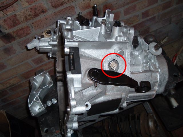

RAF_gti 0 Posted October 28, 2008 ...yet another problem. My reverse light isn't working, I've checked the bulbs and they are fine and also the pins in the fuse box and they are showing no continuity. Where can I find the switch on an '89 1.9? Haynes is as helpful as ever! thanks (again) Share this post Link to post Share on other sites
Ryan 99 Posted October 28, 2008 It's screwed into the gearbox near the top/front. Share this post Link to post Share on other sites
RAF_gti 0 Posted October 28, 2008 What is the best way to access it? thanks Share this post Link to post Share on other sites
Ryan 99 Posted October 28, 2008 I think if you remove the airflow meter and the hose on the throttle body then it should be easy to get to. Share this post Link to post Share on other sites
RAF_gti 0 Posted October 28, 2008 I think if you remove the airflow meter and the hose on the throttle body then it should be easy to get to. Brilliant, thanks for that. Lovely shiny box you have there as well! Share this post Link to post Share on other sites
Ryan 99 Posted October 28, 2008 Lovely shiny box you have there as well! It's not mine, it's just a picture I had saved. I didn't have the patience to clean mine like that. Share this post Link to post Share on other sites
DrSarty 113 1 Cars Posted October 28, 2008 (edited) Don't expect your gearbox to have a bright red circle ringing the reverse switch for you though Steve me old crab airways mucka. That's just like buying some cheese from Tescos that has a picture on the packet of some tasty cheese on toast with a slice of juicy tomato and a dash of zingy Worcester sauce on it saying 'serving suggestion', just in case you got disappointed there was no bread, butter, tomato, sauce, plate, knife, fork and table in the packet as well. Just trying to manage your RAF expectations. Edited October 28, 2008 by DrSarty Share this post Link to post Share on other sites
