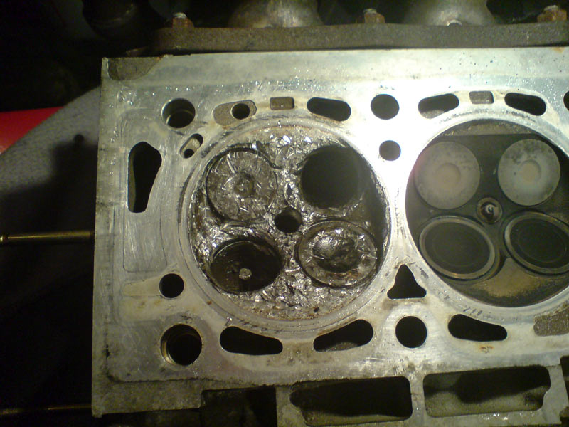

smighall 1 Posted May 26, 2008 Old engine may well have failed due to a broken spark plug. I've heard of a few of these causing failures with GTI-6 lumps now. Share this post Link to post Share on other sites
16v205 9 Posted May 26, 2008 Never heard of this with the 6's before? You got any idea what make or model plug may have failed? The plug was mashed but I put this down to shrapnel in the chamber. Rich Share this post Link to post Share on other sites

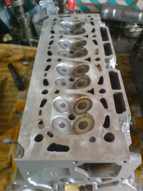

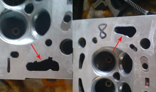

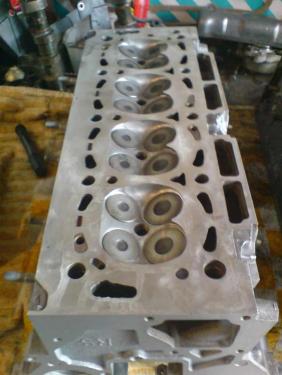

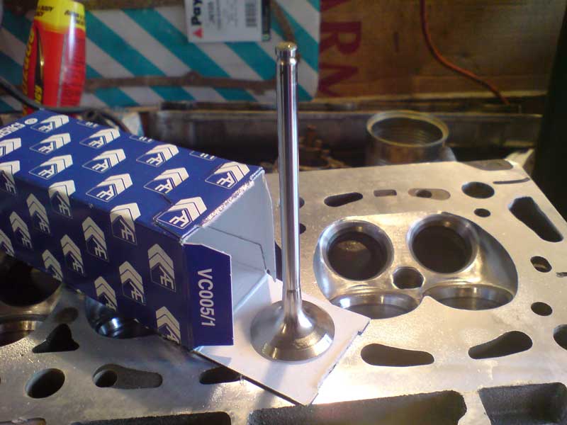

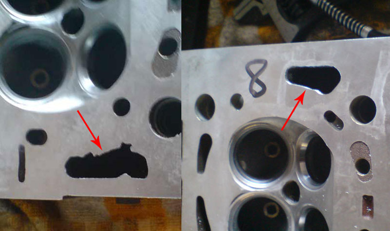

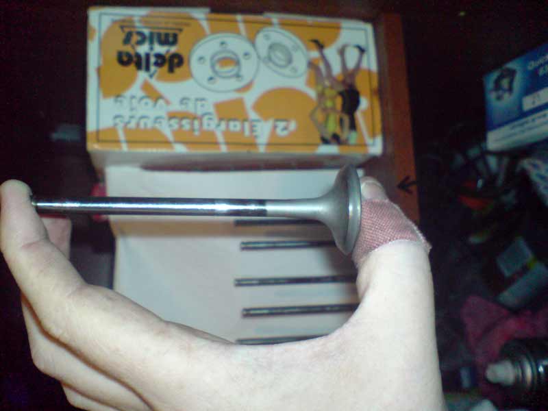

16v205 9 Posted May 26, 2008 Gti-6 Head as it came back from QEP, Had to open up the returns from the head after it was skimmed, there was a lot of material pushed across the return holes. All the valves taken out, these had to be removed as the cams dont rotate in the head without taking some material out. Im glad I did remove them though as I found my old exhaust valves had been returned to me by mistake. Not nice shiney new ones. It only took a few days for QEP to sort me out a new set. They managed to get me 8 new exhaust valves on a Saturday delivery to replace the ones sent back to me by mistake. Share this post Link to post Share on other sites

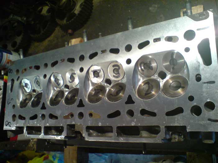

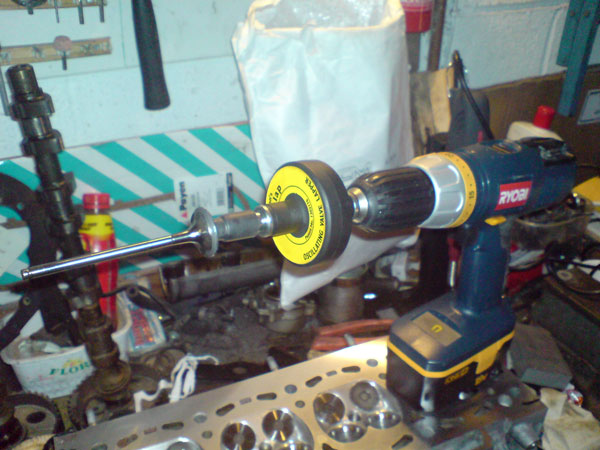

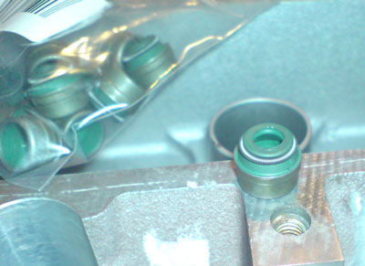

16v205 9 Posted May 26, 2008 Had to lap the new valves into the seat to make sure they were going to seal properly, QEP said the head retained the standard 45 degree angle. I measured the seat contact area on the used valves with a caliper and made sure the new lapped valve had the same size contact ring. I didnt use a traditional tube with rubber plunger to do this, I went a bit posh and used a gunson ezi lap thing. Was nice and easy this way, no more swollen palms and hours of frustation as the plunger falls off the valve with a hand lapper. Also takes a fraction of the time to do each valve. With all the valves lapped the head had another good jet wash. I then started to fit new valve stem seals. It was a pain in the arse to remove the old ones, they seemed to just fall apart rather than come off the guide. Took about 1 1/2 hours to get them off and 10mins to put the new ones on. All the valves are marked so they go back in the same place, didnt want to start getting these mixed up as each valve is ground into its respective seat. Ive lightly lubricated the valve stems with a bit of moly grease. Share this post Link to post Share on other sites

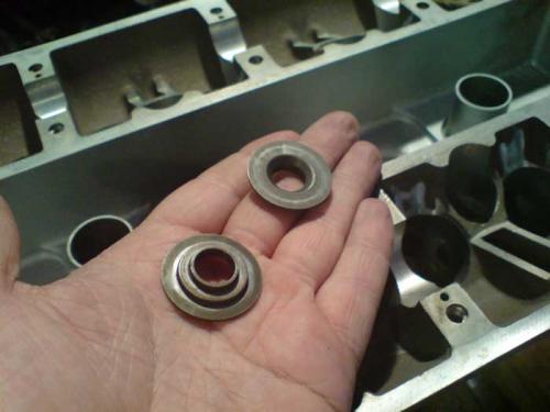

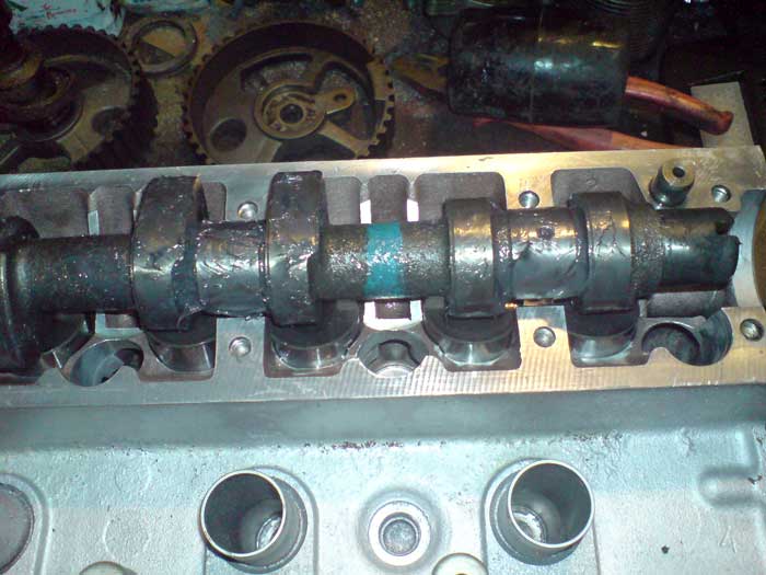

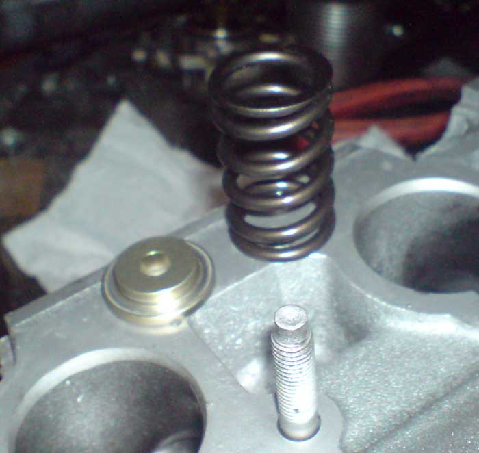

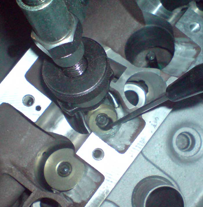

16v205 9 Posted May 26, 2008 Catcams Single valve springs and retainers Shaped washers for under the valve springs when installed in the head. Valve springs being installed, if you put a little grease on the top of the valve stem the collets will stick to it and not fall into the head Share this post Link to post Share on other sites

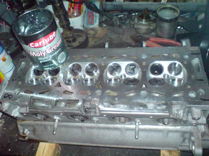

16v205 9 Posted May 26, 2008 The valves all installed and looking erm shiney Cams coated in moly grease. I prefer to use moly grease on the build where I can as normal oil will just run off leaving the metal surface without lubrication. The engines going to be rotated a few times without a oil feed whilst timing it up so it should offer some protection Share this post Link to post Share on other sites
Doof 11 Posted May 26, 2008 Are those valve stem seals just standard fitment etc? I just ask as my new head has green ones like this whereas all the ones i've bought from pug have been orange / red...just wondering if they're a different spec? Perhaps the '6 ones are green and Mi ones red actually... Share this post Link to post Share on other sites

16v205 9 Posted May 26, 2008 Are those valve stem seals just standard fitment etc? I just ask as my new head has green ones like this whereas all the ones i've bought from pug have been orange / red...just wondering if they're a different spec? Perhaps the '6 ones are green and Mi ones red actually... Yeah mate just standard stem seals that came in the head gasket set. I think the headset make is BGA or similar, the ones that came off the head were also green. Share this post Link to post Share on other sites

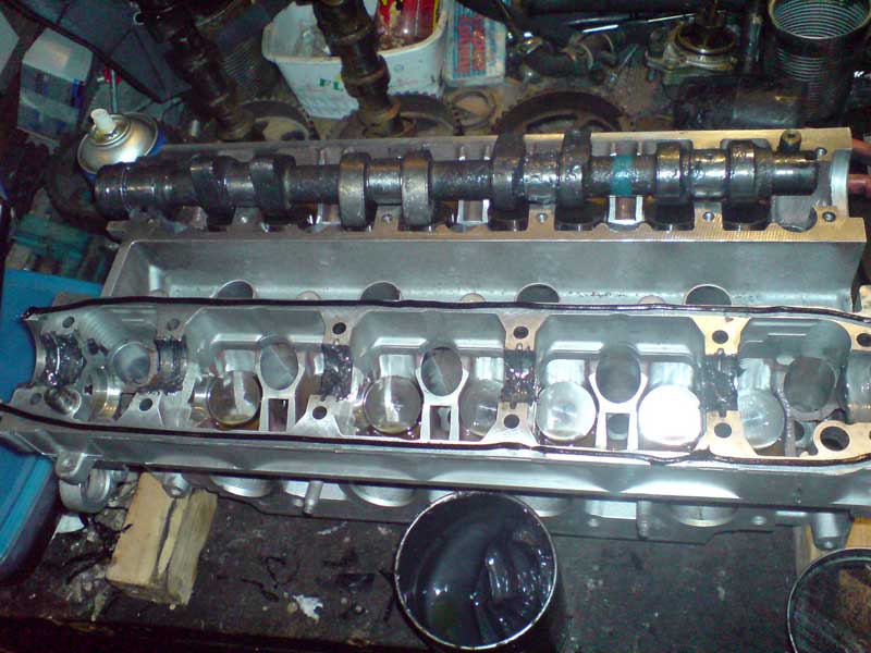

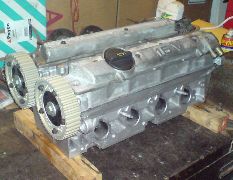

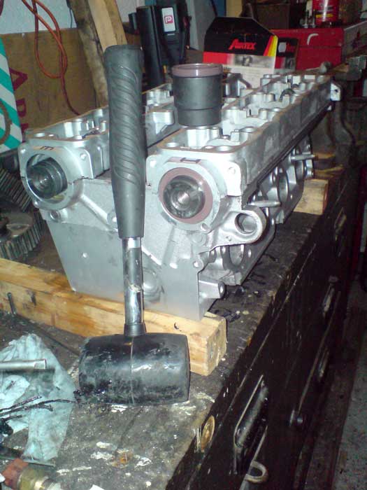

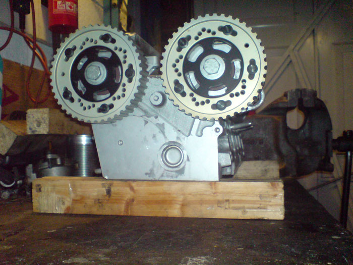

16v205 9 Posted May 26, 2008 Tappets installed. They've been checked drained and sat in oil for the past few weeks. RTV sealent added to bearing caps and more moly grease on the bearing surface. The heads supported on a few blocks of wood as when the caps are tightened down the valves may protrude beneath the head. Bearing caps tightened down and camshaft seals tapped uniformly into place with a rubber version of Anthony’s favourite persuading tool and a 36mm socket. Catcams verniers fitted Share this post Link to post Share on other sites
16v205 9 Posted May 26, 2008 Picture of the finished head Ive a spare set of rocker covers that I may clean up and fit instead of these dirty ones. Just depends how tarty im feeling Share this post Link to post Share on other sites

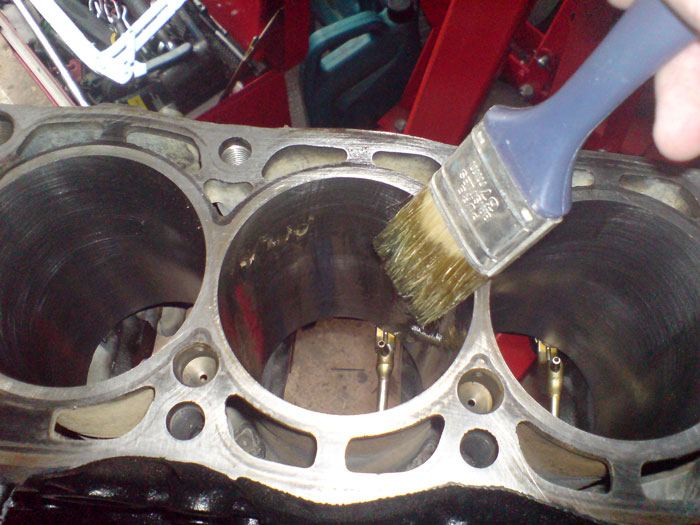

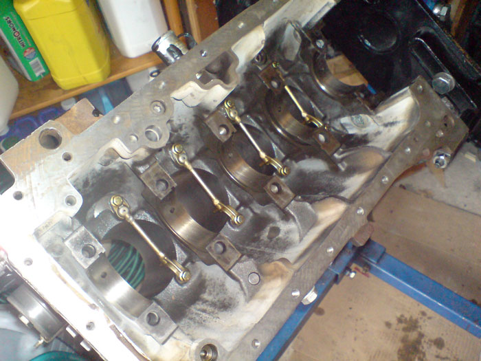

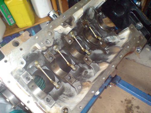

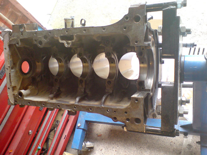

16v205 9 Posted May 26, 2008 Bare Gti-6 block thats been bored to 88mm and chemically washed. I had it washed to clean all the crap off it so it wasnt dirty to handle and also remove the dirt and oil from the threads so stuff I threadlock in place should hopefully stay there. Under piston spray bars. The 4 on the left are good, the one on the right which came from this block was faulty. Im assuming its a spring and ball bearing setup that is stuck open as I cant see an easy way of dissasembling them, but anyway it was open to light pressure both ways. You could even blow through it. Piston spray bars fitted. I used a little threadlock on these to make sure the bolts stay put. Share this post Link to post Share on other sites

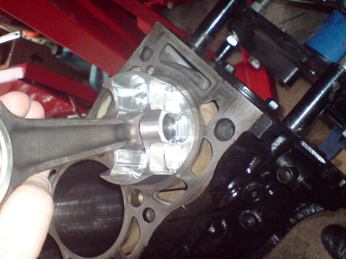

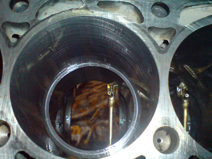

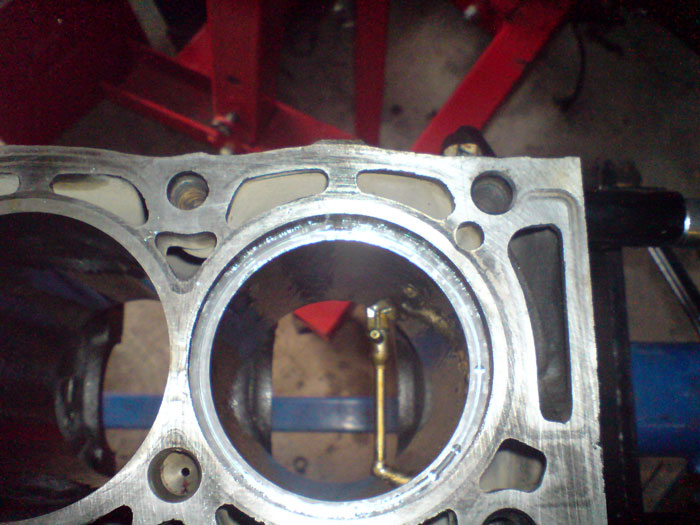

16v205 9 Posted May 28, 2008 Picture wise it doesn’t look like I got a whole lot done yesterday, I spent the afternoon and evening gapping the rings which took hours. The wossner rings for this build had less than 6 thou gap when inserted in the bore so a fair bit of fettling needed to be done. I had a spreadsheet that Andy @ BB Performance emailed me regarding ring gaps. I settled on 0.38mm 1st ring, 0.43mm 2nd ring and 1.32mm oil control rings. Lubricating the bores before starting to work on it. Hopefully it they wont go rusty in the garage while im getting this built Top ring in place at the top of the bore, theres only 6 thou (0.15mm) gap. Use the piston the straighten the rings in the bore and also to move them down to the centre and the bottom of the bore to re-measure the gap. Wear and taper should'nt be a problem on a newly bored cylinder but still worth checking. Share this post Link to post Share on other sites

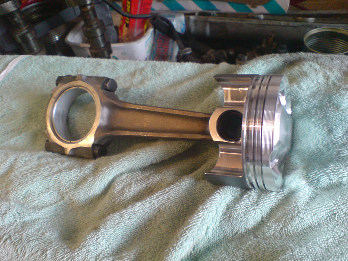

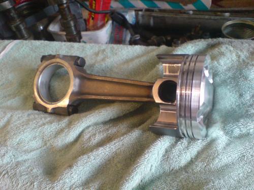

16v205 9 Posted May 28, 2008 Correctly gapped ring, you can just see the gap at the top or the ring. Sexy piston shot I dont want to put these in there to get all dirty Share this post Link to post Share on other sites

16v205 9 Posted May 28, 2008 Theres no target figure at all, im going to swing the cam timing at emerald and play with the induction length but its just going to be what its going to be really. Id like to stay above 200bhp and have a decent torque spread. As for the belt cover Anthony also mentioned this yesterday to my gf (cowbag as she's known) on msn, ive cut and chopped it a little to make it fit with the cam pulleys on. I like to be able to take the cams out complete with verniers attached if need be. The covers will be fitted and complete on the engine stand before its swung into the car. Share this post Link to post Share on other sites
