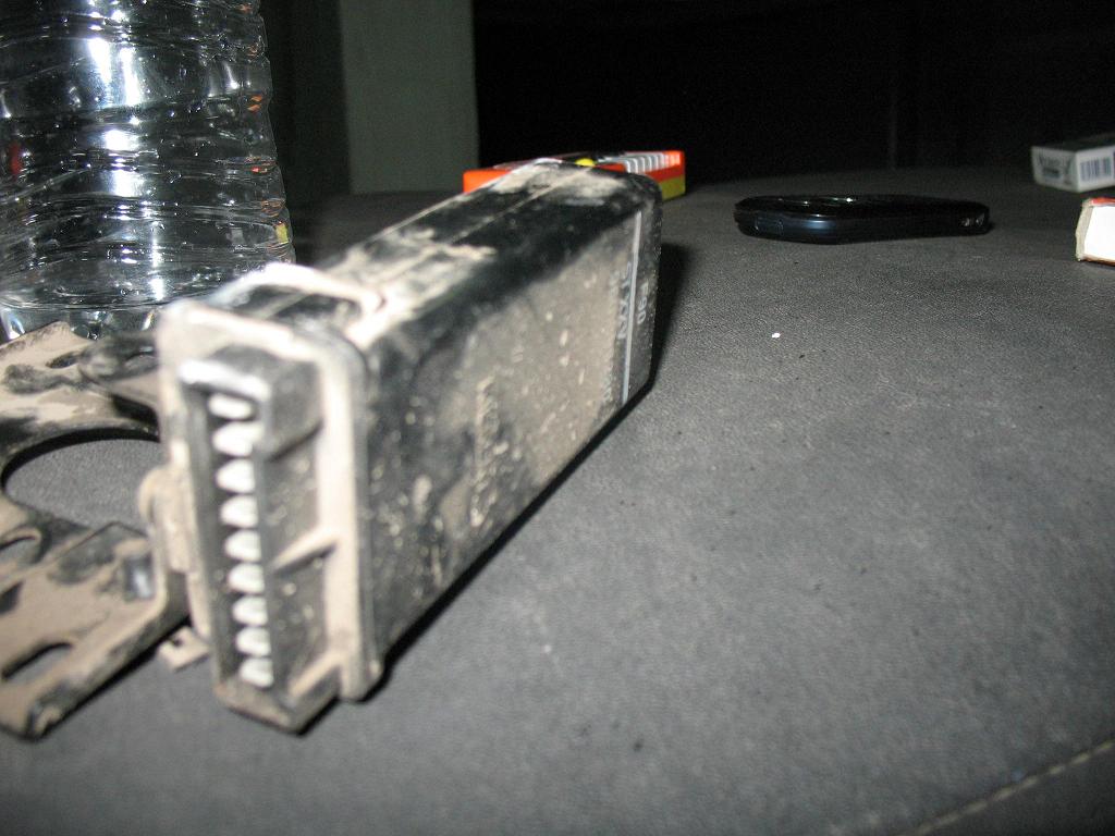

ifcho 0 Posted May 24, 2008 This was under the dash of a car I'm stripping to bits... Its a 92 205 1.9 gti, with aircon (not many parts were left from it unfortunately Anybody know what it is? And the second question...now that I have a heater unit from an aircon car...how hard would it be to retro fit an aircon. I think I need the following parts: 1. compressor (should be easy to find one from a XU engined 306/406, etc?) 2. radiator - (again I can fit any suitable radiator, does not need to be from a 205?) 3. condensor/dehidrator (I'm not sure what this part does, but again, anything that fits in a 205 engine bay should be OK? 4. freon pipes? 5. Dash control? Is there anything specific for the 205 aircon dash control? Can I take one from a 405 for example? Share this post Link to post Share on other sites
welshpug 1,723 Posted May 24, 2008 clean it up a little and see if there is any writing, might just be a Central locking ECU Share this post Link to post Share on other sites
KRISKARRERA 2 1 Cars Posted May 25, 2008 Yeah that's the central locking thingy Share this post Link to post Share on other sites

GLPoomobile 958 Posted May 25, 2008 Yeah that's the central locking thingy That is word for word exactly what I just thought out loud to myself! I can never remember what it's called. Share this post Link to post Share on other sites
KRISKARRERA 2 1 Cars Posted May 25, 2008 Me neither. All I know is if you keep it in your car and talk into it now and then you can look like Bodie and Doyle in the Professionals! On the Mi16 there's 2 places the aircon tensioner pulley can go - either on the sump or on the spindal bits at the bottom of the block where the alternator adjustor slider thingy is mounted. The latter is preferable in my opinion. Also on the Mi16 they didn't use a solenoid in the throttlebody, instead when you switch on the aircon the bitron ecu tells the main ecu and that increases the idle. Shame really that it doesn't cut off on full throttle, that's quite a useful thing to have for full throttle. Share this post Link to post Share on other sites
