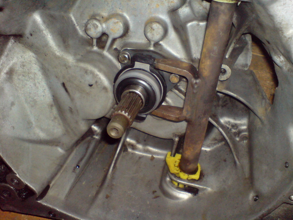

gtimon 0 Posted May 19, 2008 (edited) I've done a search for a clutch problem I have. Seeing the Pic of the clutch set-up and the above comments. My problem seems that the lever through the BellHousing is sitting out of line with the short rod you describe. I can move the lever to make the rod inline, but when the clutch is operated it suddenly jumps back out of line. Then I can't get any gears. Is there a fault inside the BellHousing with the lever or a fault with the rod ?? Any more Pics of the lever where it engages the thrust bearing. ?? Like this one: But this is not the clutch system I have. Thanks Edited May 19, 2008 by gtimon Share this post Link to post Share on other sites
