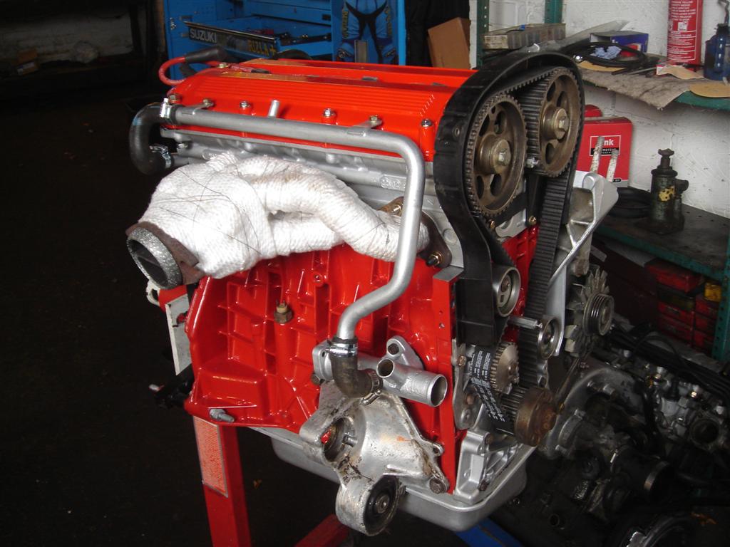

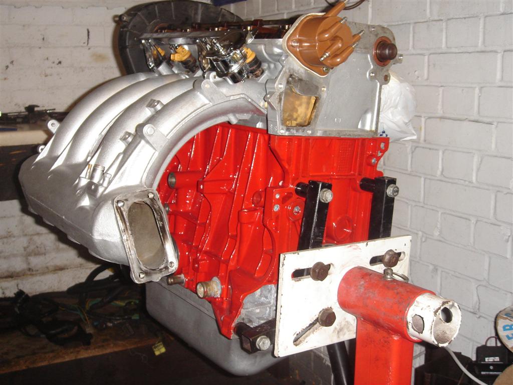

dean 0 Posted April 22, 2008 do you have any pic of any of the engines you have painted Share this post Link to post Share on other sites
Rom 0 Posted April 22, 2008 (edited) Yeah sure... Edited April 22, 2008 by RKKRom Share this post Link to post Share on other sites
