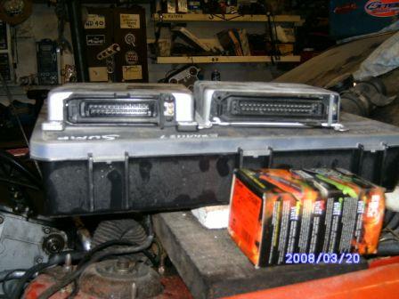

sutol 0 Posted March 20, 2008 Are the Motronic and Jetronic ECUs vastly different ? I have a BX Motronic ecu and it has 10 pins more than My 1.9 ecu so it's no use ...I was going to run the Mi with it The one on the left is 1.9 and right is BX both Bosch. Have I bought the wrong ecu ? or do I have to wire the pins up instead of a plug. Completely new to ecus and begining to think carbs and dizzy might be a plan Any help appreciated as project halted. Share this post Link to post Share on other sites
welshpug 1,737 Posted March 20, 2008 you need the loom that goes with the BX ecu (one from a 405 Mi16 will do the job as long as its for the same ecu type) Share this post Link to post Share on other sites
sutol 0 Posted March 20, 2008 you need the loom that goes with the BX ecu (one from a 405 Mi16 will do the job as long as its for the same ecu type) Thanks for that ( I was told that this was easy ) , looks like a day looking round scrapyards is called for. I'll get on with fitting driveshafts and piping the waterworks up first then . Share this post Link to post Share on other sites

2-Pugs 57 Posted March 20, 2008 cybernck has it pretty much covered. If your car has grey carpet, with the exception of the 1990 limited edition models, it has (or had) a cat fitted. Motronic was, I think, fitted to better control the catalysed engine, so it's really only found on catalysed cars. Otherwise, (I am working from memory so I may not be accurate) Motronic ECU has three rows of pins instead of Jetronic's 2 Motronic Air flow meter has no hex-head mixture adjustment screw Motronic Distributor has no vacuum advance device on it A motronic car runs nicely from cold, jetronic can have the familiar hunting problem at idle Given it's age, I'd expect it to be Jetronic, as the cat was an expensive option at the time, and they did not become mandatory until 1993 I think. Share this post Link to post Share on other sites
sutol 0 Posted March 20, 2008 Given it's age, I'd expect it to be Jetronic, as the cat was an expensive option at the time, and they did not become mandatory until 1993 I think. I think your right, trouble is I've bought a Motronic BX ecu....... Share this post Link to post Share on other sites
petert 641 Posted March 26, 2008 I think your right, trouble is I've bought a Motronic BX ecu....... So what's wrong with that? Is it from a 16V? If so, just buy a matching Mi16 loom. Share this post Link to post Share on other sites
