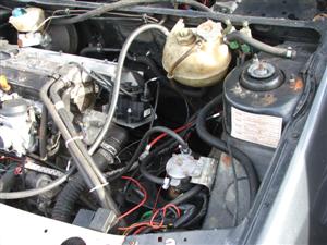

Bakes100 20 1 Cars Posted January 29, 2008 Hi Does anyone have any engine bay pics of a gti6 engined 205 with the battery in the boot?? As im thinking of doing this in mine due to the lack of room and i was wondering how people mounted the ECU and other items when the battery box wasnt present. Thanks Share this post Link to post Share on other sites

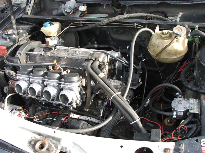

felix2566 2 Posted January 29, 2008 Here is a picture of my 309 with a gti6 engine and no battery in the bay. Its not finished, but you get the idea! Share this post Link to post Share on other sites
Bakes100 20 1 Cars Posted January 30, 2008 Thanks mate, Where are u going to mount your ecu??? as i was thinking of maybe chopping the original battery box part off, leaving the ecu in its casing and mounting the ecu flat on the original battery mount as im not keen on having the ecu unprotected. Cheers Share this post Link to post Share on other sites
felix2566 2 Posted January 30, 2008 (edited) Not sure yet to be honest, havent got that far, sorry! But what you are suggesting sounds like a good idea. Edited January 30, 2008 by felix2566 Share this post Link to post Share on other sites

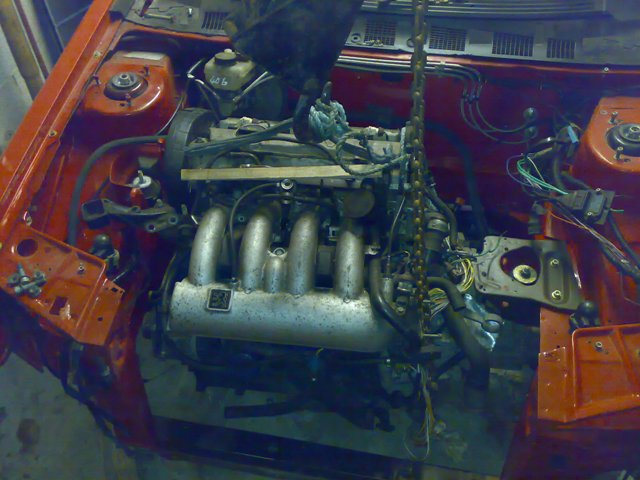

pip470 63 Posted January 31, 2008 Here are some pics of my engine bay with the 1.8 16v engine fitted. Im sure its the same dimensions as a gti 6. Share this post Link to post Share on other sites
