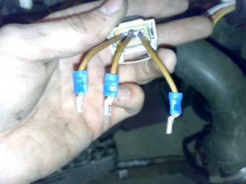

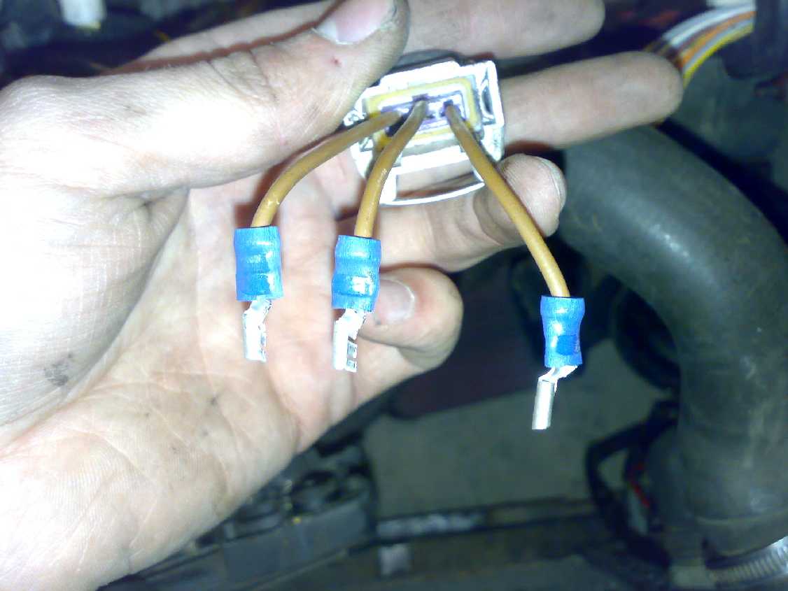

you'll need to join the Inertia switch wires, without doing so your fuel pump + lambda sensor wont have power!
IIRC the Diagnostic socket will have wire 140 White and 141 green, coming from ECU pins 31 and 12 respectively.
felix2566
Cheers WP, will get them joined up tonight. I suppose that is why whe the ignition is on the fuel pump is not on (?). It works when connected directly to +12v.
d-9
The GTI6 will almost certainly only turn the fuel pump on when the engine is turning over, so its nothing to worry about (although you're right, the wires do need connecting together). You might hear the ecu prime the pump when it turns on thou.

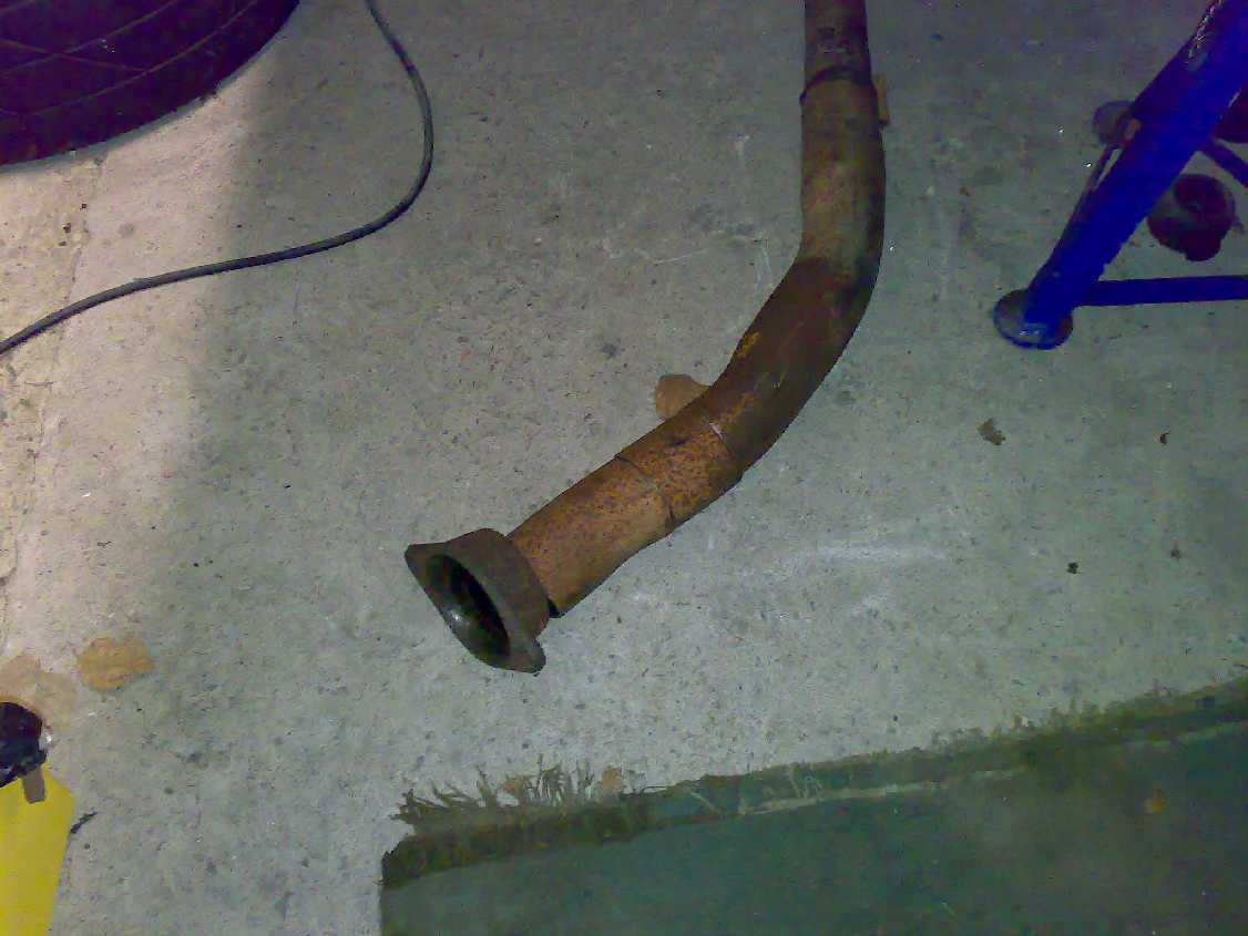

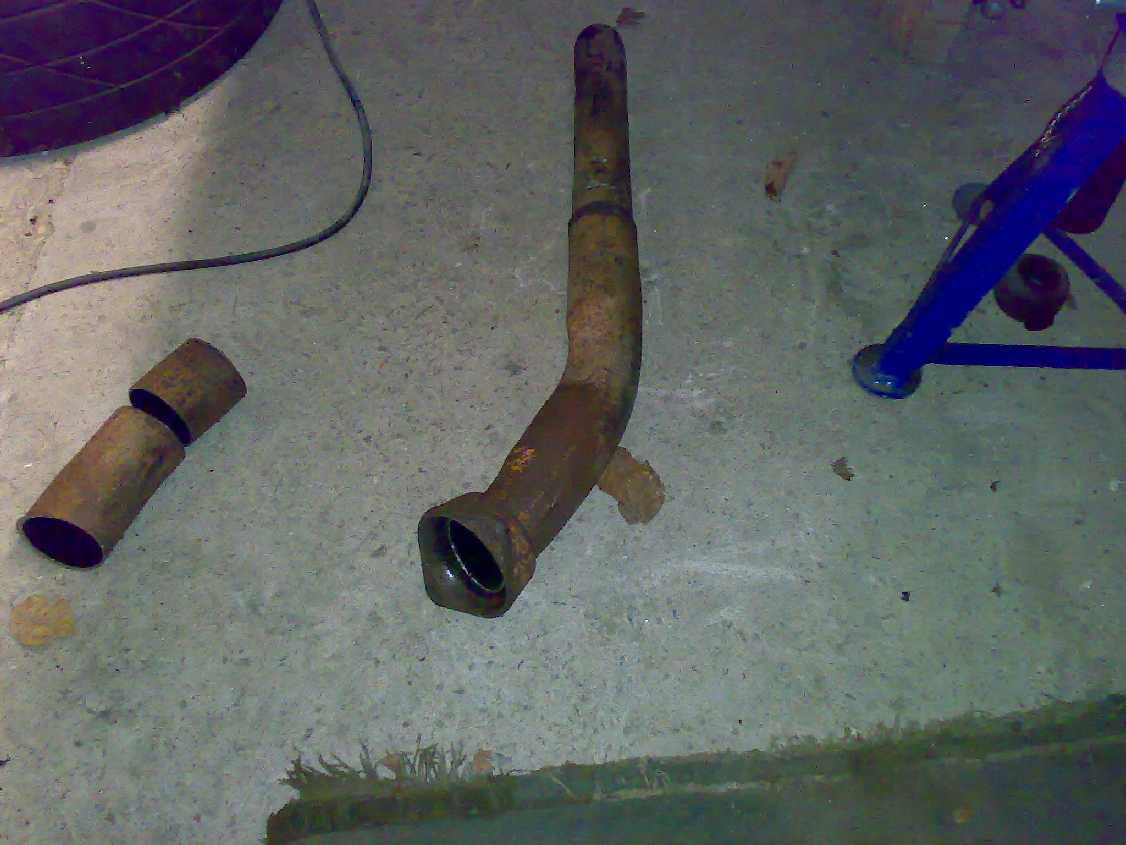

have been working on the exhaust, the exhaust that was on the car was a bit of a bodge so bought a used OMP one of ebay. It is supposed to be for a 309. The shape is pretty much correct, but the hangers seem to be all out by a bit, I think it is because it mating to a 6 rather the original engine. Not to worried about that though. Have cut off the old ones and will weld on soem new ones. Have cut the down pipe so that it all fits well. Might have a bit more of a bend put into it to give more clearance between it and the rear beam.

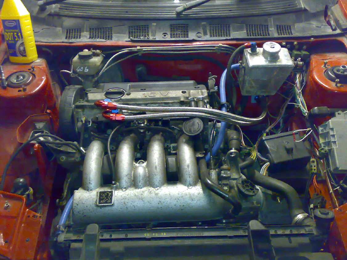

Managed to get the engine fired up properly for the first time on Saturday!! Was so excited! Could harly beleive that after all this time it really all works!
Couldnt run it for very long, because i didnt have any cooling sysetem, soon sorted that out and now it runs fine. Appart from the small fact that it doesnt have any exhaust so its a bit loud!

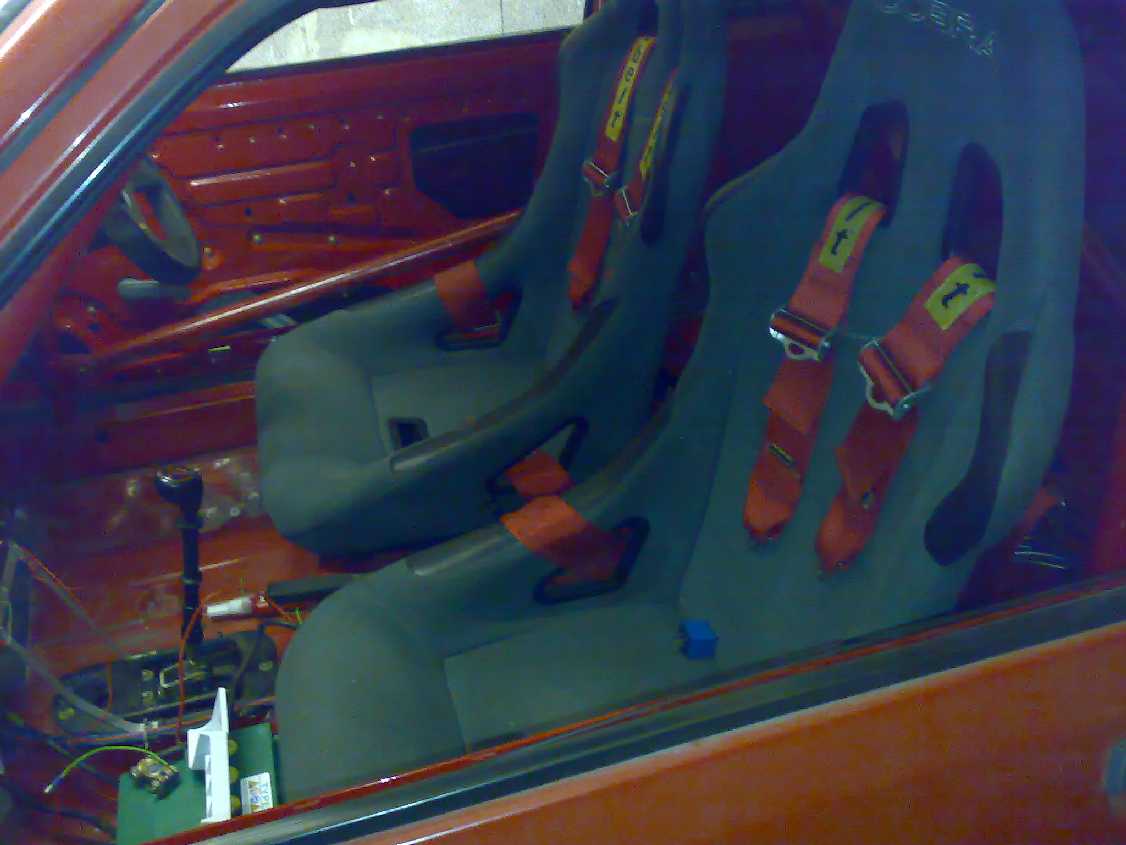

Also for the my seat fitted, looks a bit more car like inside now.
The only problem that I have is that when the ignition is on and the engine is being turned over the fuel pump is not running. I had to wire the fuel pump directly to the battery to get the engie to work.

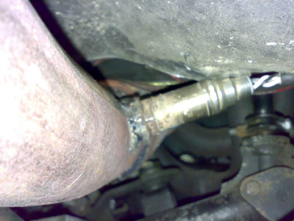

Exhaust is all done, brackets welded on, lambda sensor in. I am hoping to MOT it next week. That is assuming that every thing goes to plan!

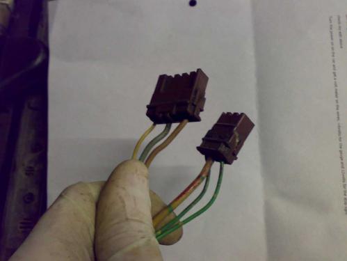

I have attched a pic of some wires that come from the cooling fan loom are they all earth wires, that is all I can think that they are.
The heat shield is pushed out the way now so it is well clear of the lambda sensor!
