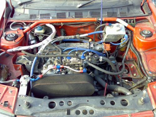

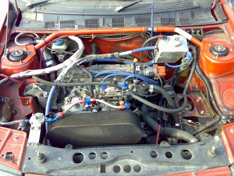

The 8 valver came out and I got on with cleaning up the engine bay. Looked like over the years the engine had been doing its own form of rust prevention! :D
De-rusted and primed all the affected areas ready to be painted.

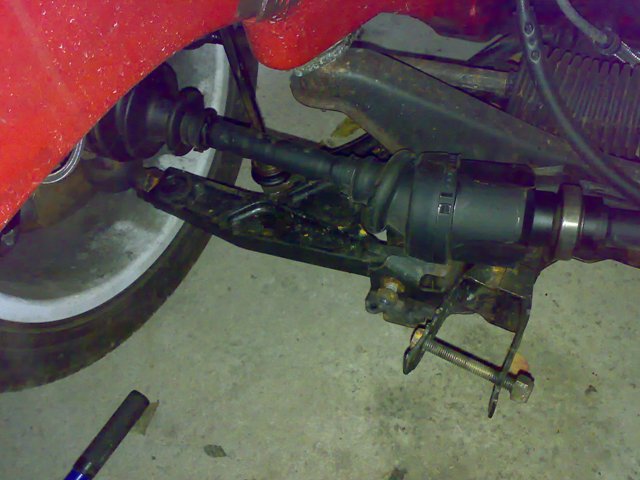

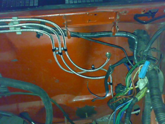

Sofar I have fitted new driveshafts, wishbones, droplinks, full set of Baker bushes, braided brake lines and 406 master cylinder.

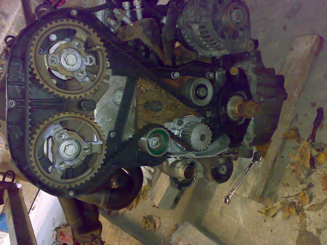

Work has been also done to the new engine, new clutch kit, cambelt and manual tensioner, and reconditioned BE3 gearbox. Also because I do not have PS I have fitted all the alternator bracketry and engine mount to allow this.

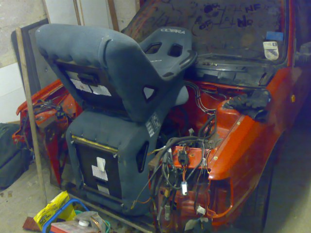

When I got the car it had already been stripped out and had a roll cage fitted etc. I didnt like the way the seats were mounted to the floor. Four pieces of angle ally bolted through the floor and then to the seats, wasnt very stable! I am half way through making some new ones which will be much better.

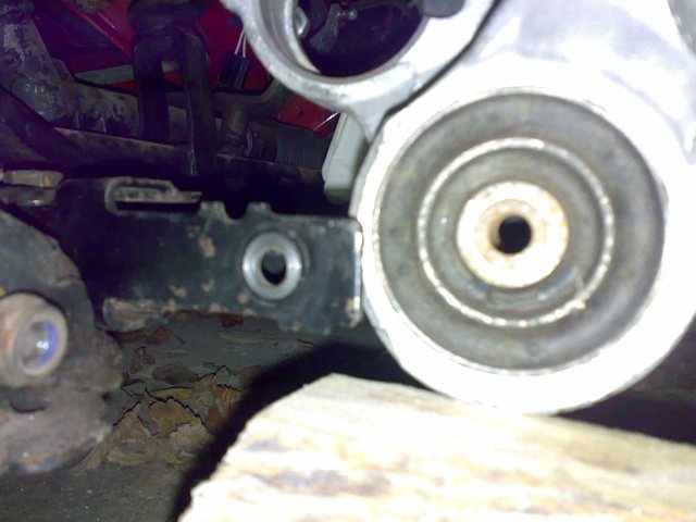

One thing that I have been thinking but have not seen mentioned is, the fork that holds the lower engine mount is mounted with a rubber bush, do people uprate these? Mine is easy to move around by hand, I was thinking if all the othe rmounts have been uprated, shouldnt this be changed too?

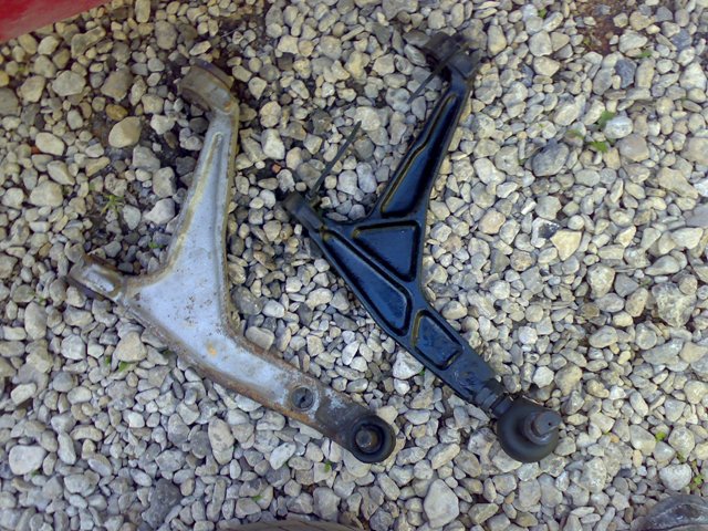

That new wishbone. Can i suggest you measure it/compare it the original 309 item to check you have the right part from your suppliers. From my experience which has been passed on by others that that new wishbone with the ribbs looks like a 205 item, where as the 309 one doesn't if you look back at the pic.
Al
Anthony
Looks like it's adjustable in length anyway as the balljoint part appears to be threaded.
Alastairh
Now that is a good point! :D
Jeez Ant, how close do you sit to your screen? :lol:
At the beginnig of this thread you mentioned you have a full set of Baker mounts - did this not include the lower engine mount? (mine did!)

He means the one at the base of the fork, where it bolts to the subframe. They are available from Peugeot apparently, although I've never changed one and my engines dont move at all on group n mounts.

they are about £8 from peugeot if memory serves

You are right the wish bones are adjustable at the hub end, and solid bushes at the subframe end.
I was talking about the bush on the fork, will have to see if I can get another one from Pug, mine seems really wobbly!

Sam, I got the bush from Pug, was £6 something! Is quite a bit stiffer than the old original, looked like it came from the factory with it!

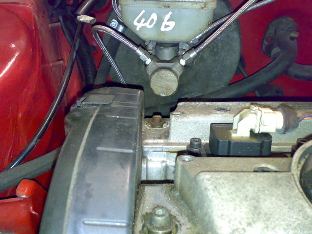

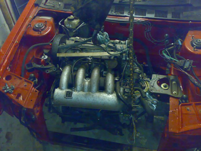

Even though I was at Autosport I managed to make some good progress on the car. The engine is in...... well almost. The Gbox mount is attached. But the other two will need work to get them to fit. I will have to grind a bit off the cam cover to make space for the master cylinder. The lower mount will have to be extended too. I havent found a measurement yet on here as to how much people have extended it, so will probably see what looks good.
The reason why it is so low down in one of the pictures is because it is not suspended by the mount, there are a load of blocks on the floor holding it up!

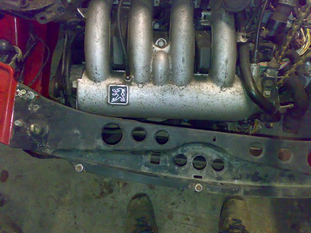

Did a trial fit of the front slam panel to see what space there was going to be, I know that 205's always have problems fitting it all in. It looks like there will be plenty of room to have the radiaor in the correct position and still have easy acess to the oil filter.

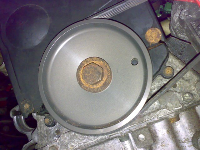

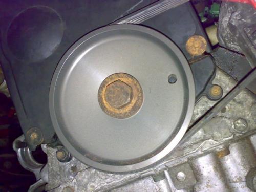

When I fitted the new cambelt etc, I also put a one piece cam pulley on to replace the two part rubber bushed Pug one. When I started the cambelt chabge the cam pullies would line up with their timing holes but the crank timing hole was out of alignment by about 5-10 degs. I assume that it has slipped a bit. Once I put the new pulley on the timing was all perfect, all the pins line up!
