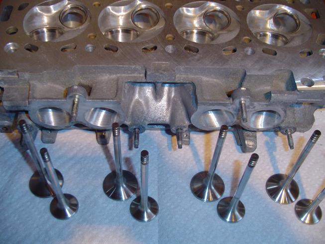

Things are starting to move forward again with this project. This morning I set about preparing the head for re-assembly. It's been worked by Mark Shillaber (SRD), the work carried out on the head is pretty minimal; as I've said before, the basic design of this head is very effective and it's easier to spoil than improve! The work he's done is aimed to complement this exact spec (use, capacity, cam, compression ratio, bore size and induction in particular, rather than producing a generic "ported head") and as such should make for a responsive and flexible engine as well as a good spread of power.

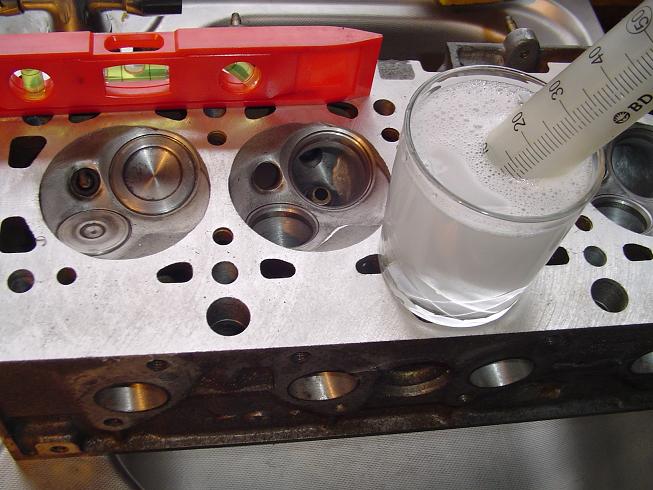

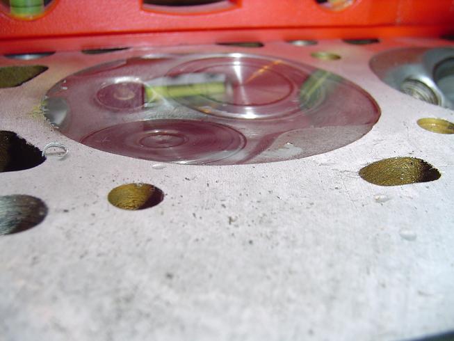

I thought it was a good time to demonstrate a layman's method of measuring the chamber volume:
Start by inserting the inlet and exhaust valve with grease or Vaseline around the seat to effect a seal, if the springs aren't fitted. Fit the spark plug. Set the head up upside down, using a spirit level on the gasket face to ensure it's very level. Mix up some water with a small amount of washing up liquid (breaks surface tension and lubricates the syringe seal).
Draw up about 50cc of the water mix into the syringe (assuming the chamber will be less than 50cc, more for bigger chambers), check the amount in the syringe (eg 50cc), make a note and slowly, carefully fill the chamber until the level of the water comes level with the head face, not higher or lower and no bulge! Check the remaining amount in the syringe (eg 17cc) and note it. The difference between the two amounts (eg 33cc) is the chamber volume.
Suck the water back out and quickly towel dry the chamber to avoid corrosion, job done!
The professional way is the use a glass plate and burette with parrafin, but unless you have that equipment, this will provide a decent guide.
To calculate the total chamber volume, you need to add the head gasket space and any piston dish that exists, if the piston has an intruder, that needs to be subtracted from the total. The static compression ratio will be (using cc as units for all):
(total chamber volume + swept volume) / total chamber volume = static compression ratio
Swept volume is ((half bore x half bore) x pi) x stroke using cm as units.
Finished with that I cleaned the head and valves ready for assembly:

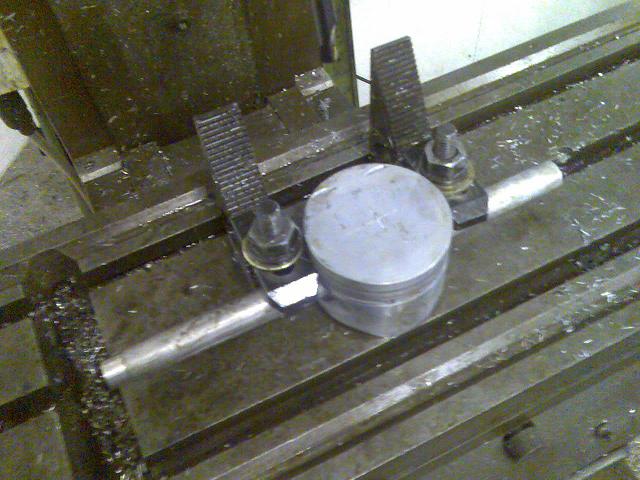

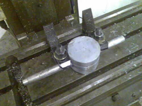

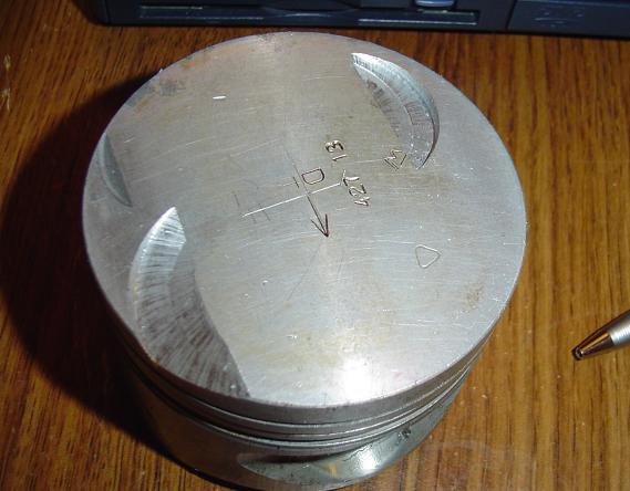

The block's been bored and decked and I've cleaned and painted it. I'm using 16v pistons to get the flat top with 78.5mm bore. To ensure there's enough room to swing the cam if I need to, I set up on Colin's mill to make cut outs.
A few tedious hours later! My machining skills aren't the best, but the accuracy is what's important and I'm alright with that (usually )
Just got to clean the pistons up now and it's dry build time.

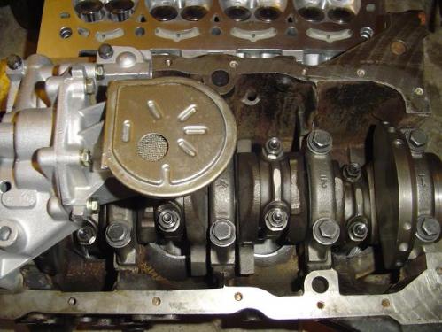

At last an update! I've been beavering away on this on the quiet.

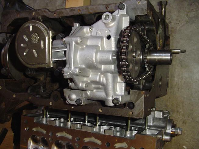

Finished the bottom end this morning, I'm particularly proud of the oil pump, it came out of a fairly low mileage engine, but had a spectacularly thick coating of oil varnish on it, regrettably I didn't take a before pick, but here it is after being cleaned and rebuilt:
I got the head off the car earlier and it would appear that the head gasket seal was quite poor, probably from overheating. The radiator seemed quite choked up, which could explain why it got hot. The parts all appear to be salvageable and hopefully the new bottom end and head will make it rather interesting!

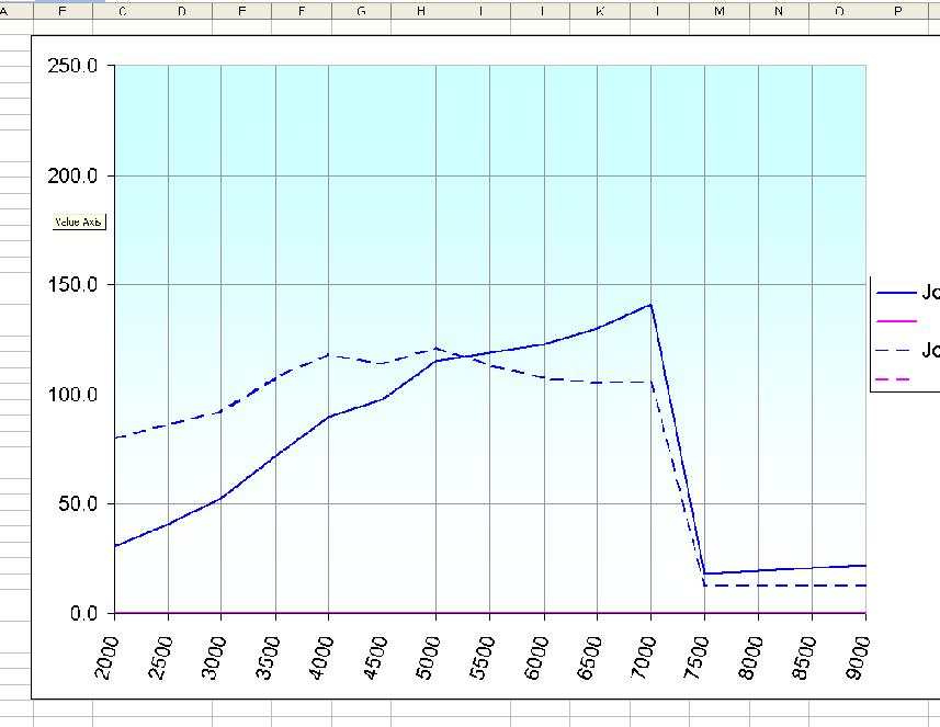

The estimated/corrected flywheel figures I calculated to be 141bhp at 7000rpm and 121lbft at 5000rpm, over 87% peak torque from 3500-7000rpm; which I'm very happy with. It drives really smoothly, much like Leo's 1.4 8v I did, the mid range is very evident, it surges forward around like a very healthy 1.9 does, feels nicely responsive and lacking inertia. The noise is great, if maybe a little muffled by the bulkhead insulation (here comes a wall.... window down sir, yes please!) and the blips of the throttle are instant and crisp, which is nice!
Here's the graph:
