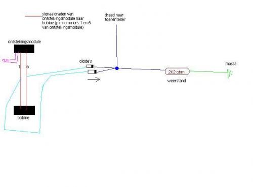

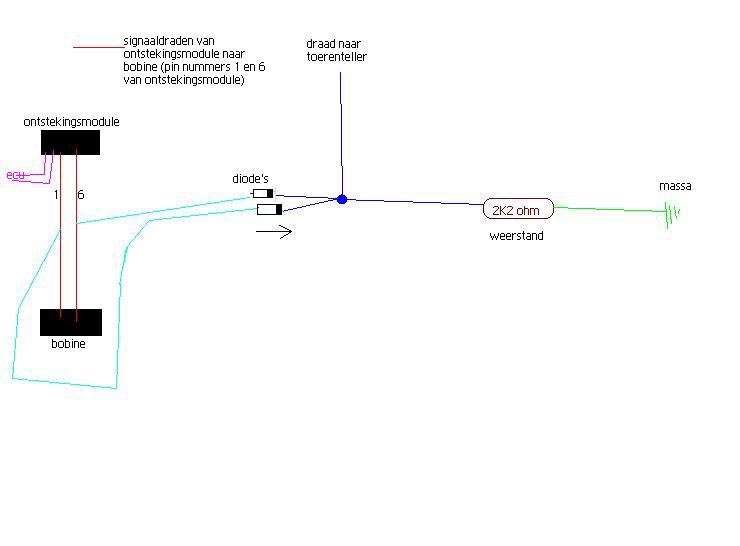

Hilgie
Wiring for the tacho (diodes mod):
Hilgie
ontstekingsmodule = ignition module
bobine = coilpack
diodes = diodes (pick 1N4008 examples)
weerstand = resistor, use a 2k2, 1 watt
massa= ground
draad naar toerenteller = wire to revcounter (112)
