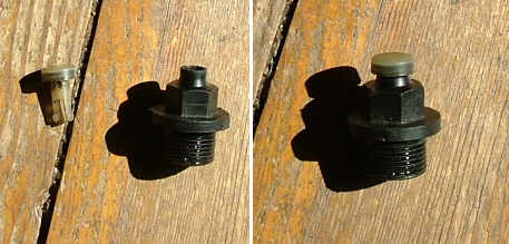

The cap on the breather is a cream/ white conical plastic item. It just clips over the top, so would be fairly easy to find something to replace it if the original is lost. Just remember the purpose of the cap is to stop dirt & water getting into the gearbox, whilst allowing air in/out. Just plugging the hole could lead to oil blowing past the driveshaft seals.

How does that work?? If the cap is ontop of the nut wouldnt the nut be stopping all air movements?
Its only a push in plastic cap & doesn't form any type of a seal in the cap so it allows the gearbox to breath through it.

That still is confusing for me because the 19mm nut that is in the side of my gearbox is solid.
Should this nut have a hole in it (like the 17mm breather ontop of the box) so the cap can fit into the hole?
No, its a very fine thread but it shouldn't be that tight.

ok the air comes through the thread, thanks Graham
