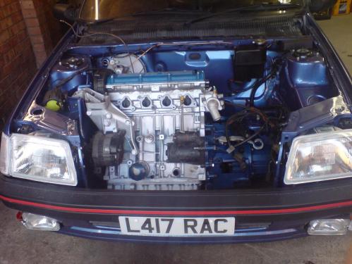

chris 417 mi
few more update pics from today :
finally ready to be refitted into the bay :)
richie van gti & tim (just out of pic ) gettin motor sorted for refittment
chris 417 mi
new clutch fitted then box mated back to engine !
and how she looks for today ! gotta get the silicon hose kit ordered now and wont be too far off finishing !!
Banjo
You didn't paint that starter or alternator up! Looking good tho! :)
Bit of advice... I'd loose the brown multiplug and just through crimp the wires so much better, and make sure the starter motor/gearbox bolts have not got paint under them or your starter/engine wont have an earth and run a good new earth to the gearbox and car made a good difference on mine.
Gd luck!

Shouldnt be any issues with gearbox earth, the box was painted before it was removed last time and everything worked.
chris 417 mi
yup was all fine before it came out ..but being french something is bound to go wrong :D
prob will paint alternator & starter at a later date when i have both hands back in use :P
Edited by chris 417 mi

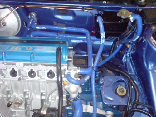

chris 417 mi
Couple more update pics from today :
New baker bushes hoses from miles in ! :blush:
And from the front :o
almost looking like a car again :D

Needless to say it was finished in time for fcs and has since been correctly mapped after the first 'mapping session' which was very disappointing :)
Drives well, pulls well and has apparently just shy of 190 bhp at the fly (the next rolling road day will give a slightly closer figure), all that needs to be sorted is the lower compression issue with pot 3. But that can wait till summer when its warmer :lol:
