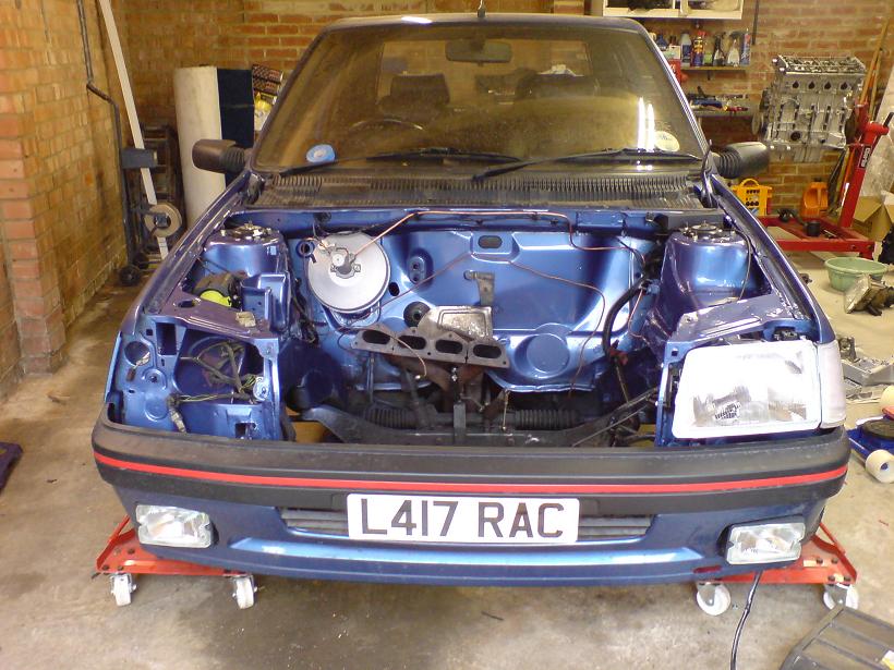

And now the front ! will be ready for painting in a day or so's time one it has all dried off etc, all the parts should start arriving next week and the car will be back next sat hopefully to begin refitting things :ph34r:
chris 417 mi
Well i got it back from the spray shop this morning and im quite pleased with the result :D
Edited by chris 417 mi
Pug_101
Looking good, keep up the great work :D

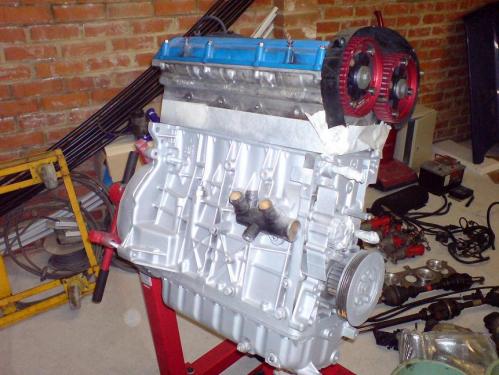

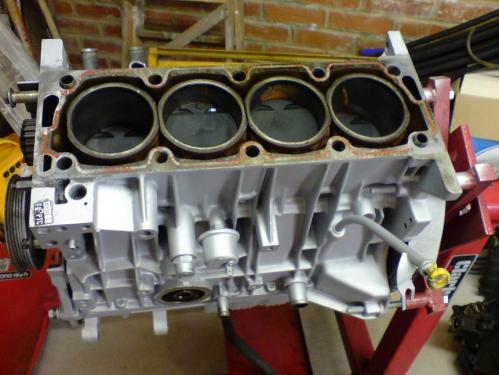

Been spraying the block with high temperature paint from halfrauds, wasnt too sure if it would look ok but it seems too :D

Few more pics, got my head back from qep ready for fitting, just awaiting head bolts now a nd the loom for the bay then can really get on with reassembling everything !
Was a bit surprised to find rust inside the bores, till i remembered id jet washed the block last week :D

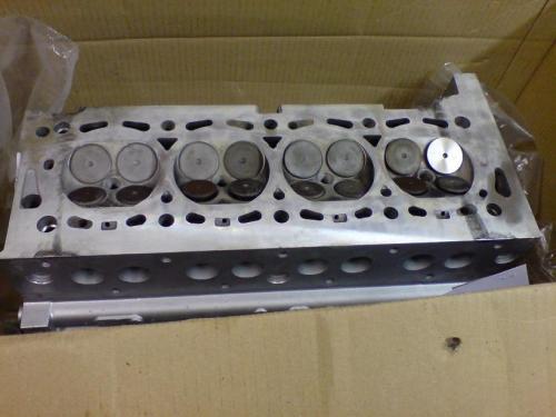

View of the old big valve head
chris 417 mi
And a sneaky one of the new head :D
mickie
looking good, i'd try and get that rust away pretty quick
chris 417 mi
i know :D , the head should be going back on soon though so ill be able to spin it over by hand a few times to clear most of it
matty_gti
Is the new one skimmed?, what was done to it while at QEP?

smckeown
isn't it worth doing at least a minir bottom rebuild as the head is off. Tidy up the bores and fit new rings at least etc ? I don't know how much your rings would appreciate having to clean up surface rust.
smckeown
also i'd clean up / remove the paint on the oil pressure senders, it wont make a good contact surface currently
chris 417 mi
New pistons & liners were fitted about 2 1/2 years ago and ive done no more than 6000 miles since, also had all the crank bearings done & crank reground at same time.
Im replacing all the sensors on the block with new, i just left the old ones in to keep the paint from getting into places it shouldnt :lol:

ChrisG
Chris - what did you clean the block with before you painted it? :lol:
Yup and yup :) fitted with cat cams inlet and exhaust cams too :lol: :
LOADS of gunk degreaser, then a good presssure wash off for about an hour and a half continually gunking it and scrubbing then spraying. Once id done that i got a wire wheel onto it !

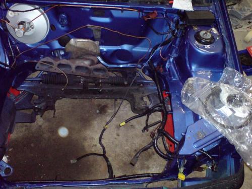

few update pics, been waiting for parts and my head to be timed up, heres what ive been up too so far :
Old wiring, doesnt look half as bad as it was :(
All old wiring removed and new spliced into loom
And one of the new head fitted to the engine block :D
More tomorrow, should have all wiring sorted and the headlights back in hopefully! ;)

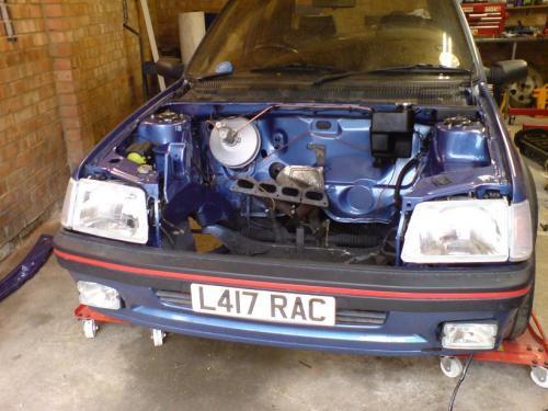

Couple more for today :
Allthe wiring for the headlights etc has now been tidied and weatherproofed inside the black plastic wiring protectors and lots of sparky tape ;)
First light back in, pics dont show how shiny these are :D
chris 417 mi
Both lights in, wont fall out now like they used to (whoever fitted them previousley had forgotten to use any of the fixing points !

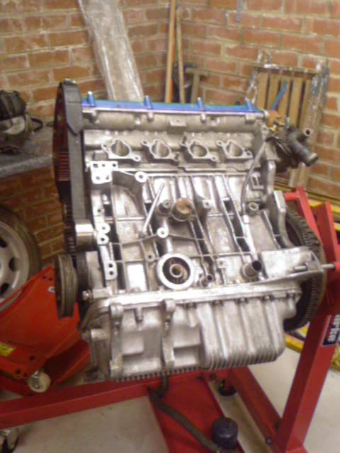

well as of sat after noon engine now looks like this :
but unfortunatley as of monday nights weekly football session i now looklike this
if anyone fancies giving me a hand it would be greatly appreciated to get this complete for fcs

Hey mate. Awesome job you doing there. Im rebuilding my Mi aswell and just got to the stage where i use loadsa gunk degreaser and solvents to clean it up and later paint it.
Just a tip to prevent the rust forming, spray a light coat of WD40 over the internals of the engine..like your liners. If your not going to work on the engine for a while, it'll keep the engine from rusting away into thin air!! :P
