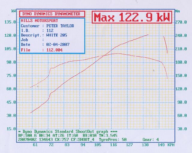

DrSarty, you're correct in trying to get a broader range. My engine has 90% of it's torque available from 4000 right through to the 7400 redline, peaking at 6000. It's a nice flat torque curve, but up where I want it.
I've finally got around to getting a copy of the power run. Sadly the printer clipped the best part! Anyway, 83 km/h = 4000 approx., 149 = 7100 approx. Note the nice fat torque curve.
